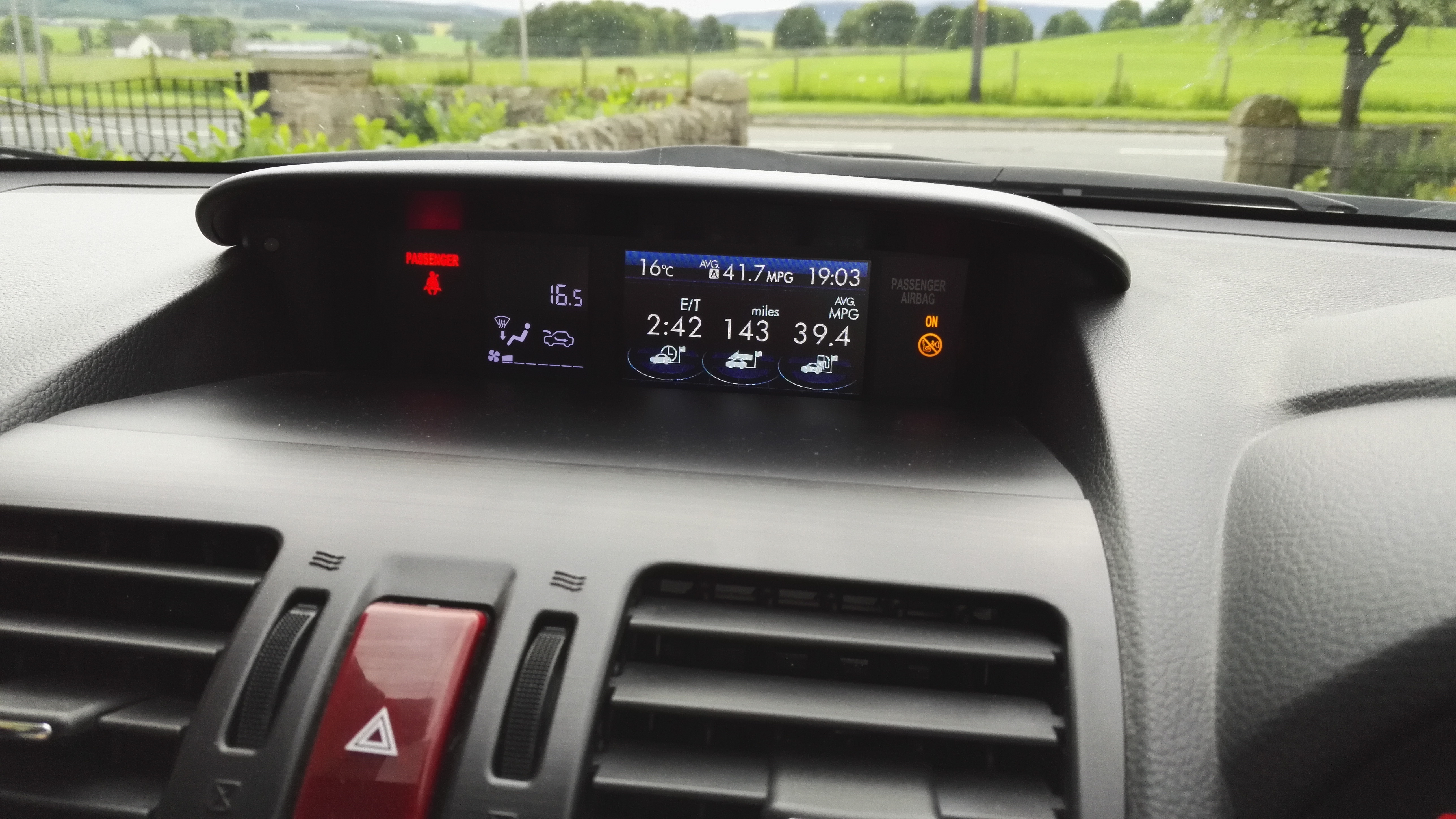

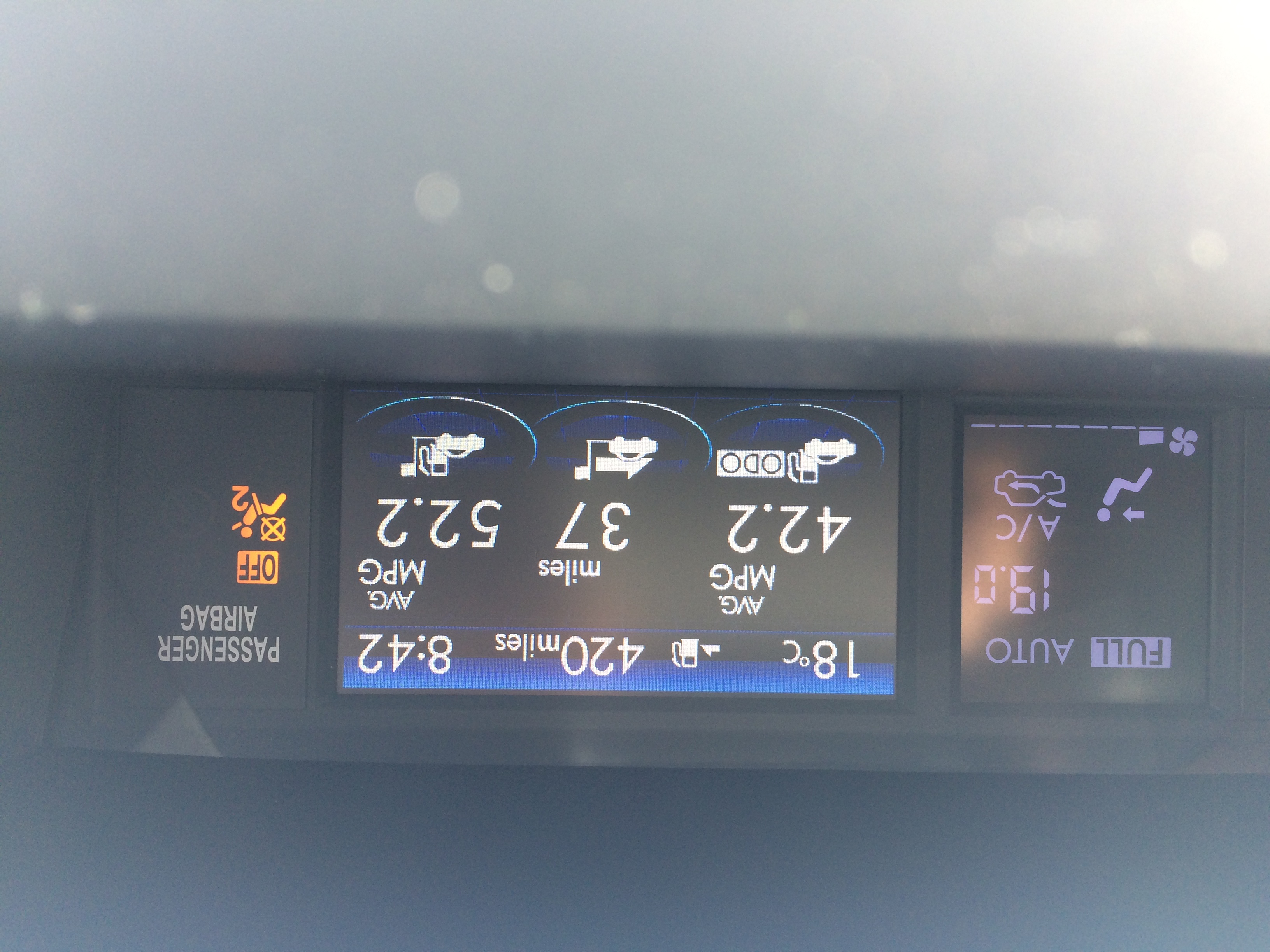

Just drove 140 miles back from Aberdeen cruise control set at 70 the whole way, I did have the bike rack on the towbar and 2 bikes, so I could have expected to loose a few mpg, but 39.4, was too low. IMG_20160724_190208.jpg

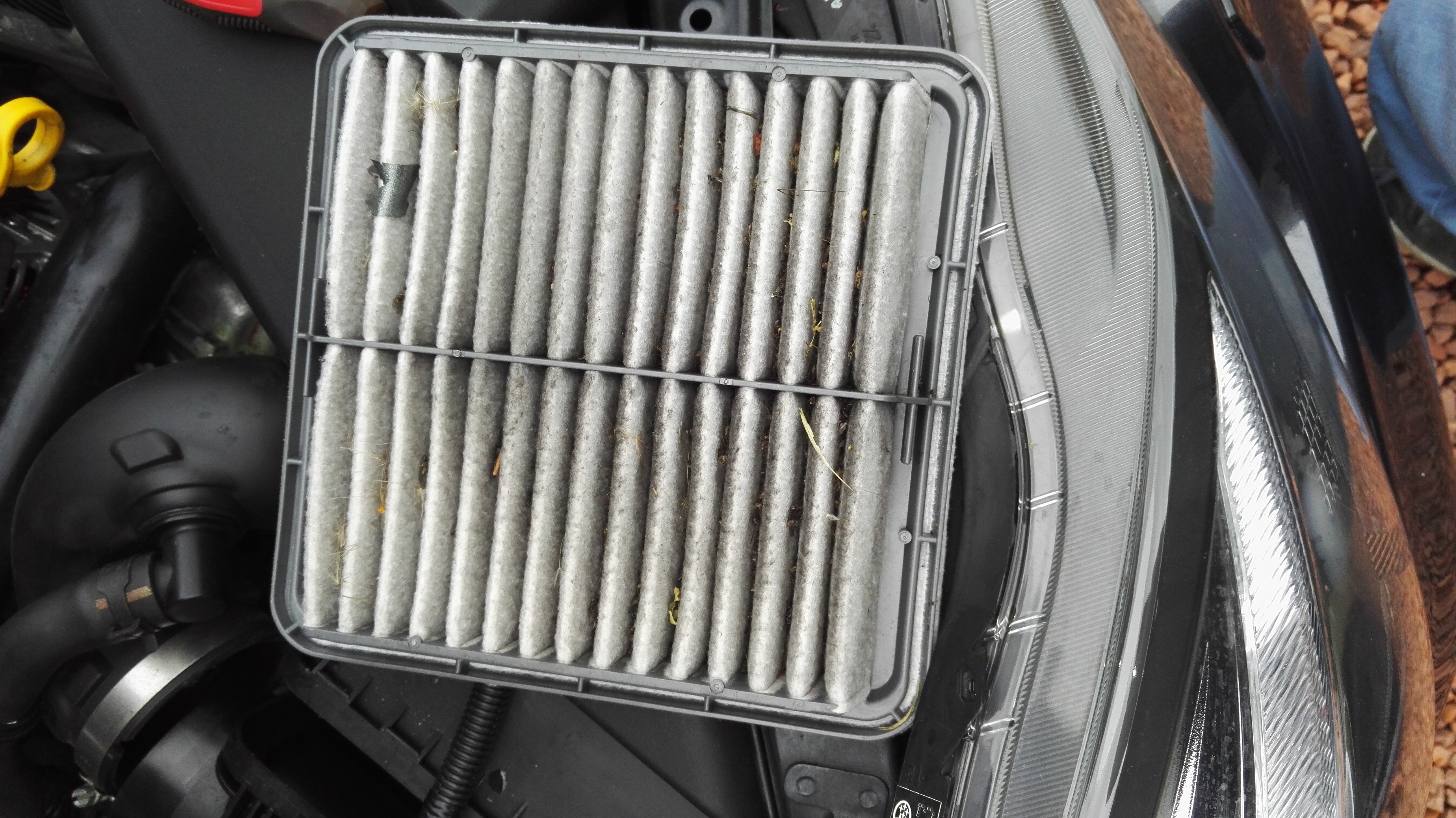

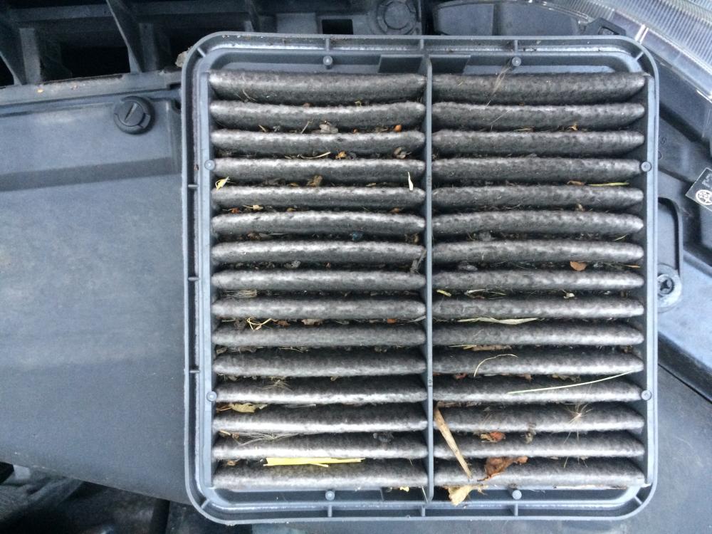

Now I'm starting to suspect something is wrong I've just had the air filter out and it looks pretty grubby...IMG_20160724_190845.jpg
Considering a "service" was done on the vehicle about 800 miles ago when I first picked it up would you have expected this to be so grubby so soon? I see the service interval at 36 months for the air filter is "inspect, correct or replace if necessary" however it should have been changed at 24 months or 24,000 miles regardless. (car is on 29,994 right now).

i haven't checked my filter myself so can't give you a reference. But it sure looks dirty. I also noticed you are driving with the air con off? That makes your mileage def not good.
I am curious whether a clean air filter would be the solution to your problem.
The filter shouldn't look like that after that amount of time unless you've been somewhere dusty.
id look st taking it to a dealers, I assume it's still under warranty so I'd take it a dealer.  I spanked mine back from Wales one day and checked the mpg even then it was still low 40s
Just a thought, is there an option to choose US gallons or UK gallons anywhere in the system setup? As this would account for the big difference 40 US mpg would be about 48UK mpg. Just a thought? Maybe I'll start putting the fuel and mileage in my mpg app I use for the Forester, then I can get a proper idea of what it's doing.
Spent an age clicking through the menu the other day and could not find a way of changing the settings, even from MPG to km/l.
I even looked at the handbook! but found nothing :(
Someone on the US crosstek owners club has asked the question but there doesnt seem to be a response from "over the Pond" either.
