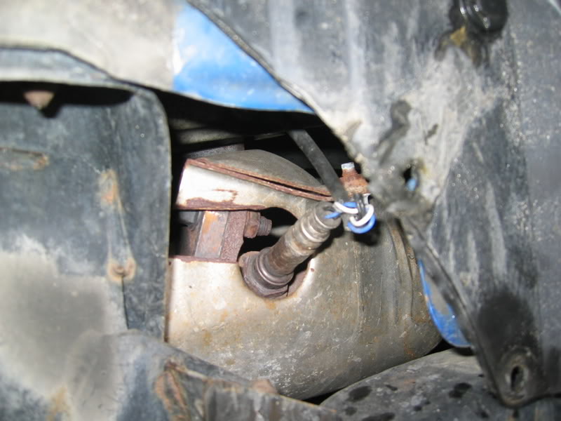

I just want to know about the lambda sensors, I know that each car must have a lambda BEFORE the CAT and then optionally after the CAT. But here I found that the owner says that he only has 1 lambda and it's after the CAT, is that possible? Or is there are separate lambda somewhere on the exhaust manifold?
Here is the picture of the up-pipe, at first I thought that it's the lambda in the picture but the owner said that it's the heating element and the only lambda is located in the downpipe. Here is the question - how come we have a lambda AFTER the cat? if there is no other lambda before the CAT - according to many sources each car must have a lambda before the CAT.
Can someone advise please and explain how it's done in your Subaru?

Lambda in the headers just before the up-pipe... EGT sensor (temperature) in the up-pipe and another lambda in the cat pipe between the downpipe and the centre pipe
Right, I thought so, that means for this cat to work I need to figure out how to move my downpipe lambda before the cat -((((((( cause I have no lambda on the exhaust manifold full stop, or I probably should look for the another bit BEFORE the up-pipe which has a lambda....
And this big hole on the left - for the Lambda I believe? Is this bit where you connect the up pipe just next to the big hole on the left?
Oh sorry, didn't realise you were talking about a Forester! I would imagine they would be the same...
If the sensor in the headers is in the same place, you will have a little access port in the wheel well on the drivers side... maybe worth having a look?
I believe it's the same for the impreza/foresters, really. I doubt there is any change, most subaru are the same to be honest as I read more and more about these cars.
Can you please confirm that your picture is showing the lambda in the same location as my picture above, right next to Up-pipe and there are bolts as well?
Can you see this sensor from under the car or do I have to take the wheel off??? I don't think I have this lambda on my car, but I will check. If I don't have it in order to install a CAT in the pipe I will have to move the original lambda which is on the downpipe to the headers like on the picture above as it must be before the CAT.

Oh and since it's a lambda where does it go under the bonnet? Can I have the picture please so at least I could check under the bonnet and try to find the cable?
Ours will have one behind the turbo and one behind the last cat, (assuming exhaust still stock)
I'm led to belive the one behind the cat doesnt do a great deal apart from tell you if its on fire/dead.
Mines not even connected and doesnt cause any issues
My exhaust is not standard! I believe i only have 1 lambda which is on the downpipe after turbo can be accessed easily from the the top.
Since I want to put the OEM up-pipe with the CAT, I will have to relocate the lambda to the ehxaust manifold BEFORE the up-pipe - at least for some time, till I'll be able to fabricate a good quality up-pipe, but that will take time and it's best to have a cat for the MOT time as well, which is very soon!
Yeh you would need to take the wheel off... there will be a smaller piece of plastic with a couple of those push in clips, it will be to the right of the suspension...
But it seems Stants has cleared it up saying there isn't one there anyway!
If the plugs are the same as the impreza, they will be on the driver side of the engine bay, next to the airbox

I looked from the top and bottom and don't see a sensor out there.
