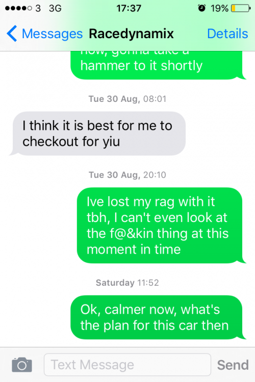

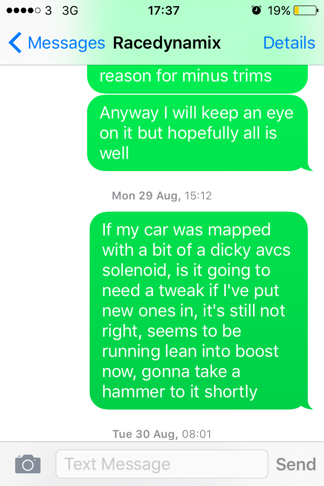

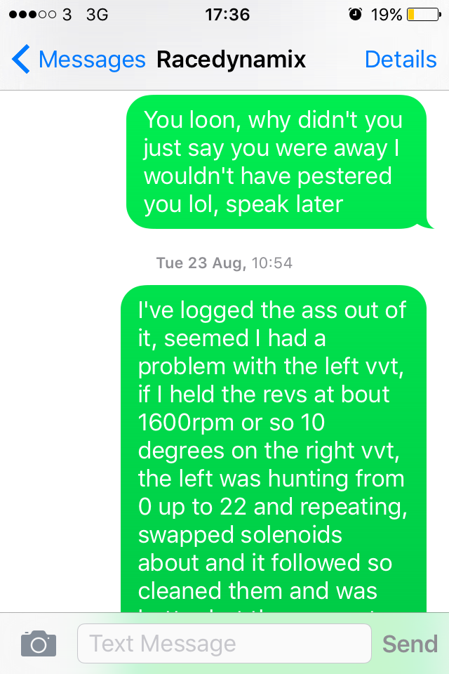

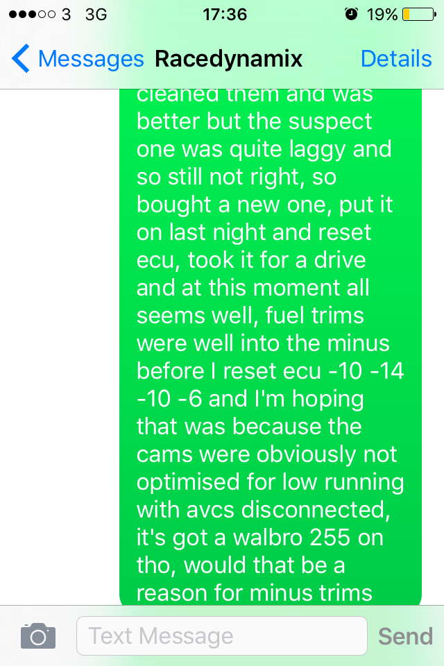

Yeah scoobs, another part of the reason I went his way, I'm a realist and I understand things go wrong, but in speaking to a couple of you guys I thought ok, if I have any issues it'll be fine, he will sort it, and I think/thought he's a really nice bloke, but he just hasn't helped at all really, and I'm stuck with a car that will not drive with the avcs connected anymore, it's just ridiculous, he even told me he used more avcs (just reread his text, he said he used more cams)in the map so as you can imagine I'm thinking just take a bit back out then so I can use the car lol
i honestly don't know if I've pis-sed him off in some way or maybe something nasty has befallen him. But I just wanna be able to use my car 🙄

He has offered some advice mate, saying it's something rattling or vibrating, then I found it all went away when I disconnected the avcs, so then he was ok I used the cams a bit more so that might explain a little, and to look at it on 22nd or week starting as he was away
That's as far as we got at the mo, maybe I'm being impatient ?
