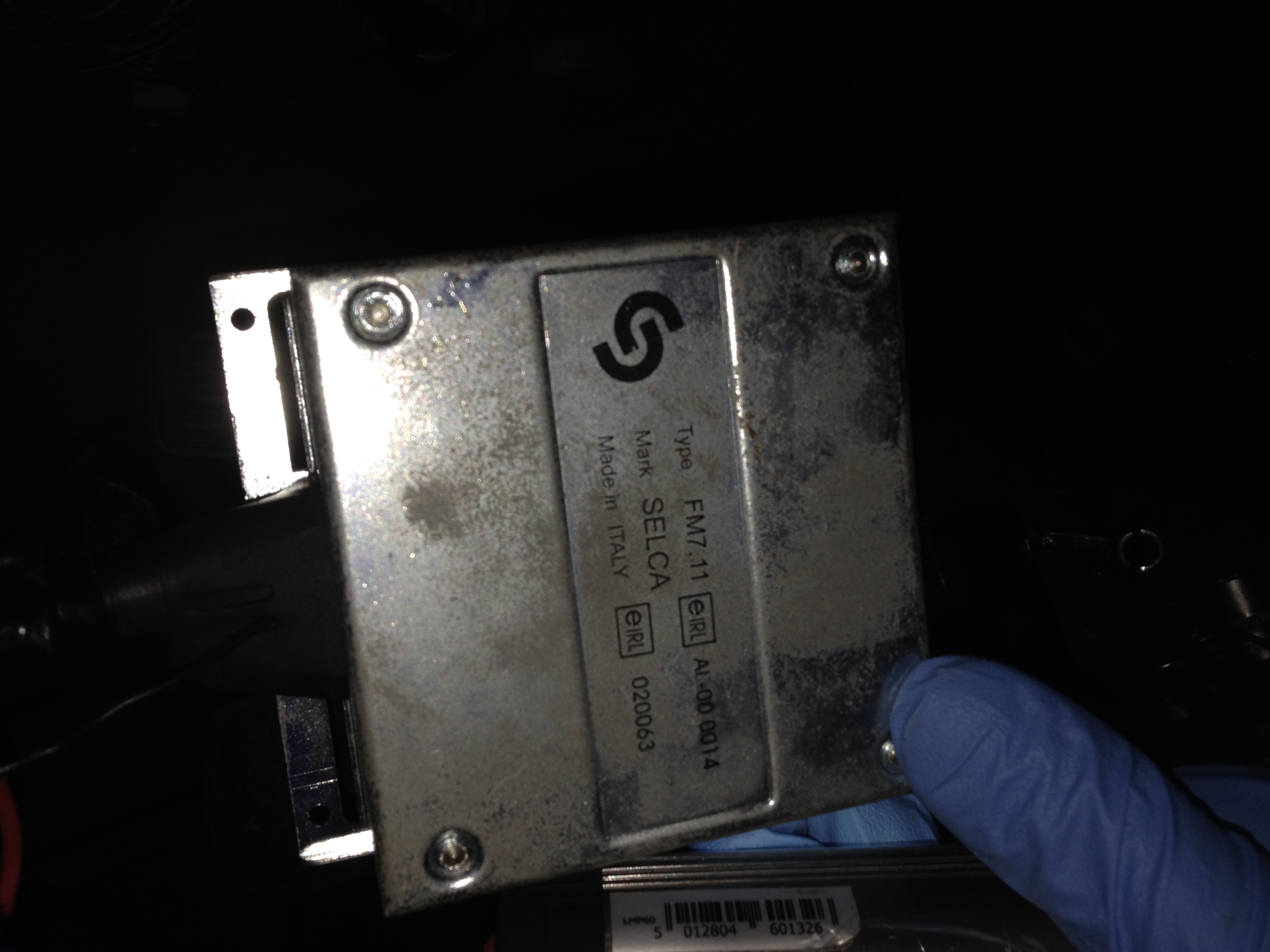

I take it being an import it's an aftermarket alarm ?
Correct think it's a selica? Or something similar
Best off getting key fob or manual and googleing the alarm will be able to get some wiring diagrams of where they've made the cuts into the loom
That's a great idea i'll look into it thanks
This is the alarm can't find any useful information about it
What does fob look like ?
Thanks for the input guys 😊 It's all fixed now couldn't be happier.
Turns out the alarm intercepts the fuel feed and the board that controls the pump in the alarm has gone bad so it was bipassed but leaving the alarm spliced in so it doesn't know what's going on. Had to cut open the loom under the carpet find where the alarm bridges the live.
