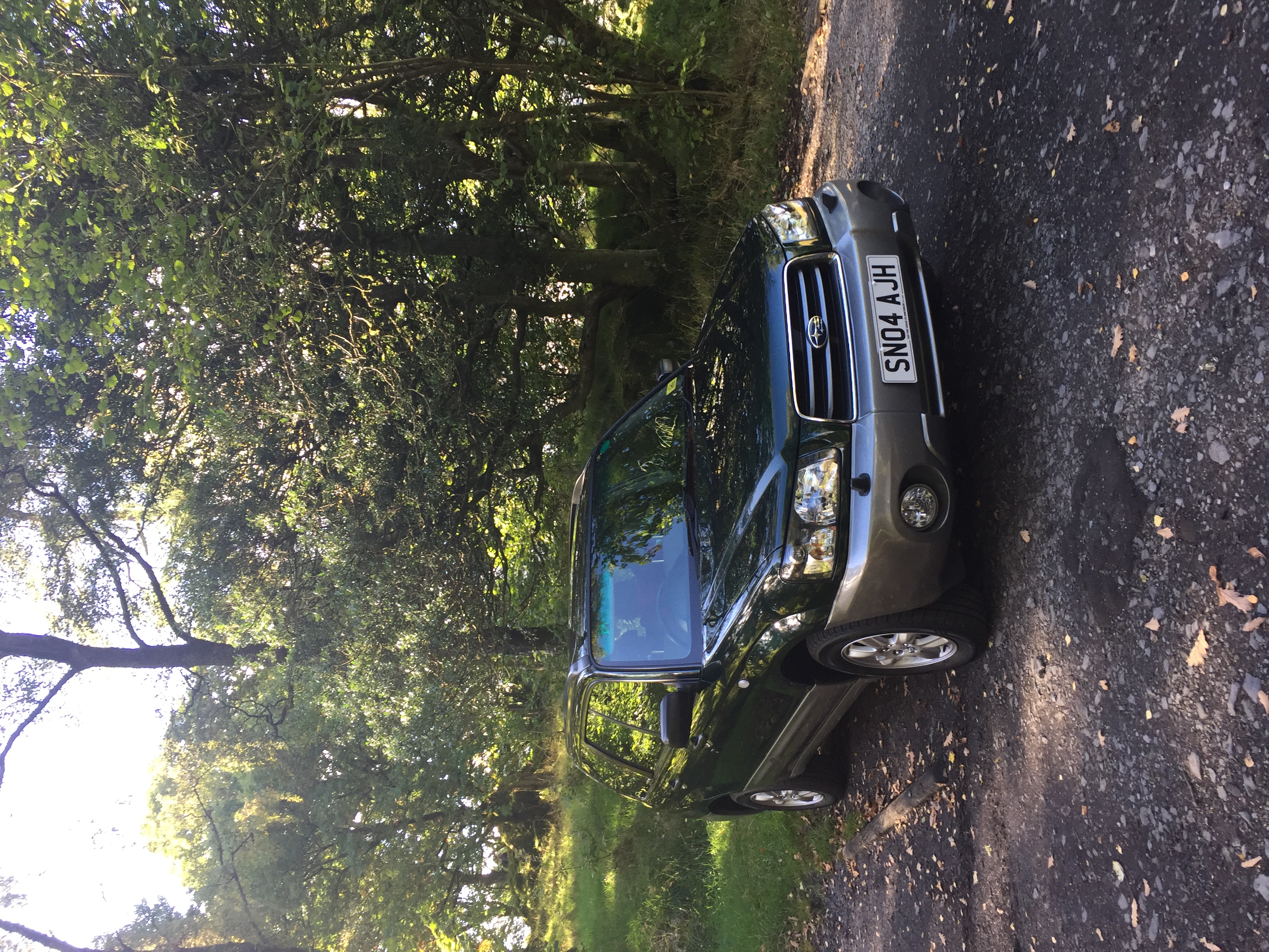

I took it up into the fells yesterday and had a walk with my little girl, loved it!
