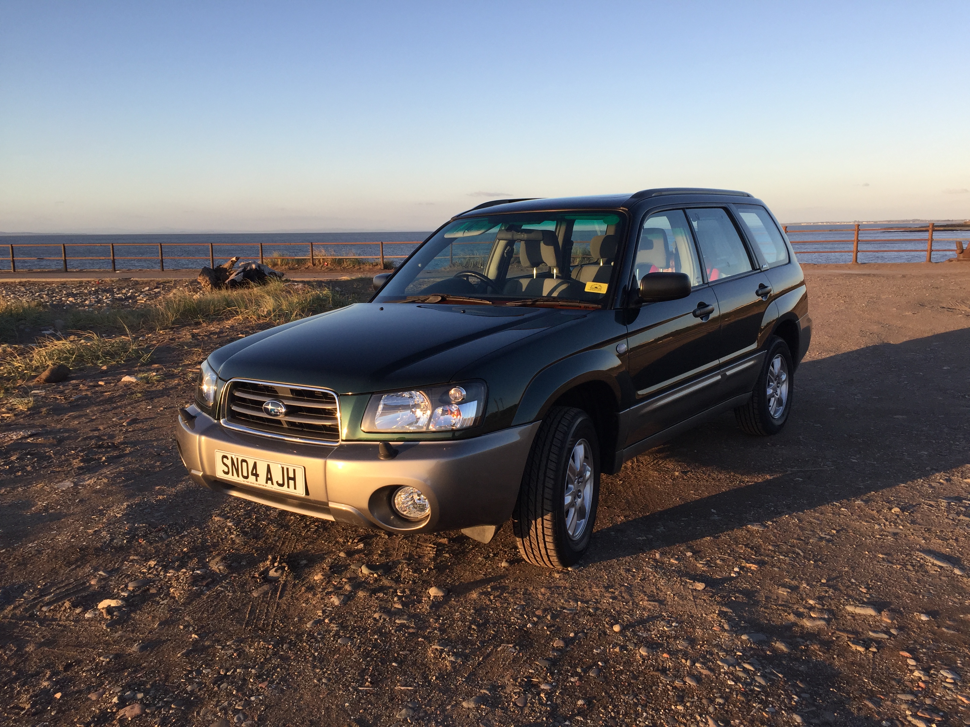

Here's a photo of the car.

was a AWP then . you haggle price  a bit ?
Green is very nice when good order but shows the slightest of marks easily .
They lot of car for money and good at almost everything really.
