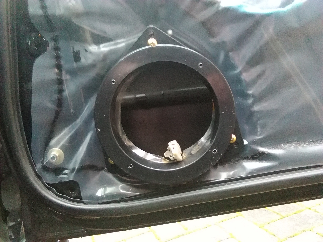

I bought a set of Edge speakers which came with brackets and wire adapters... pretty decent but need a sub since they are 3 way so bass isn't their strong point. The bracket holes don't line up properly but nothing a drill can't sort...

So from the pics you just drilled 3 new holes not far from the original holes then speakers straight into adapters...?
No window issues...?

Running a Kenwood double din unit so no amp... no issues with the windows either
Yeh just had to drill 3 holes a little closer in from the original holes in the brackets for everything to line up. Just used the old speaker holes as a template
