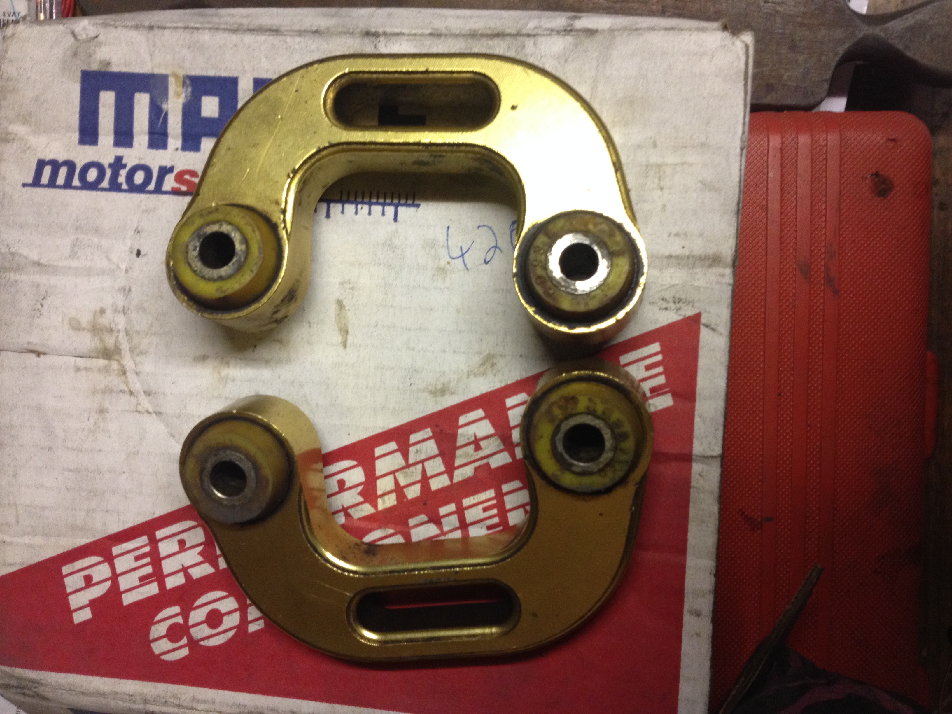

I run Whiteline "pigtail" rears but the likes of super pro ,Whiteline or cdf do solid rear "c shape" droplinks which have less give in them .
Try to get a adjustable rear arb which 3 hole settings in each end that the droplinks attach to .
As it gives you a option to adjust the roll stiffness by simply attaching the droplinks to the arb in a different position (10 mins work )
