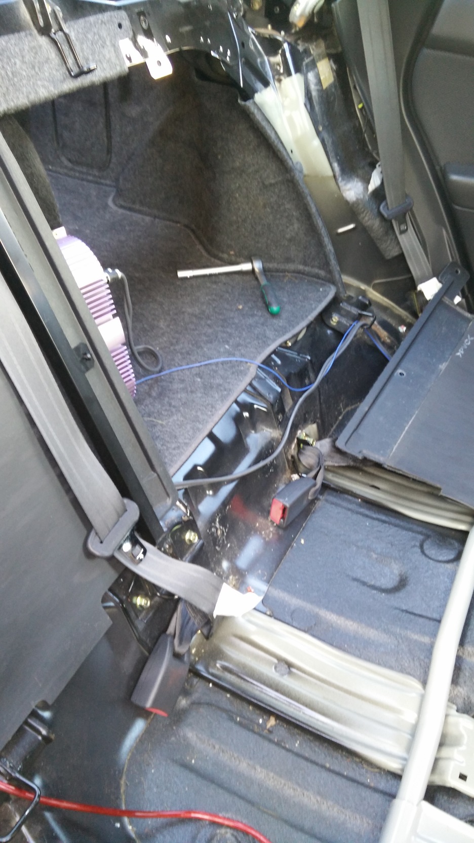

Well, that was fun! After finding nothing online about a boot release... had to take drastic measures! Back seats had to come out along with an anchor bar so I could crawl into the boot! I wasn't able to release the boot from the inside but I did manage to move that catch into the different position. Crawled back out but still couldn't use the latch and the key still wouldn't budge... I jiggled the key out of frustration then it popped open! Double checked the catch was in the correct position (I must have knocked it before) and reluctantly closed the boot, opened right up with the key and with the latch! What a ballache that was...
