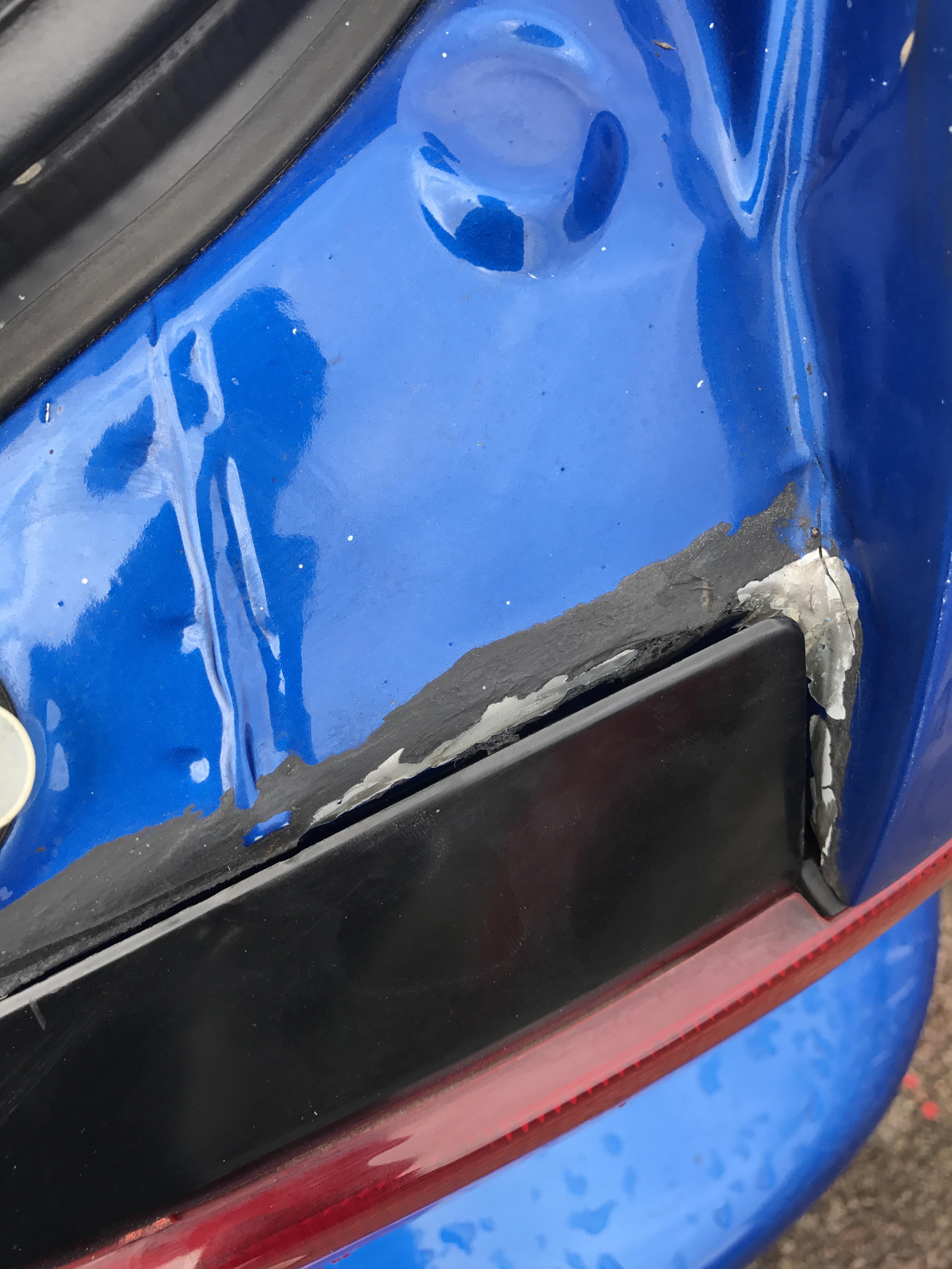

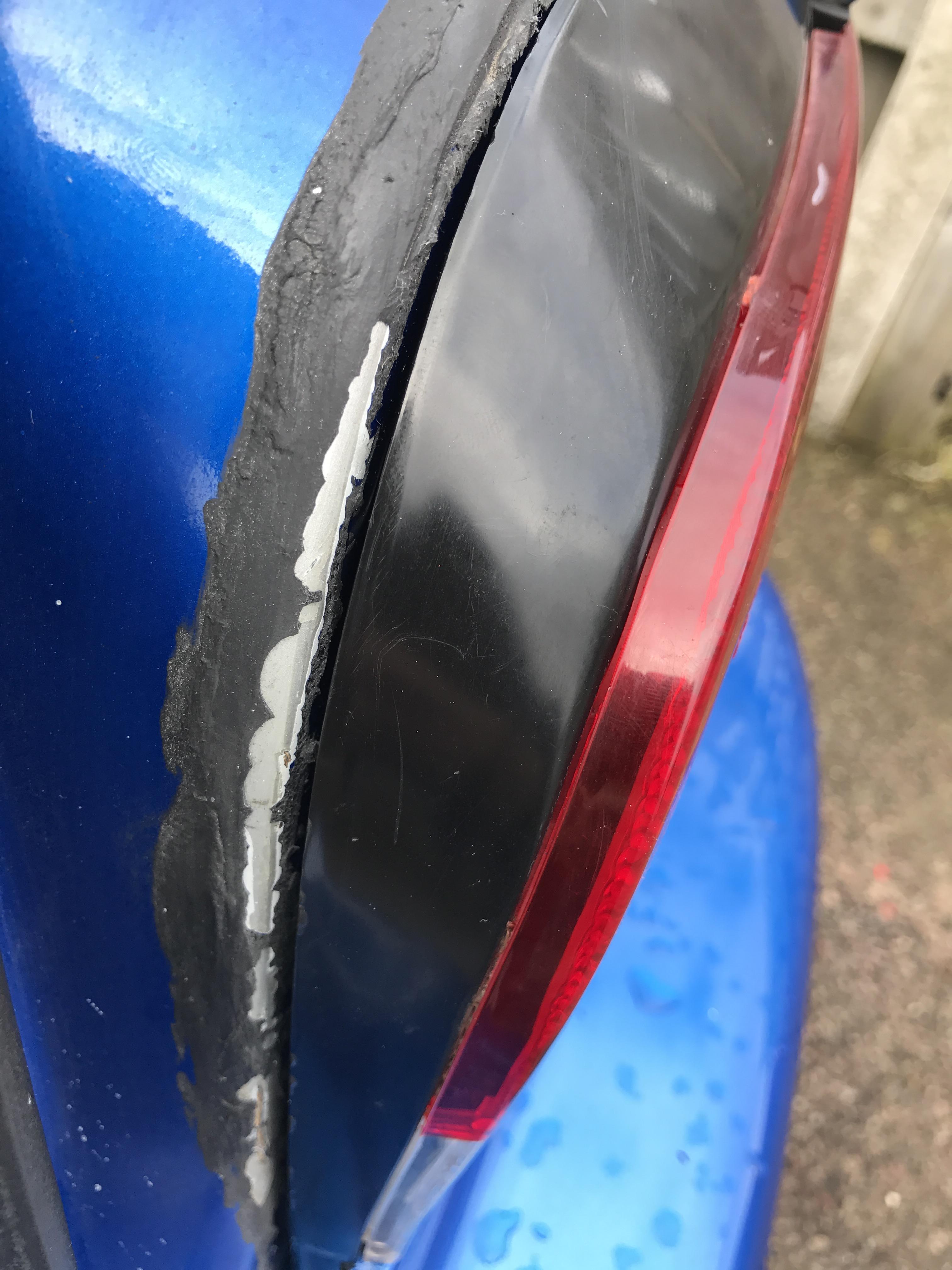

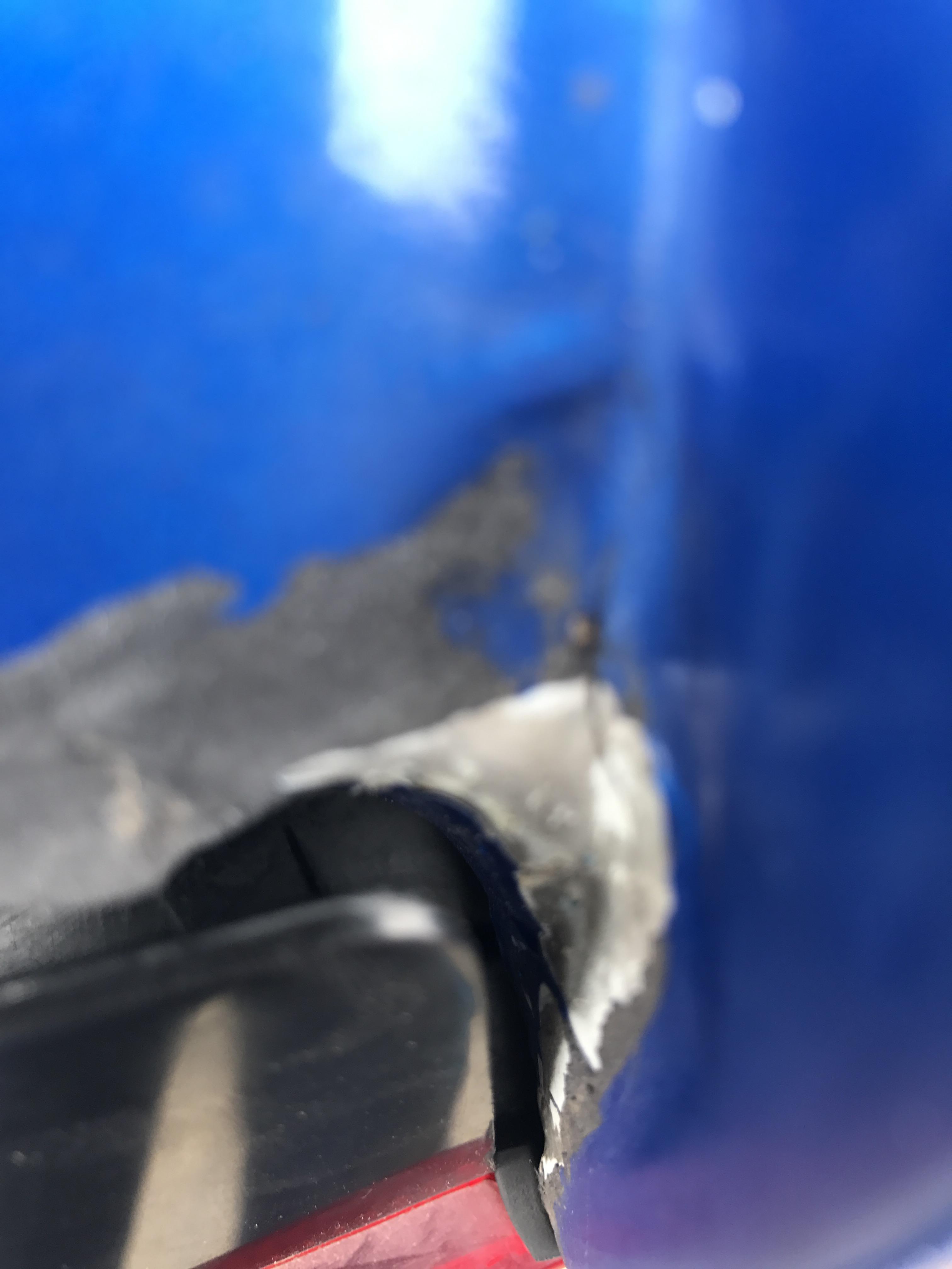

So I noticed this with my old Lexus style lights that there is a gap which allows water in so I sealed it with glue on my old lights but now I've got the new sti lights I've noticed there is still a gap , is this just a bad design? Think I should just seal these new ones again?
Rear lights on a classic are sealed with some sort of mastic from the factory.
It's weird stuff they use as it never drys and I got fooking covered in the stuff when removing the lights on my old v3 uk lol
Just had a better look at the pics , the outer black plastic always has a gap but the lights back plate is sealed into the bodywork with the sticky mastic stuff (when you fit the lights into the car )
