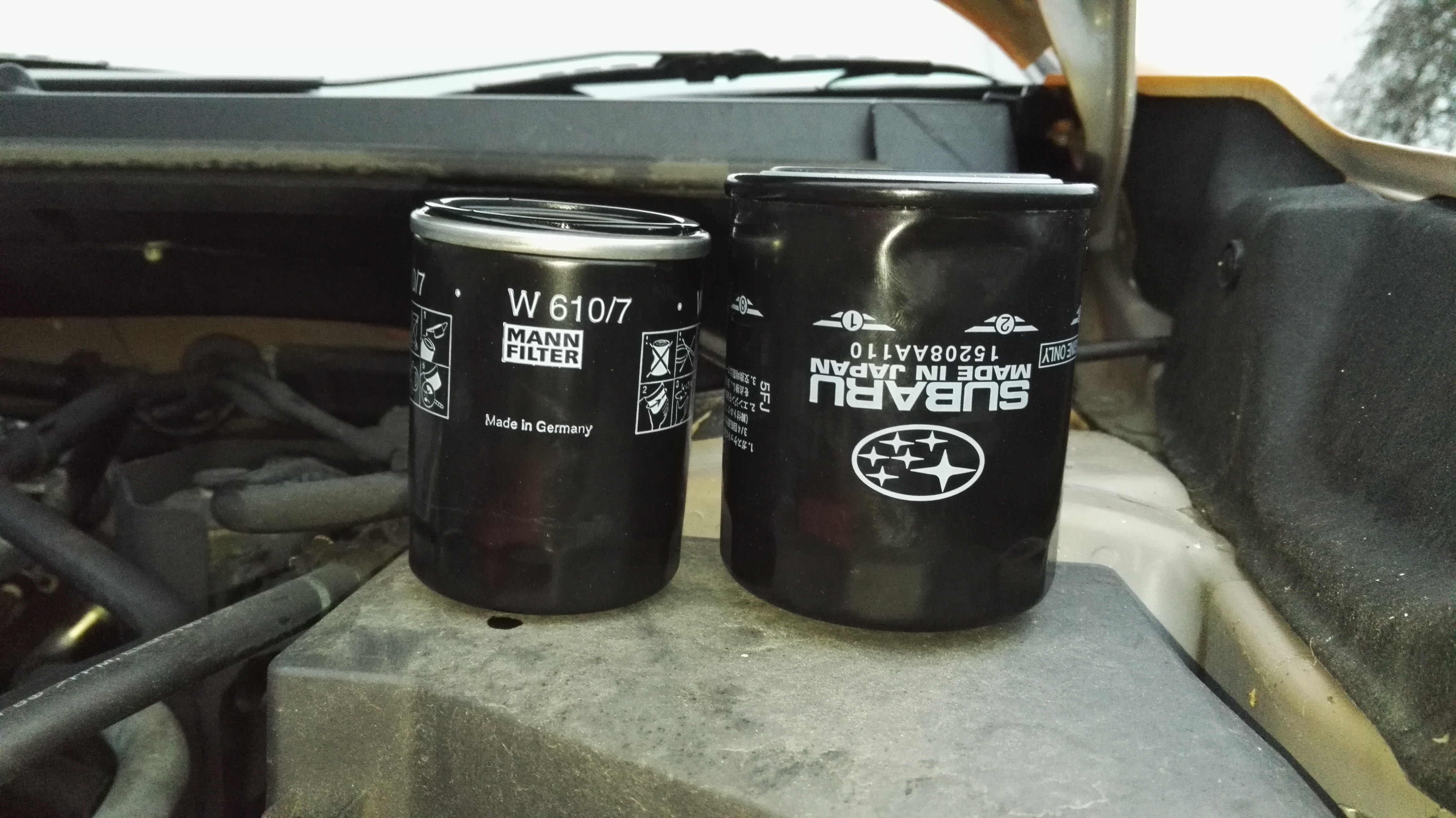

Swayze88 Posted December 22, 2017 Share Posted December 22, 2017 Changed the oil and filter today on the new orange XV as I have a slight lack of trust when it comes to salesroom services. As the car hasn't got a full history I'm going to do a double oil change with a hundred or so miles in-between. I was amazed when I pulled off the old non subaru filter to see how small it was. (I've got a non dented filter fresh from the Subaru parts department ready to go on after a few miles). Quote Link to comment Share on other sites More sharing options...
Aberdeen Chris Posted December 22, 2017 Share Posted December 22, 2017 There's quite a difference between the two! The Mann filter looks like it may have come from Dingbro, that's where garages here get all their parts from. Like the grill btw Quote Link to comment Share on other sites More sharing options...
Mr B Posted December 22, 2017 Share Posted December 22, 2017 for jap cars either blueprint or oem , stay away from euro parts ... Quote Link to comment Share on other sites More sharing options...
Aberdeen Chris Posted December 23, 2017 Share Posted December 23, 2017 I agree. I usually get from eBay or the main dealer who let's me take empty oil containers and fills them with Havoline oil cheaper than I can buy it elsewhere. Plus I get a receipt to prove I used the correct oil for warranty purposes. Quote Link to comment Share on other sites More sharing options...
Swayze88 Posted December 23, 2017 Share Posted December 23, 2017 12 hours ago, Aberdeen Chris said: There's quite a difference between the two! The Mann filter looks like it may have come from Dingbro, that's where garages here get all their parts from. Like the grill btw 12 hours ago, Mr B said: for jap cars either blueprint or oem , stay away from euro parts ... Cheers Chris, I think it looks much better with the black grill. Yeah I think the Mann filters are ECP or Dingbro, but I'll definitely be trying to stick with OEM after seeing the size difference, as Mr B says OEM or Blueprint I think. Fresh Filter and sump washer cost me £23.81 from the parts department, so I'll fire that on in a few days with some new oil and take the dented one out, then she should be like new. Quote Link to comment Share on other sites More sharing options...
XVGUS Posted February 4, 2018 Author Share Posted February 4, 2018 Right lads,its been a while since I was last on here but the link for putting the oil light after oil change is spot on.....thanks. I was also told buy a Subaru mechanic to use 5w30 oil c3 grade as this is compatable with the dpf and doesn't mess with the warranty. I work for dingbro and dont not use mann on my Subaru,i use the ADL Blueprint (size wise exactly the same as Subaru filter) a much better filter all round. My Last oil change was less than £30 but I get everything for my own car at cost.......Tomorrow however she's booked into AF Noble for a service (to keep up warranty) so I shall expect a nice wee bill,even though ive just replaced front and rear pads and had the H/brake adjusted etc lol. So anyone looking to change there own oil,If you have a low milage car 0w30 would be fine but a car with say 30k plus then 5w30 is recommended and follow the links regarding resetting the the oil dilution. Quote Link to comment Share on other sites More sharing options...
Swayze88 Posted February 5, 2018 Share Posted February 5, 2018 20 hours ago, XVGUS said: Right lads,its been a while since I was last on here but the link for putting the oil light after oil change is spot on.....thanks. I was also told buy a Subaru mechanic to use 5w30 oil c3 grade as this is compatable with the dpf and doesn't mess with the warranty. I work for dingbro and dont not use mann on my Subaru,i use the ADL Blueprint (size wise exactly the same as Subaru filter) a much better filter all round. My Last oil change was less than £30 but I get everything for my own car at cost.......Tomorrow however she's booked into AF Noble for a service (to keep up warranty) so I shall expect a nice wee bill,even though ive just replaced front and rear pads and had the H/brake adjusted etc lol. So anyone looking to change there own oil,If you have a low milage car 0w30 would be fine but a car with say 30k plus then 5w30 is recommended and follow the links regarding resetting the the oil dilution. Good luck with AF Noble, make sure and check they have tightened everything back up! Unfortunately us East coasters don't have much other choice to keep the service book happy. Quote Link to comment Share on other sites More sharing options...
