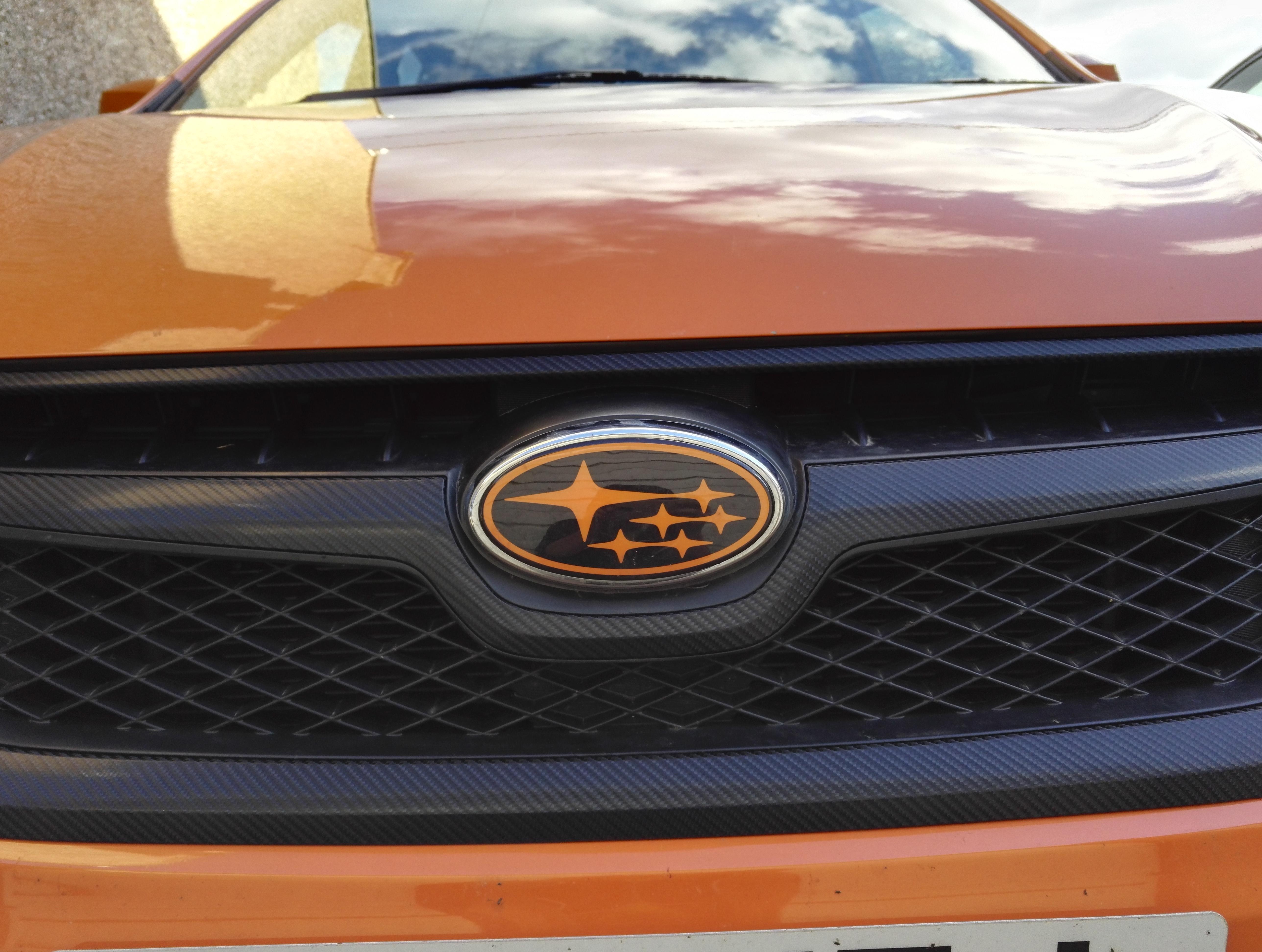

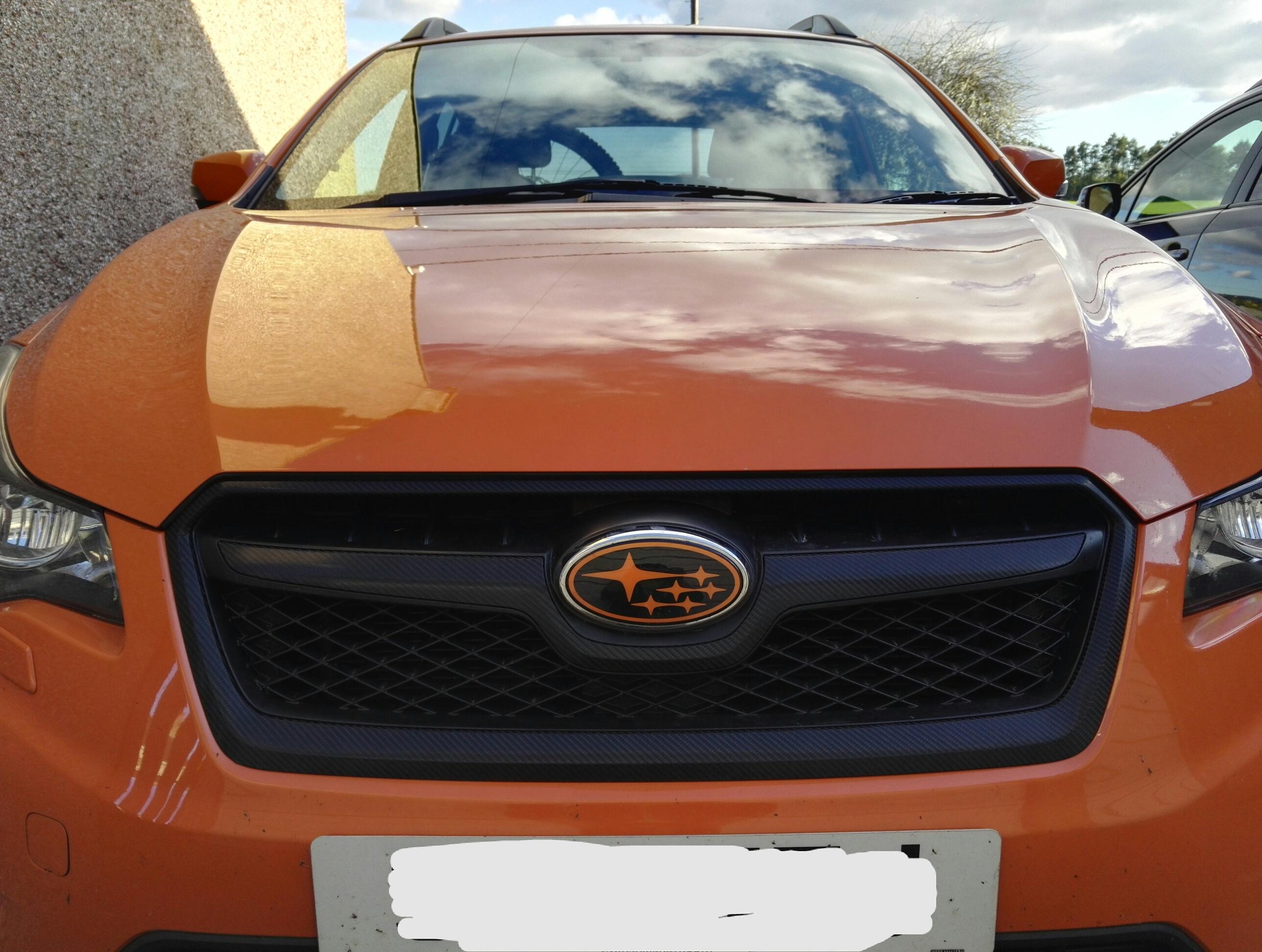

I Don't like fake Carbon , but I like chrome even less.
I decided to give wrapping the grill a go. It wasn't the easiest, as the grille bends and twists in every direction just to keep you on your toes.
I think it looks pretty good, hopefully it lasts a bit longer than the plastidip did. (Halfords own brand). One day maybe when I'm feeling flush i'll get a black sports grille from America/Japan and be done with all the painting/wrapping!
The tiger claw scratches are the reflection of a fence, don't worry!
IMG_20180513_185804.thumb.jpg.1e85c0bcf339beefd442d5b93f85e487.jpgIMG_20180514_123705.thumb.jpg.25cc1cfaf3f22105f0432a0d37f1de1b.jpg
I think the fake carbon looks pretty good to me, my car has this look to some extent already, thanks.
