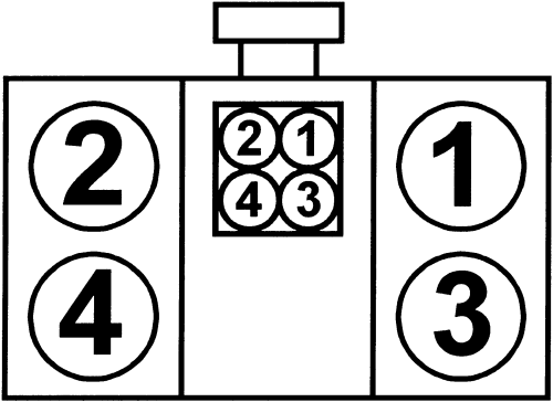

Yes they are, to change them you need to take out the airbox on the drivers side and the Battery and washer bottle on the passenger side. Not a hard job just a bit fiddly and time consuming. Don't swap the coils over as all you will do is make the firing order wrong and the engine will run terribly

Drivers side--------------passengers side
-------------front of car------------------
-------#2-----------------------#1-------
-------#4-----------------------#3-------
Firing order is 1-3-2-4 ej20
