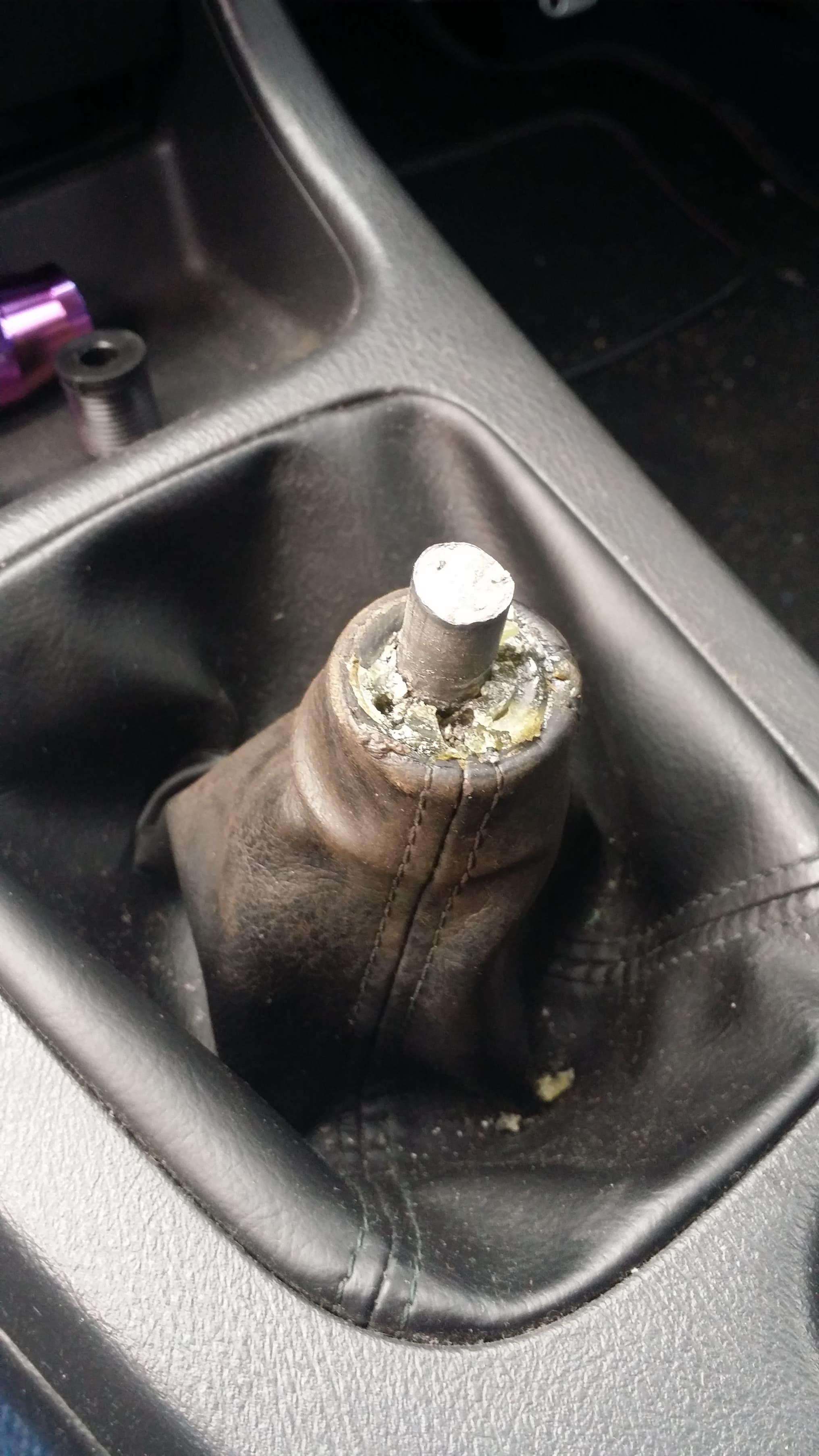

so just went to change my gear knob and found this, looks like the end has snapped off and they've glued it back on, the end bit is glued into the gearknob, do i need a new gear stick
Looks like that "old school" short shift mod
Cut a lump of the top
Loud pipes save lives
Handy with a die kit ? Could always just cut a new thread & buy a new gearknob
