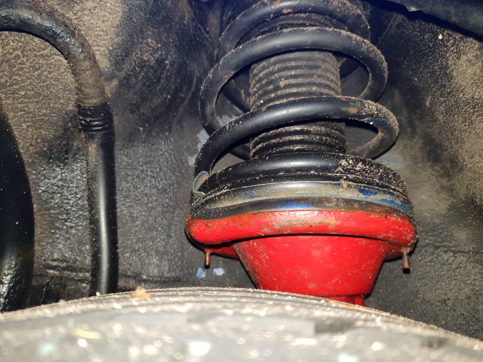

So Im on the hunt for any tips/ advice you guys have from changes you may have made to your scoobies handling. Are the Sti struts Red? The ones on the car a red and my last wrx had black struts pic below. First thing on the cards after mot time is a set of decent tyres cause I have what looks like budget numbers on the car from last owner so im sure that is best place to start. I dont really mind the cars nature of understeer bias but id like it a little sharper without being too stiff.anyone know how great the difference is after front strut brace is fitted? Id like a little less body roll but again not too stiff its not gonna be a track car. I dont want coilovers cant go too stiff cause the roads are shocking and I like having teeth 😂

Not sure if the sti strutts are red ,you might have pedders replacements but either way you're probably better off finding out what shocks you have and matching springs to suit their dampening rates .
