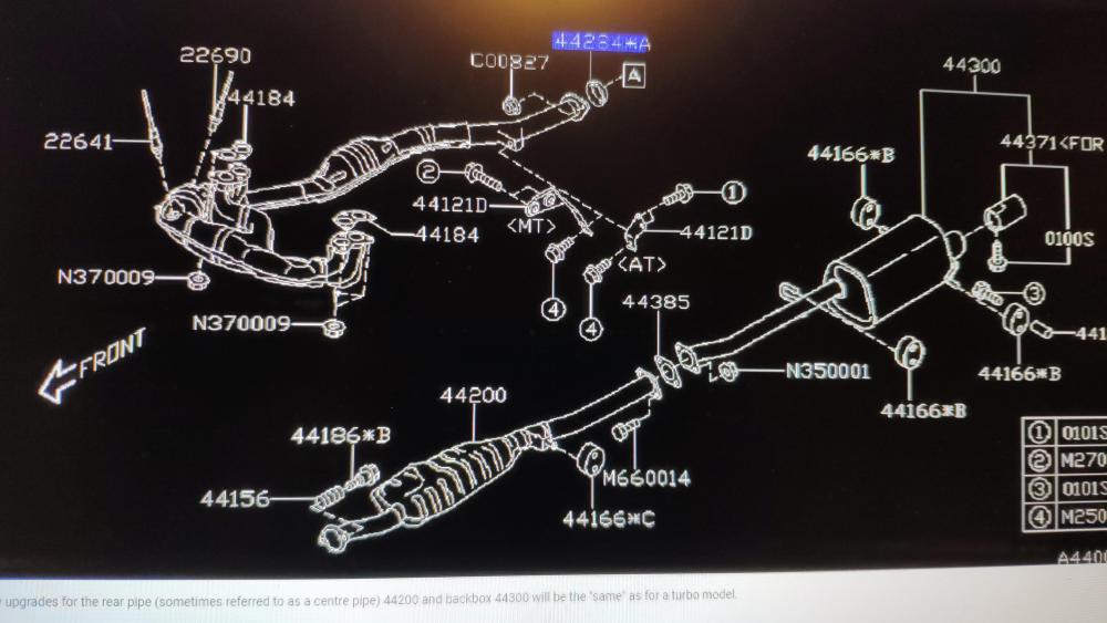

If you take some diameter measurements I can check for a match
The diameter of the cat end is 2" and the other end is also 2" or at most 2.5" . The exhaust is back on the car now. It is number 44200 on this diagram.
Is that for a hatchback? Or the Impreza Estate?
