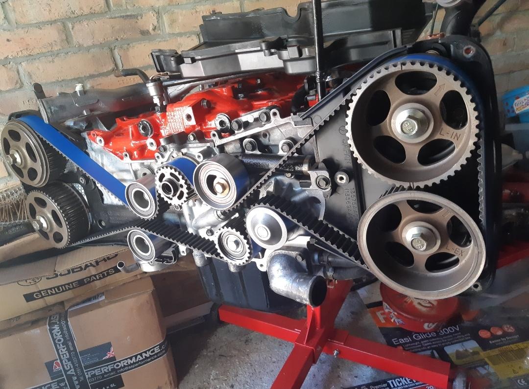

Here's a pic of the front of the engine for reference

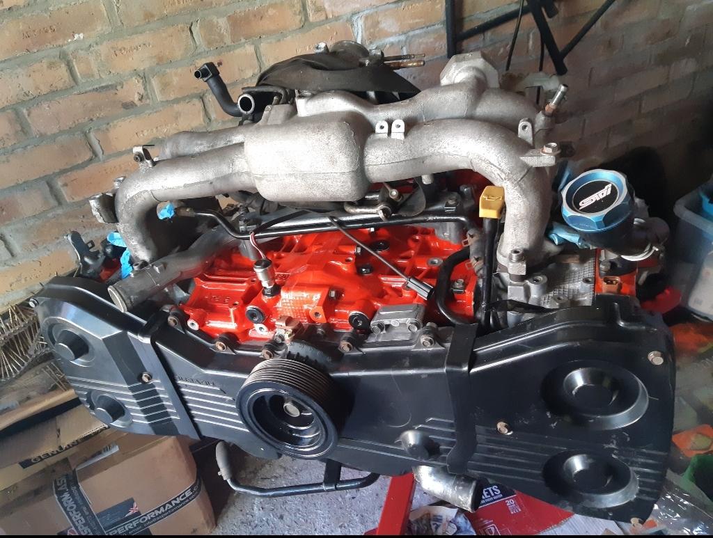

And with the cover on , thermostat is accessible
Waterpump is driven by the timing belt unfortunately
