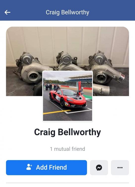

whos mapping it?
really bad as engine will lean out, but decent mapper will see it and stop the run. At that point its a choice between getting what you can and backing off the map, or swappng parts
Posted
oh not good then
I can’t think of the name but im paying around £450

uh, you dont know whos mapping it? is it on a dyno?

Its Being mapped on a rolling road and I think it’s going on the dyno.

depends if its a garage or just a dyno place with a mobile mapper.
