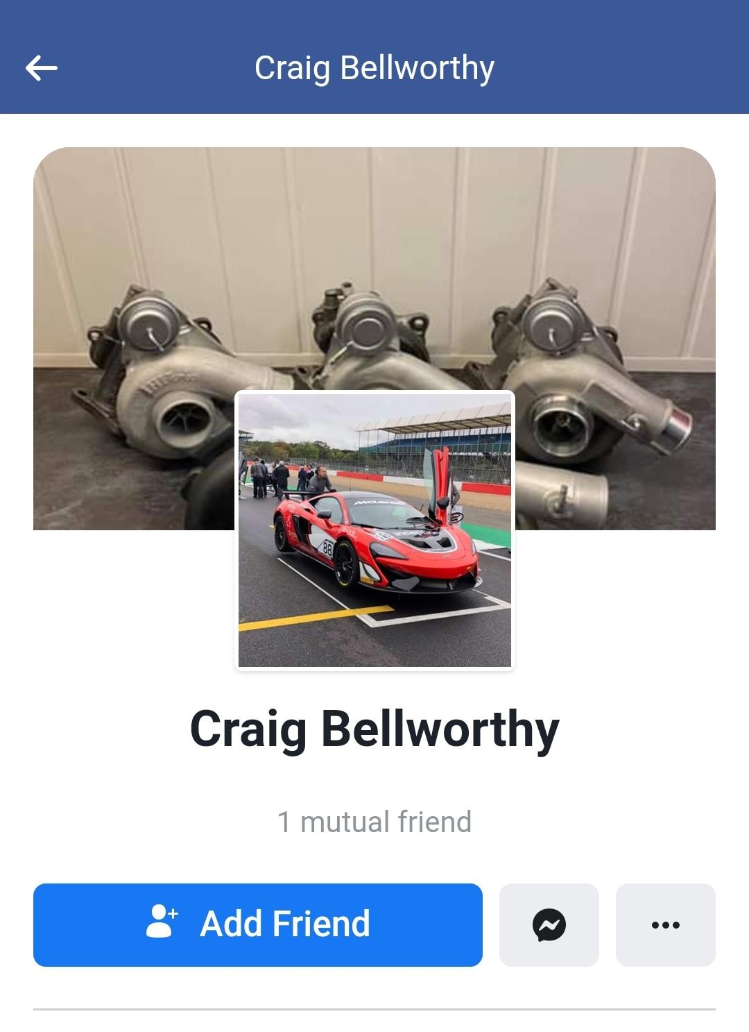

Sorry bud , &#33;Removed&#33; autocorrect , Craig bellworthy on f.b , builds hybrid tdo4's and other stock Subaru turbos .
Heres a screenshot of his profile page , pop him a message 👍
Aa far as turbos generally go ,if it's under £700 brand new it's a gamble that it will work and a possibility ,that if it does fail it will take your engine with it (especially if its running a tmic )
I don't know craig that well tbh and have only spoken to him a few times but I know a few people that have bought either reconditioned subaru , hybrid or upgraded turbos from him .
