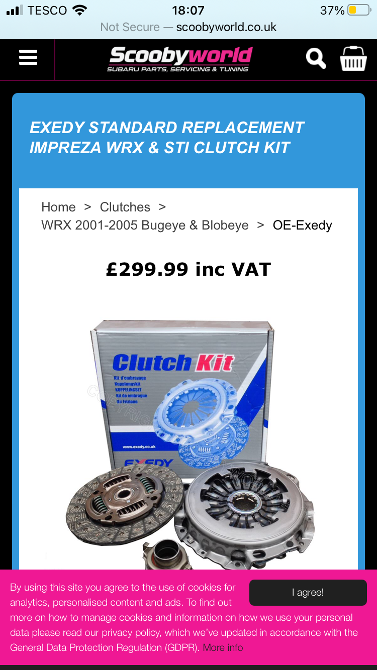

ROSSCOSM Posted November 7, 2020 Share Posted November 7, 2020 Hey man ive had a search for you if you go to the website in the pic you will see they say you either need your flywheel skimmed or replaced at the same time. You would need to obviously factor in labour aswell possibly talking about £800+. Bear in mind there are other options out there this pic is just an example could try import car parts or other scooby parts specialists too 1 Quote Link to comment Share on other sites More sharing options...

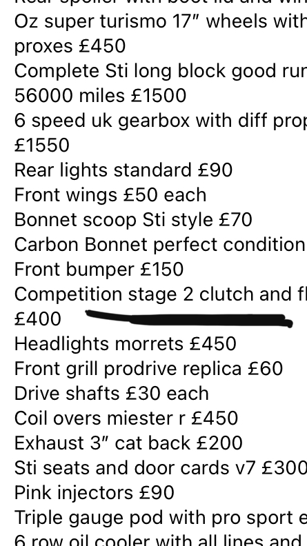

ROSSCOSM Posted November 7, 2020 Share Posted November 7, 2020 Also seen this on jdm solutions might be away now but says brand new and comes with flywheel. Stage 2 though bit if you plan to mod might be an option 1 Quote Link to comment Share on other sites More sharing options...
