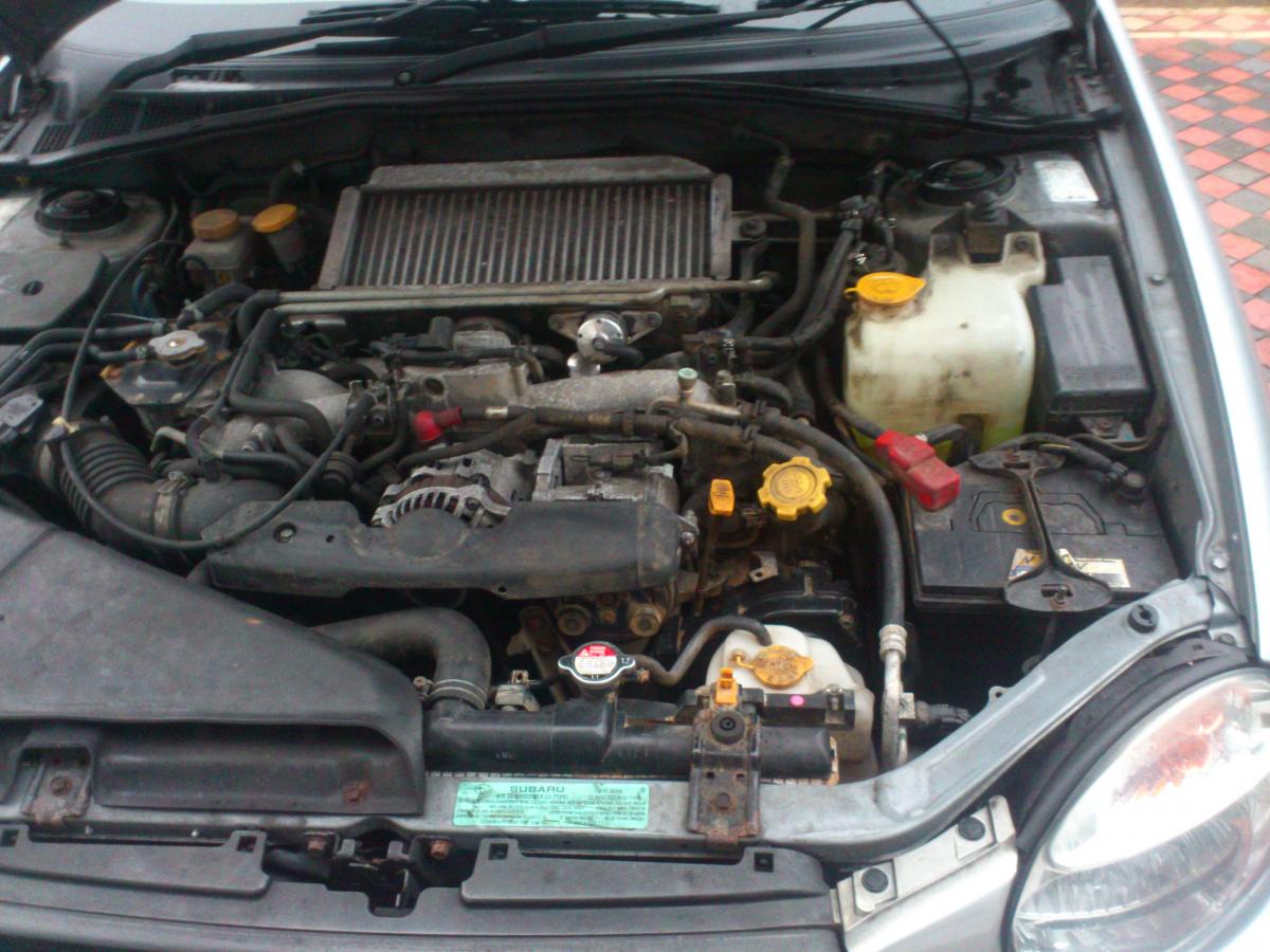

gnash Posted January 5, 2014 Author Posted January 5, 2014 Update Time Hi Guys Started checking the car over and discovered that the coolant level seemed very low, put some more in and she now seems to be driving normally( where should the temp needle be by the way). Am driving her to work in the AM (london rush hour) and will take it from there - Hopefully evrything has sorted itself,am going to do a full drain down, clean and refill etc as soon as i get a chance. Attached is an engine bay shot - can anybody tell me from pic if I have the right radiator and if not what it should look like - Am planning to renew the cooling system - so pump,stat and rad will be bought @ the end of the month. Cheers for all the help.

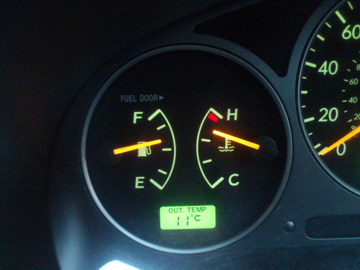

gnash Posted January 8, 2014 Author Posted January 8, 2014 Evening chaps, My baby has kinda been behaving, she drives normally enough until sat in traffic for about 5-10 mins then she goes up & gets all hot and bothered - is this normal - see attached - as soon as i'm moving again she drops back down to about middle which I assume is normal. Have a trip down M3 @ weekend - should i take her Cheers
Gambit Posted January 8, 2014 Posted January 8, 2014 Have you checked you coolant fluids checked for airlocks. ? I would change the fluid too just incase, can you hear the fans come onto. Sorry just read the other posts :D the needle on mine sit's below half only ever seen it go over half way once when I was on a track day.
Tlag Posted January 9, 2014 Posted January 9, 2014 The temp gauge needle should be approximately in the middle and should stay put once up to temp. Some sit below the middle and some in the middle. Yours is too high to be normal. Before you drive it next, check your coolant levels. Top up if needed. Then go for a normal sort of drive until at least its up to temp. When you stop, before turning the engine off, open the bonnet and lift off the yellow cap on the expansion bottle just at the top right of the rad in your engine bay pic. When you look inside, you should see a handful of tiny bubbles and the coolant being fairly static and at the normal level. If you see the water bubbling, frothy and higher than normal, you have a problem. It means you have suspect head gasket failure. The way to confirm this is to get a sniff test done at a garage. No point looking for oil/coolant mix type mayo in the oil filler cap. Scoobies dont do that very often. I think the rad on yours looks like the normal one. It dosn't matter anyway. In fact, it makes bleeding the air out much easier. Ref, your earlier comment about changing the water pump. By all means do that, but take the opportunity to replace the timing belt at the same time. It has to come off anyway to change the water pump. Obvioulsy, if the head gaskets need doing, it will all come off anyway. 1

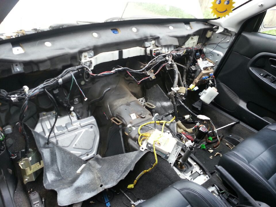

gnash Posted April 21, 2015 Author Posted April 21, 2015 Turns out the rad & thermo wasn't the end of the story. About 3 months later she started acting up again, then one dark night while hunting for my dropped mobile I discovered a very soggy footwell carpet. The heater matrix was leaking, so had that replaced and she now runs well at last. 1
Jay762 Posted April 21, 2015 Posted April 21, 2015 ahh a combination of issues - always harder to find but nice to hear it is all sorted now :) 1
gnash Posted June 2, 2015 Author Posted June 2, 2015 Just to finish this one chaps, Above is the photo my mechanic thougth funny to send halfway through the matrix replacement - I now understand why the say it takes so long. Gnash
