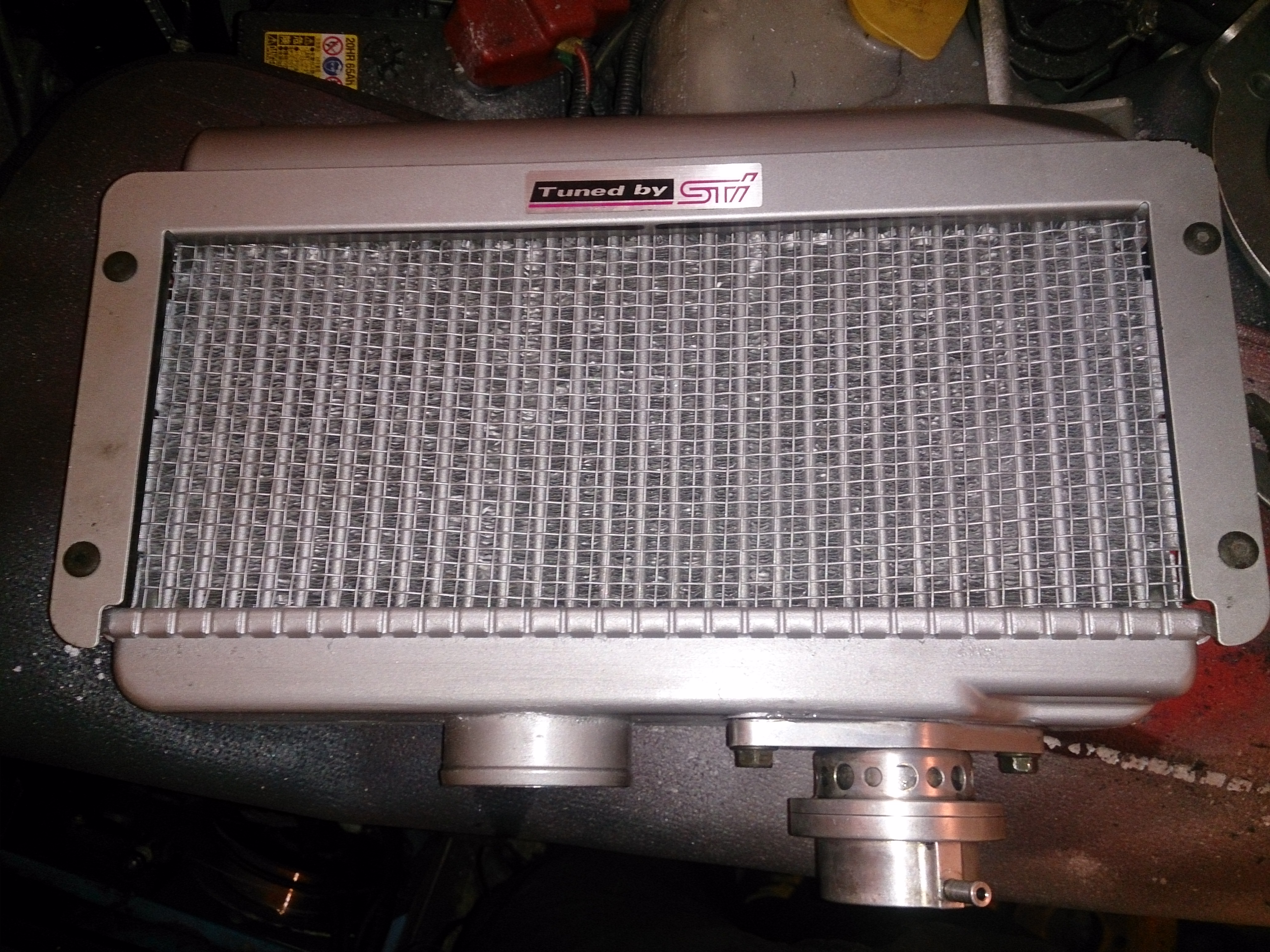

From all the top fins bent over and flaky paint to this 6 hours of adjusting intercooler fins and a bit of paint
Top job there mate it's a total ball ache I had to do mine after hand car wash man attacked it with the lance [emoji35]
It that an aftermarket mesh over the top ?
Sort of DIY special

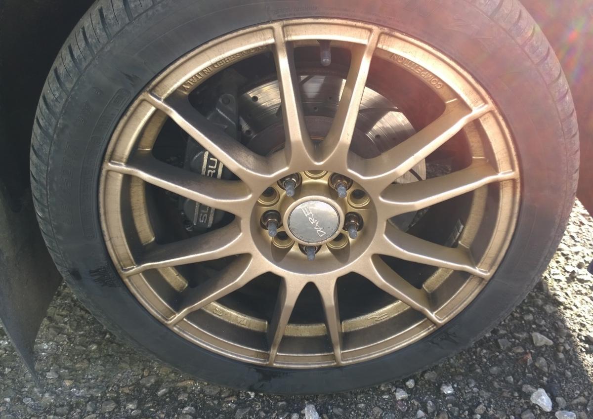

Well bit of naff news. One of the rear tyres was loosing a bit of pressure so took it in to have it checked. Turns out the rim is split and buckled :-( remember catching a bit of a pot hole a while back but not thought anything of it. Back on the original rims now as I'll have to see if I can pick up another wheel. Apart from that all is well (touch wood).

Excuse the dirty wheel, any idea what the oil substance could be on the tyre? Could be the reason I'm sliding about a bit on corners.
Jack it up mate whip the wheel off and check the break line's and around the calipers plus bleed nipple for any brake fluid.
Got it being looked at tomorrow night, also having drop links and rear strut brace fitted. Its looking more like strut leaking onto my wheel. Will have a check of the brake fluid level before I leave for work

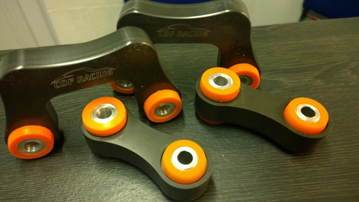

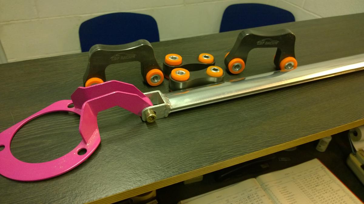

Stuff to be fitted on Saturday
Question about the rear strut brace, can you keep the parcel shelf in?
These cars are money pits ;). You either spend money fixing something or buying upgrades! In my case both this weekend, turns out the caliper is leaking. Only have to drive home from work then its on the ramp.

And yes you can keep the shelf in with a brace I have one on mine [emoji6]
