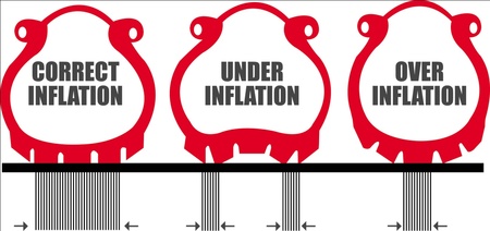

Decided to up the tyre pressures as an experiment, bad move, car slides like its on ice all the time lol. On the plus side I'm having loads of fun on corners now, who needs snow?!
haha yeah that's right, will drop them back down now I've had my fun
How high did you go? [emoji54]
I did the same a few years ago.....feels like it`s on castors :lol:

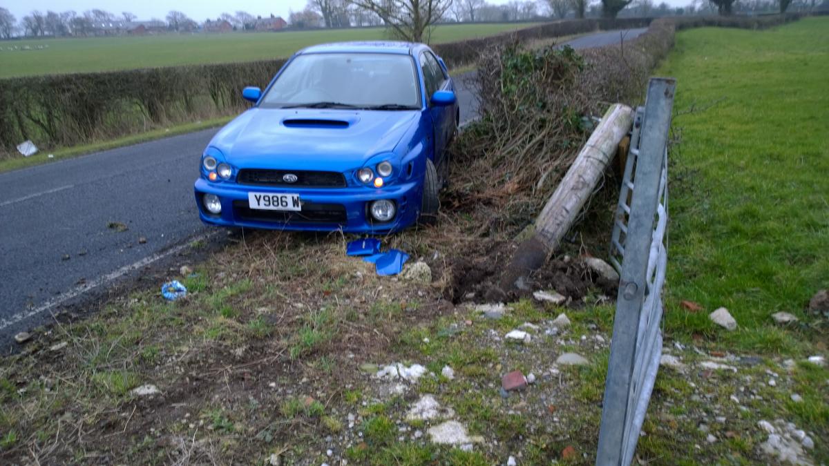

post-2084-0-95918000-1423821097_thumb.jp
Oh dear
