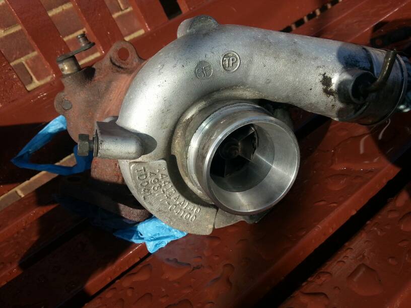

    If it's a tdo4 or tdo5 the id will be in the same location as in this pic Sent from my GT-I9300 using Tapatalk

can you see the turbo to have a look at the ID plate?

Struggling to get the shield off at the minute I don't have the right socket for it.What colour should the injectors be
I'd guess it being a TD04 :)
I'd say it's probably a tdo4 as well (good for 290 hp ish)

Had alook at my injectors and you can see under the injector plug that there yellow injectors and the turbo is a tf035hm carnt see the rest.

I don't have a td03 turbo though lol what is the tf035 then I carnt make out the rest of the numbers there hidden
Vf35 maybe ? Wrx's had these maybe visit a subaru specialist in your area investigate more
