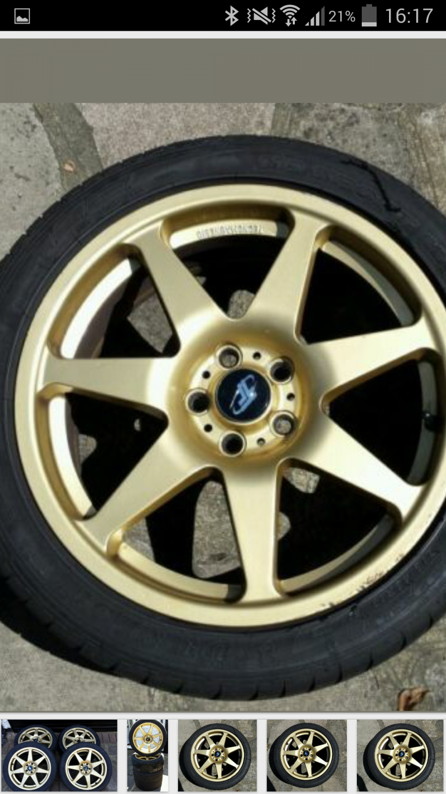

I like these :) post-1579-0-17851800-1402932429_thumb.pn

If anyone ever comes across these I want them !
By all accounts Canadian option only :-(
Yes they do look nice, much prefer the SF to SG really.
TSW & BBS have/had very very similar wheels to that spoke design.
