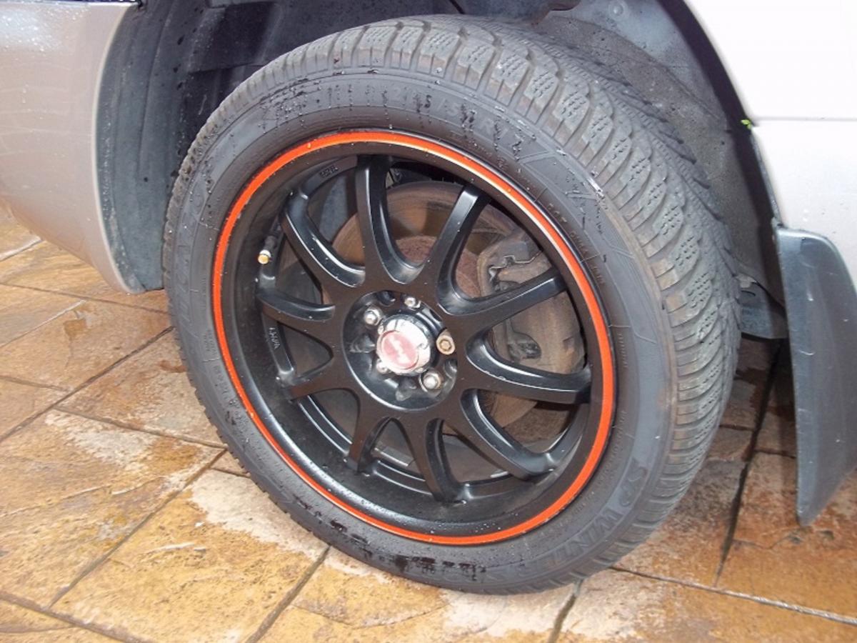

Here is a quick photo of one of the wheels on my XT.
I personally like the look of Black Wheels on a silver car but not to everyone's taste.

Look v nice in black my foresters black I was thinking black wheels on mine them wheels r nice :):)that's what I was looking at then the wrx wheels came along now seeing them in black changing of the mind again :):) if u did think of selling I would think about them :):)

I'm glad i stated the link also Liking the wheel pictures , so 17's r possible I'm definitely liking the black the more I look the more I like :)

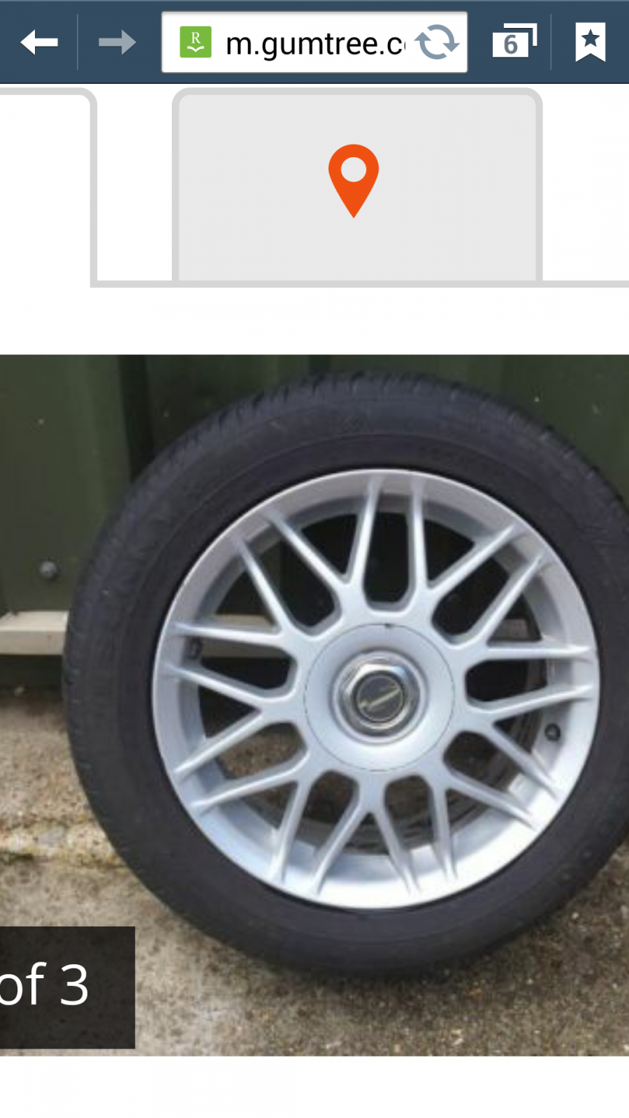

These r the nearest I've found in 16's stanton :)post-1579-0-09150600-1402931248_thumb.pn
