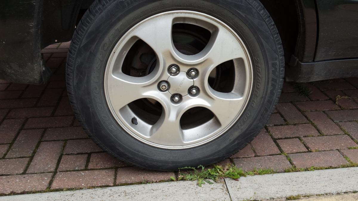

What condition are your 'standard 16's' in?  ;)
Here's minepost-1579-0-88792400-1402847257_thumb.jp
Mmmm that's what I want for mine [emoji6]
Here's mine
