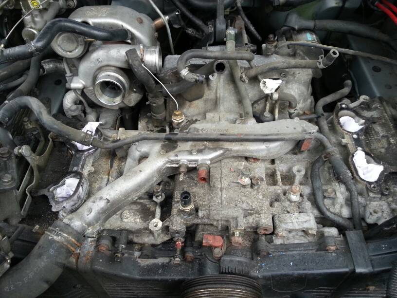

to be honest I've never seen a 6cyl boxer engine but , I'd assume that they'd be some similarities between that and a 4cyl turbo .
Are you sure you've disconnected any sensor wires or cable ties for the engine loom that might be restricting the pipes movement .
Maybe this pic of a 2ltr with the inlet off will help you work out its route
The only thing restricting movement of the pipe is its shape and location. I can unbolt it, remove all three hoses, and it rattles loose - but there is not enough clearance between the head and the cross-member to get it out, owing to the complex shape of the pipe. I'll get into it again at the weekend and try some other things to get better vision and access.
Thanks for the thought, though; I'll update as I find out more.
