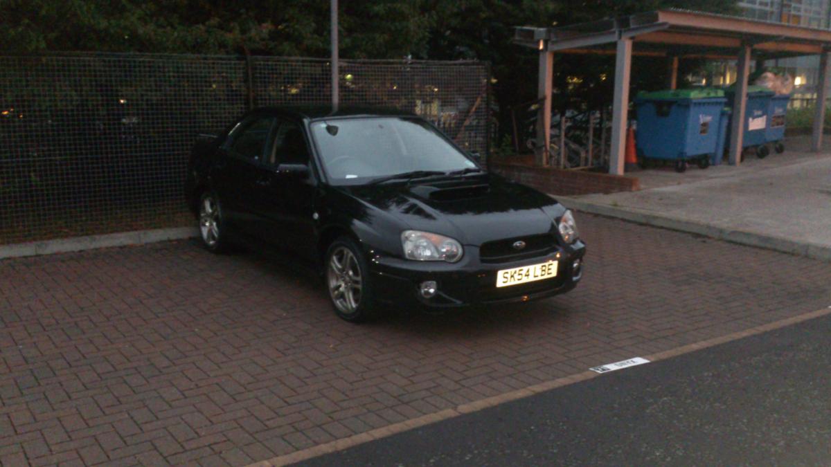

Finally, after years of wanting a Subaru Impreza... (and a wife who didn't) I have finally won her over and bought one! It's a completely bog standard, 2004 WRX. I am the second owner and it has done less than 32k!! I've only had it for 2 days and covered 60 miles and I already know I'm going to love owning this car!!
Been doing a lot of research into dumpvalves, induction kits, exhausts etc... Basically my goal is not to go down the mega tuner route. I just want to do a few minor changes, first one being the exhaust. I want to just have that distinct burble, nothing too loud otherwise the wife will probably go mental! So was just thinking of changing the backbox and see how that goes, maybe further down the line doing more but I reckon it's a good place to start!

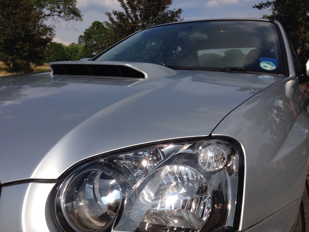

Oh no mate. I was talking about detango, so removing the Orange and if you want black them a bit so they look more modern and moody.
I didn't black mine but this is what I mean....
