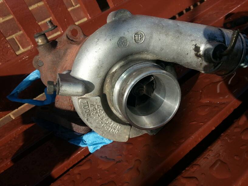

As for turbo identification here's a tdo4 showing the id markings (tdo5 markings will be in the same area)

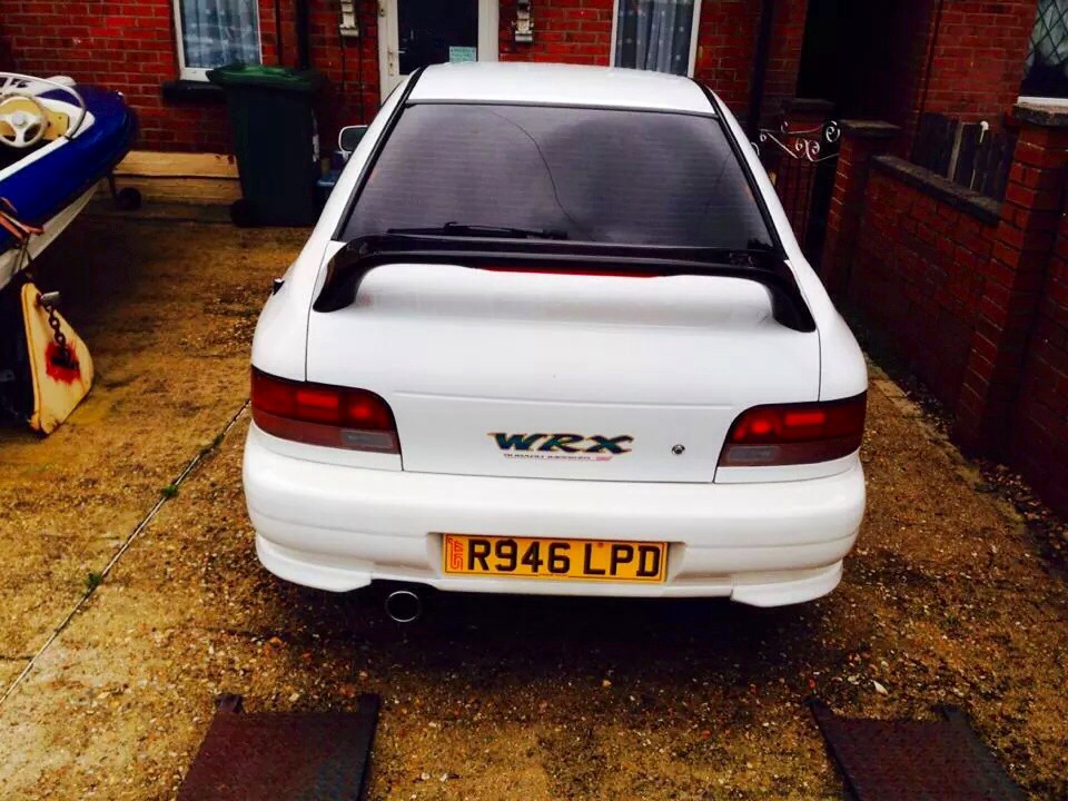

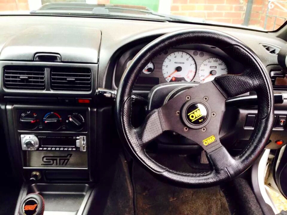

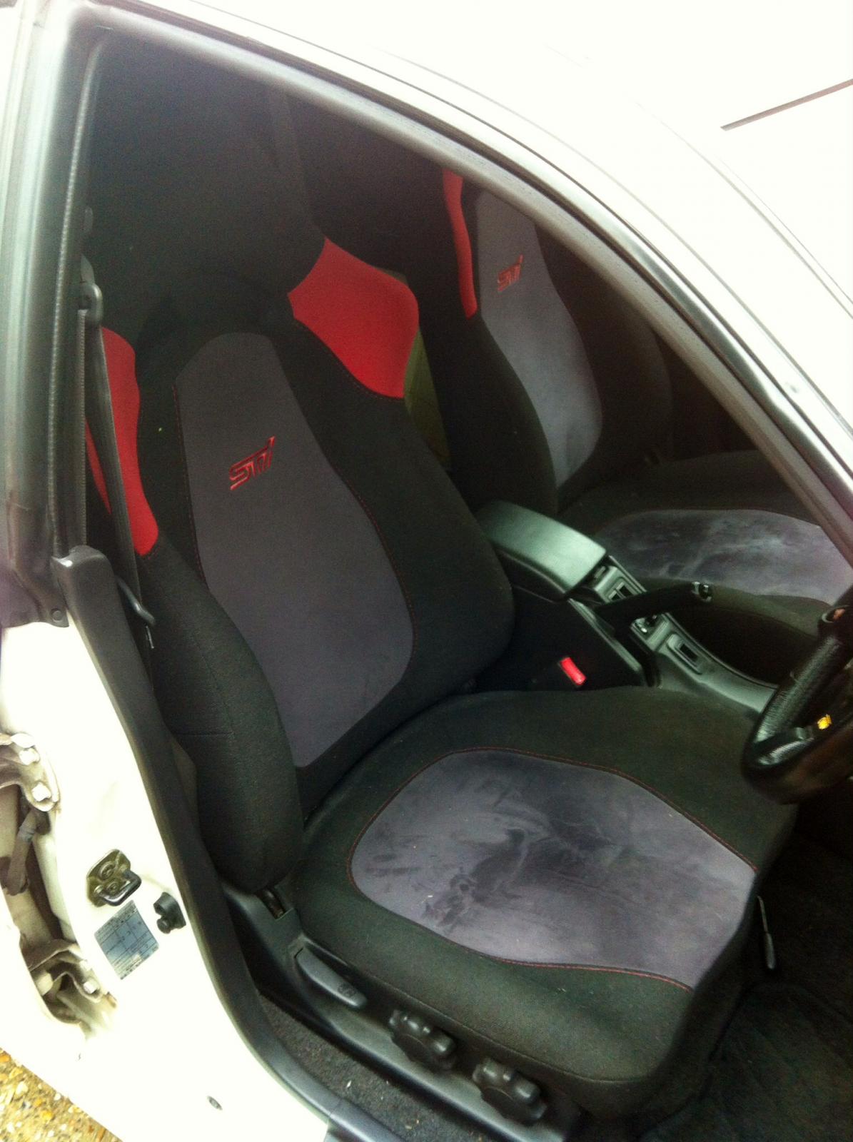

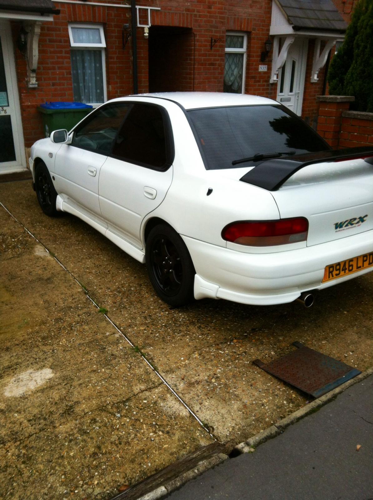

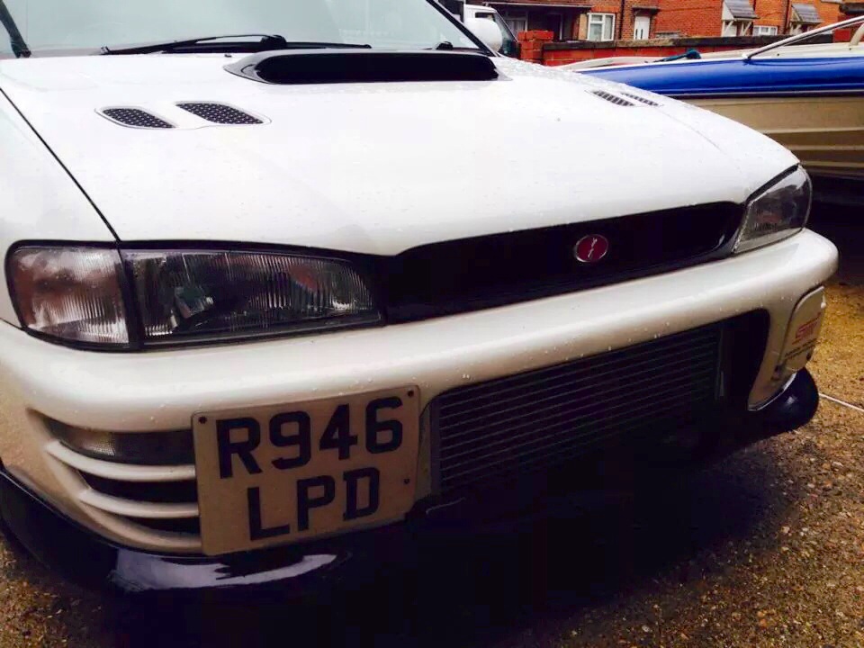

Here is some pics :)
Sorry, car does need a clean
