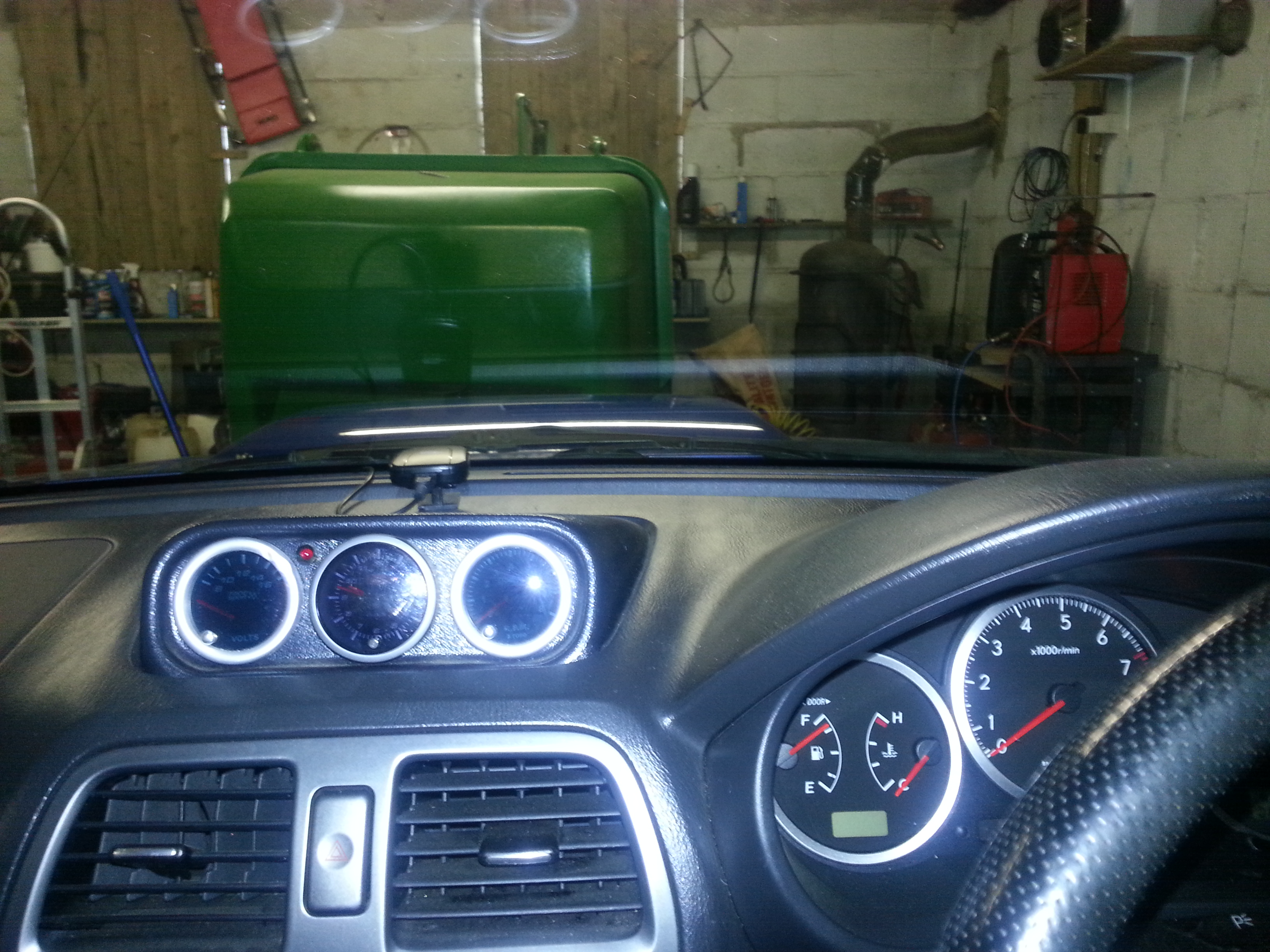

  • Here's mine, got bored of waiting for gambit to post his up [emoji16]

Looks stunning and oe fitted............well better tbh as it would not be as good if factory oe B)
Love it!!
