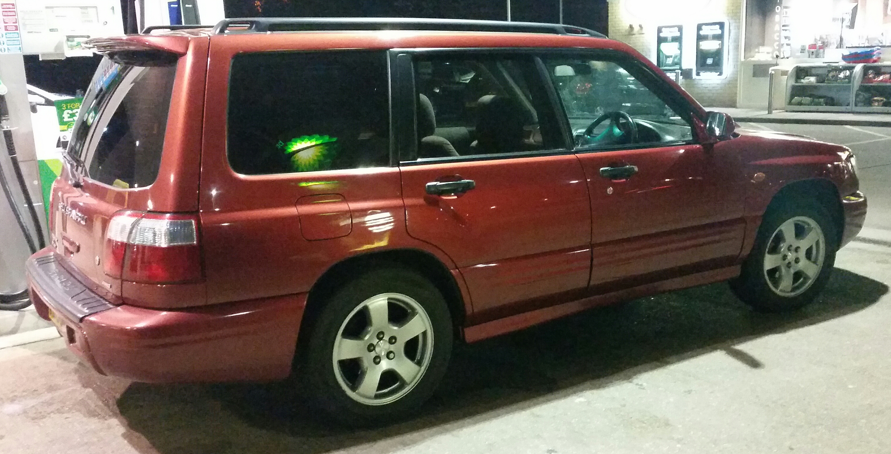

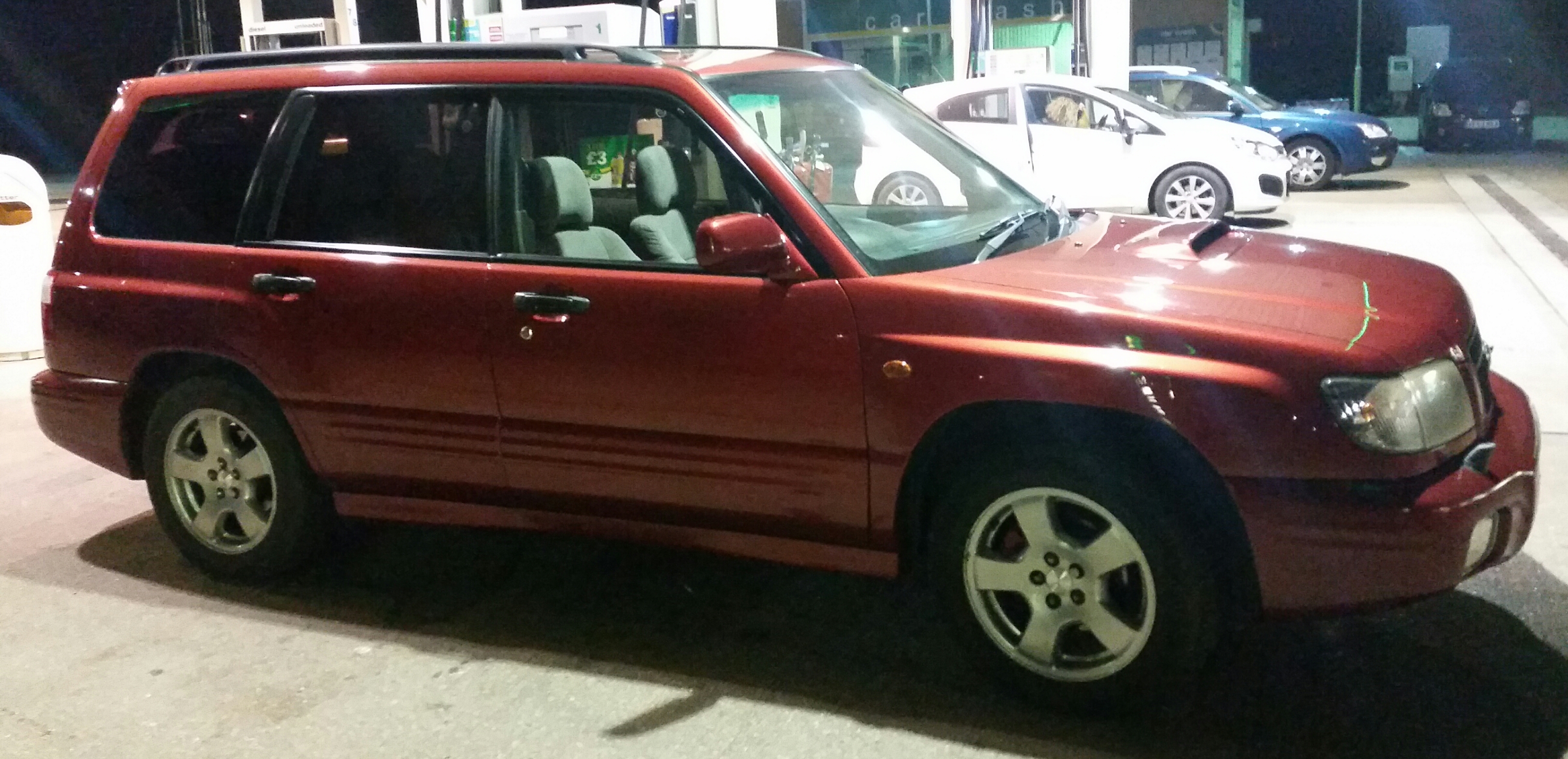

Red 2001 Forester S Turbo
Retserof
Loving it. Wolf in sheep's clothing. Immaculate inside and out. A credit to previous owner.
It's sitting a little high at the front because the rear has a complete spare set of alloys and a passenger rear door in the back thrown in with the sale. Very generous.
They were the original t spoke that cams with this model. They need a refurb and I will use as a winter set with winter tyres. The existing tyres are past there sell by date. But great to have options.

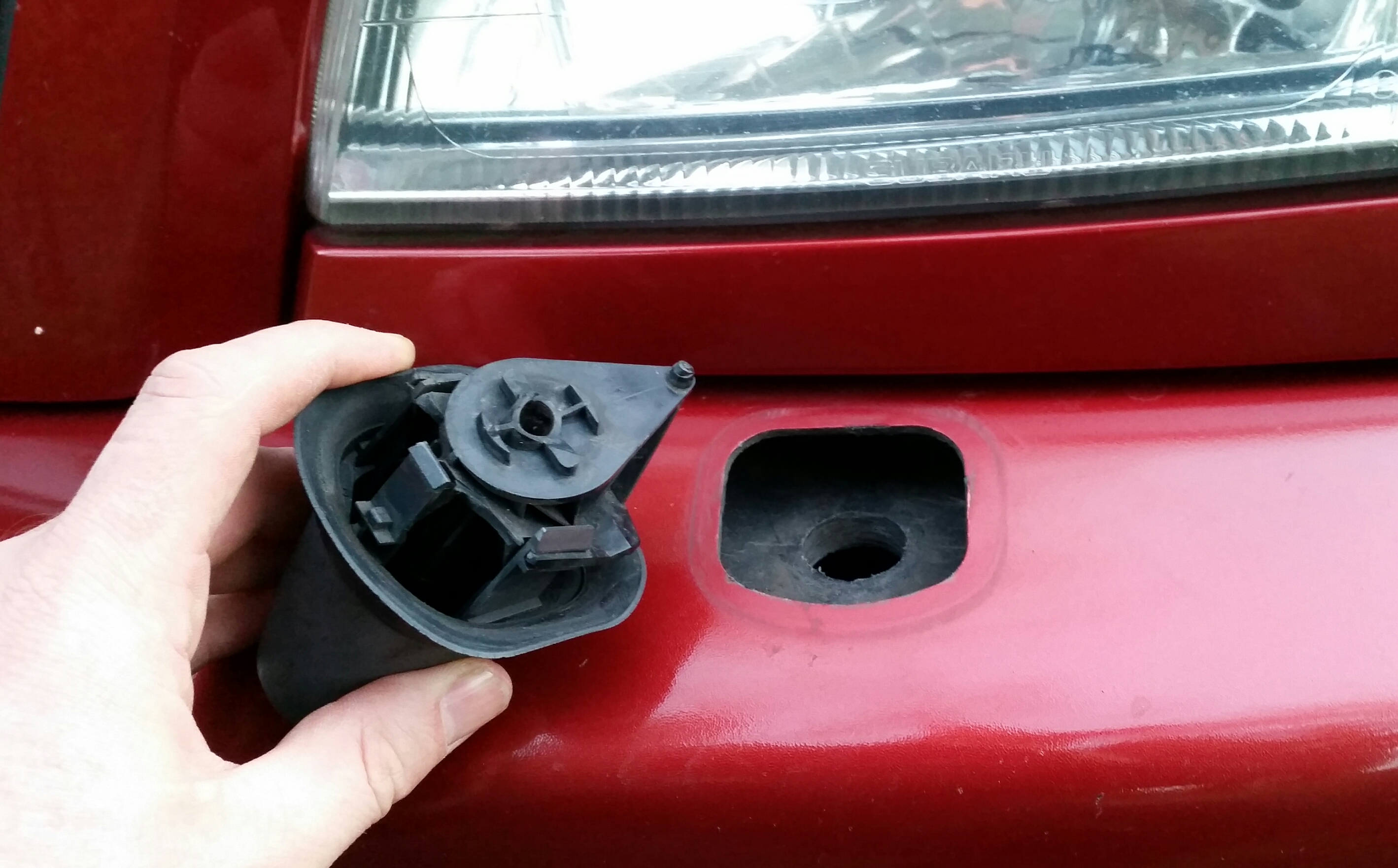

Just remembered why you shouldn't get your car washed by someone else. One broken headlight washer. What's the usual remedy? Glue it back on. As it wasn't working anyway or is there permanent plugs of some description? Cheers
