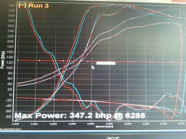

Must admit I was looking to up my power to around 400 ( currently have 355) but think pound for pound I'll get more out of suspension upgrades such as mentioned above. If I can save enough on my next trip away for work I'll go for the tein coilovers possibly with the active pro edfc.
that's a normal list of upgrade parts and that's what I have had fitted to mine. I've been running 330bhp for 5 years and I haven't got bored with it. yes I'm used to it, but I don't think it needs to be any faster in a straight line.
