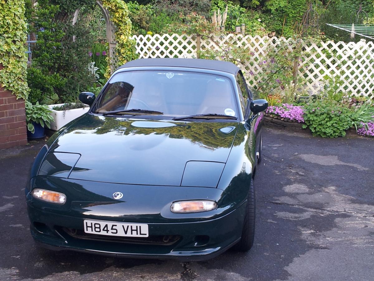

if i can get it looking anything like this i'll be happy.
not bad for a 22year old coat of paint : ) post-878-0-78542700-1372847440_thumb.jpg
That looks like it's been machine polished, you can get it as shiny but up close you will see swirls, pb do a black hole polish that will hide quite a few of these swirls on a dark/black car when using by hand but you will never get the same result as a machine, if ever you decide to buy one I would suggest a da as there's very little chance of causing damage with one, the kestrel das6 is by far one of the best units to have and a good price too
nope that's nearly 5 hours of washing claying, and a load of megs products and a elbow grease : )
i like to try and keep my cars as good looking as possible. then when you tell someone how old it this they don't beleive you
job well done imo mate, praise due indeed
