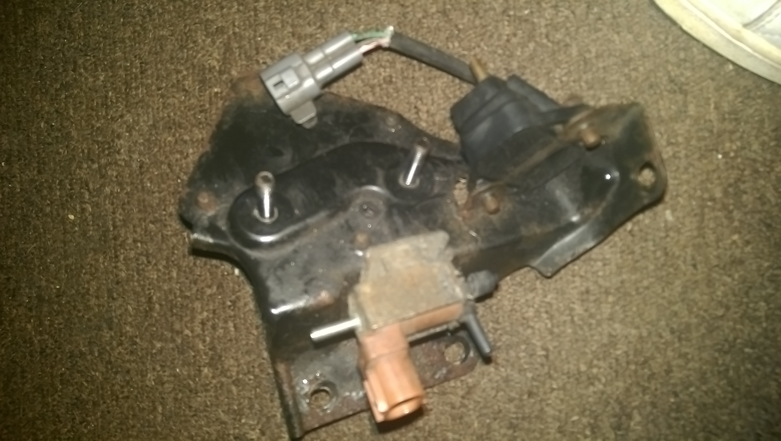

Ive had the dash out and put a new CEL bulb in and I get code 44
Wich is the code for the oem boost selonoid malfunction abd it's obv it's been removed any way I can bridge the plug for now?
Can this really cause a fuel cut I guess it could. . . and my best bet is to fix that fault code 1st. Just hope I'm not chasing my own tail and wasting money on it
Cheers again guys
It's non existence I belive. . . it's running an avcr wich I guess does the same job but without the stock one being there I guys the ecu has no clue of what's happening
You could try by passing the boost control system all together and temporarily running "actuated boost"(about 0.5 bar) just see if it stops the "cut" or miss your getting
You do this by running a vac line directly from actuator to turbo outlet and pluging the vac lines you disconnected
If it improves maybe try to put the boost vac lines back to standard by picking up a 3 port boost solenoid (about £30) and re fit the standard map sensor and air density sensor (on that bracket)
As maybe the ecu is confused cos it doesn't have control over the boost the avcr has instead but not ever owning a avcr i don't know much about them tbh

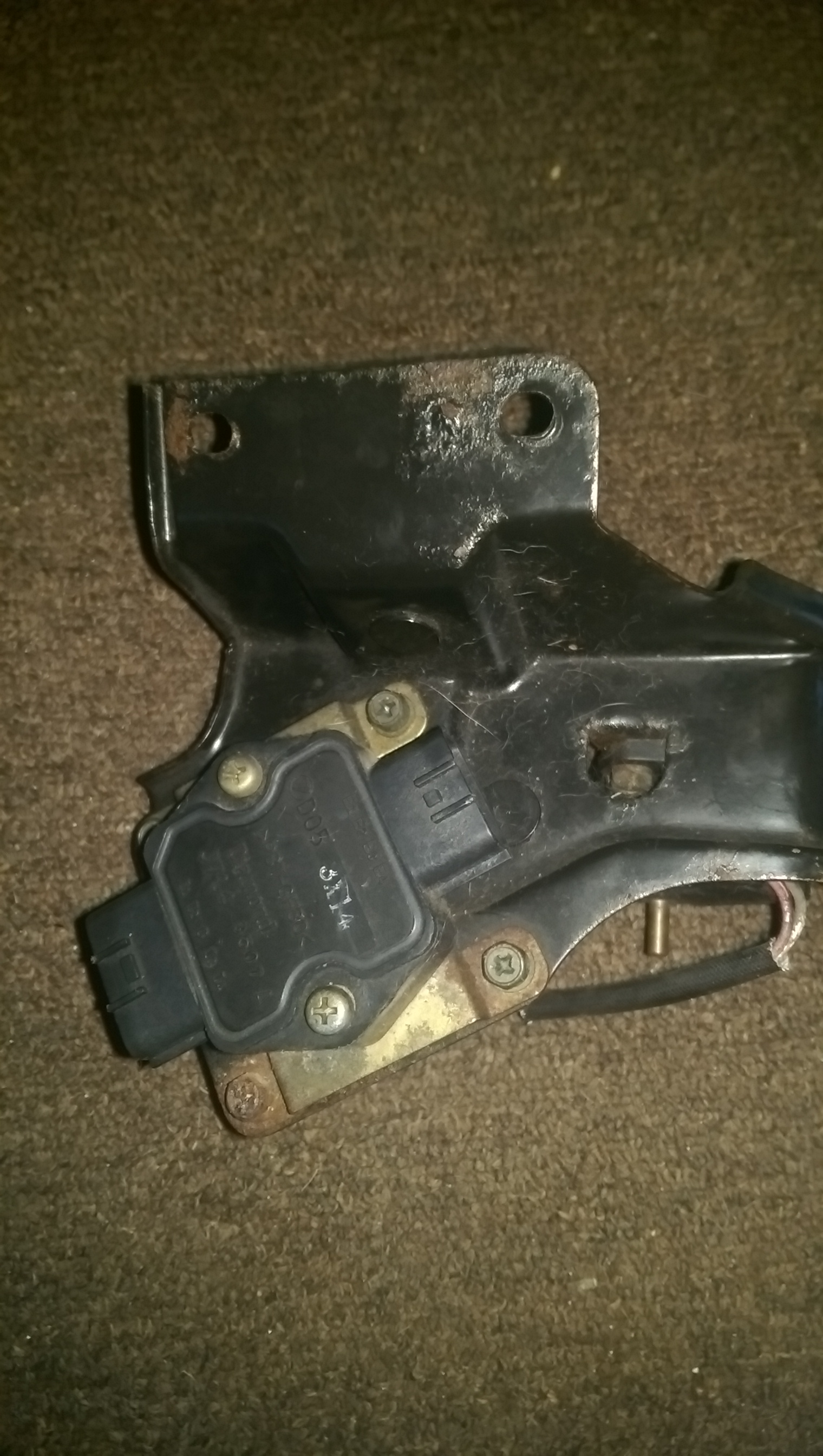

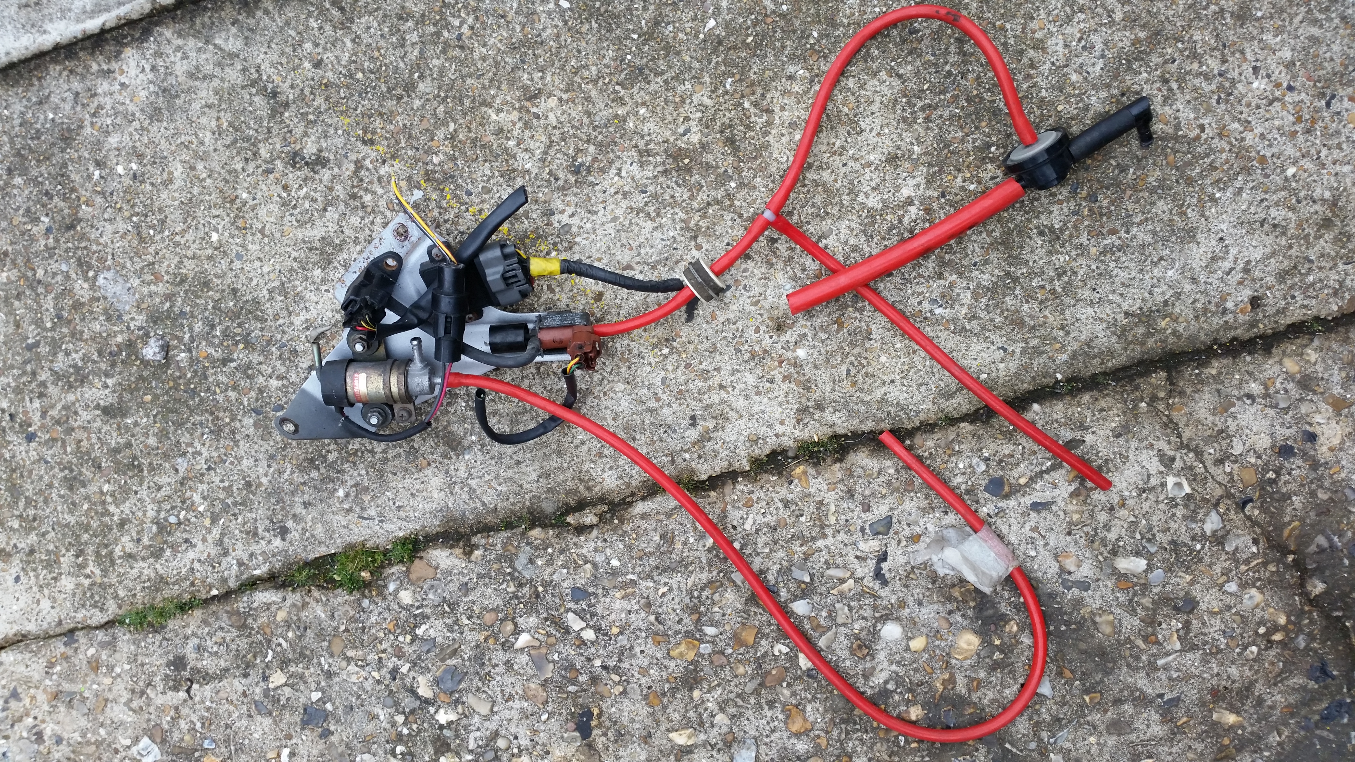

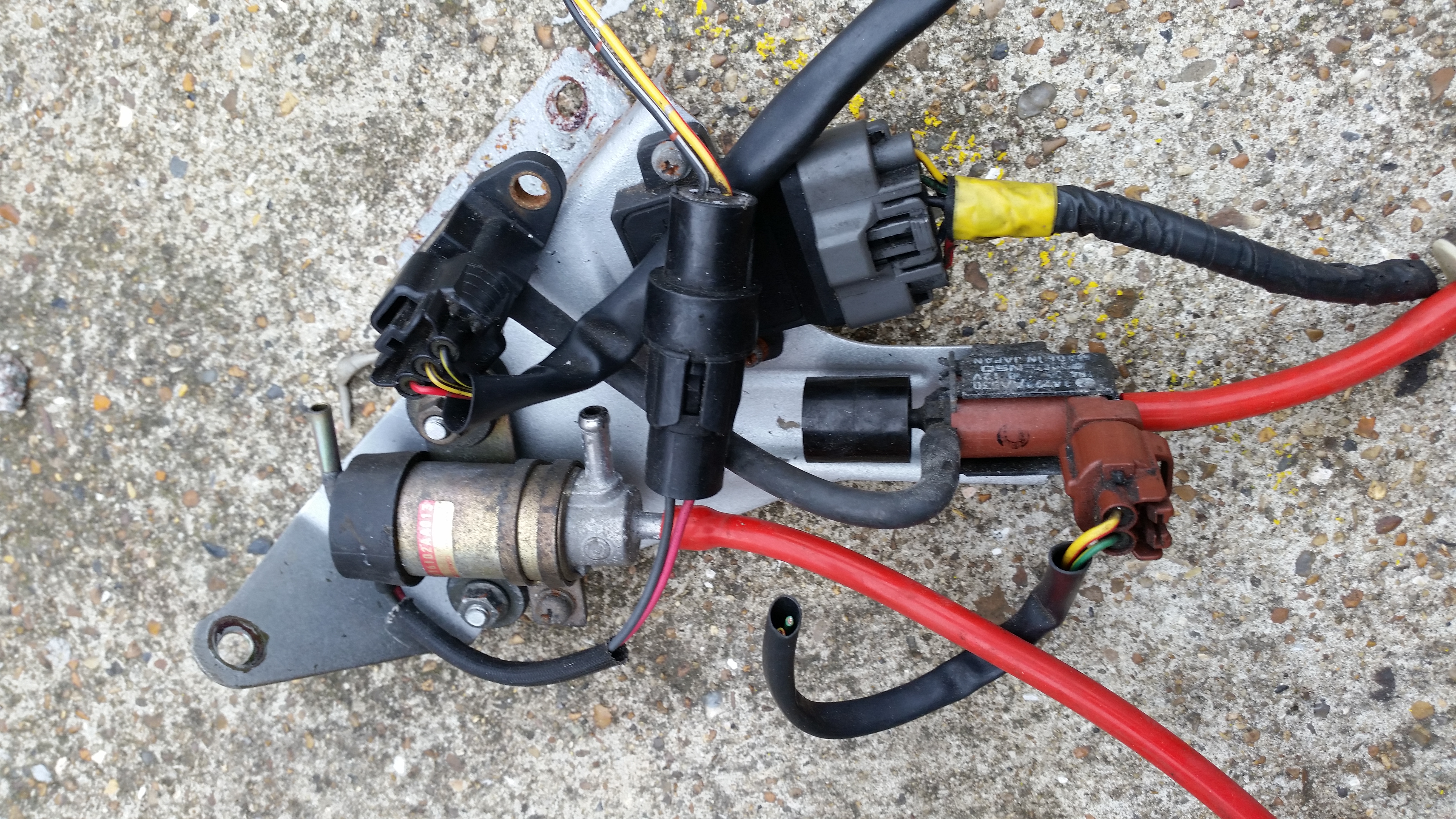

Here's a couple of pics of the v3 set up I hacked the plugs of the cars loom in case I had to wire in a custom bit at a later date
There's a few differences in the versions but it shows how to plumb the vac lines from the map sensor to the air density sensor (bit with the burgendy "cap") and then to inlet manifold
The 3 port should be
Top port to turbo outlet
Middle port to actuator
Bottom port to intake pipe ,which is the small bore take off (blanked with a bit of blue vac line with a bolt in it) on the shiny turbo intake pipe your holding in a earlier pic .
