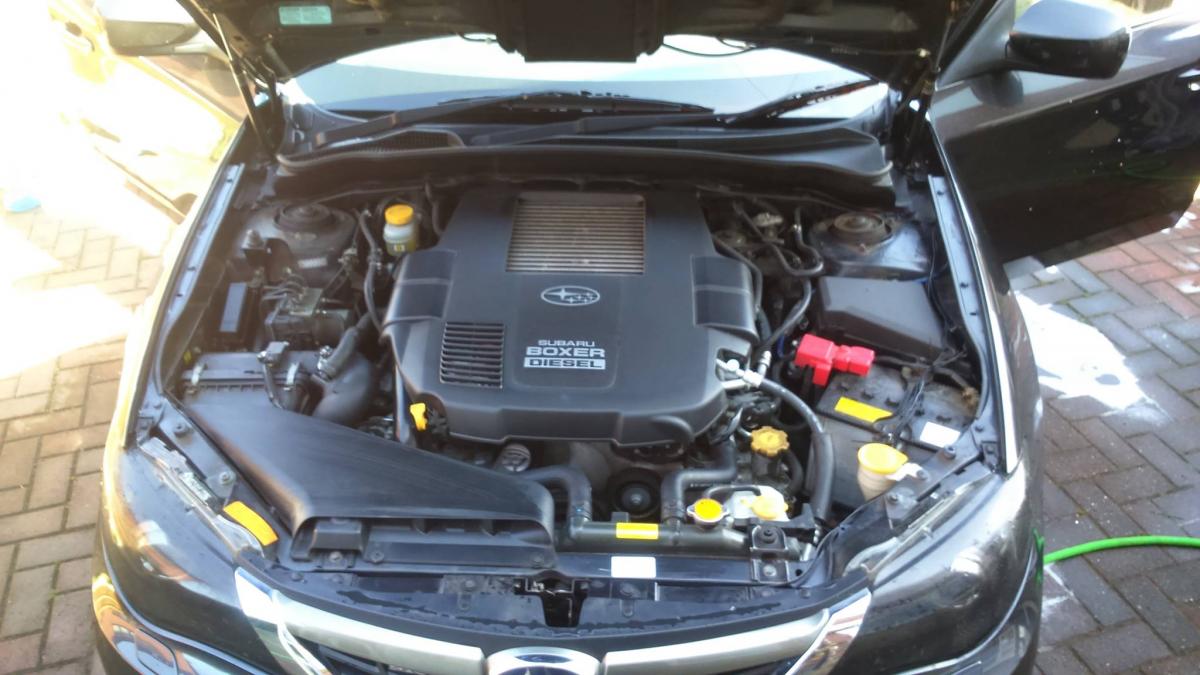

Thank you for your help so far, If its not required on Diesels then I will leave it off, I just thought it might help as I'm more used to petrol cars. I've attached a photo, if you guys need a more close up view I will take some when I get out of work.
