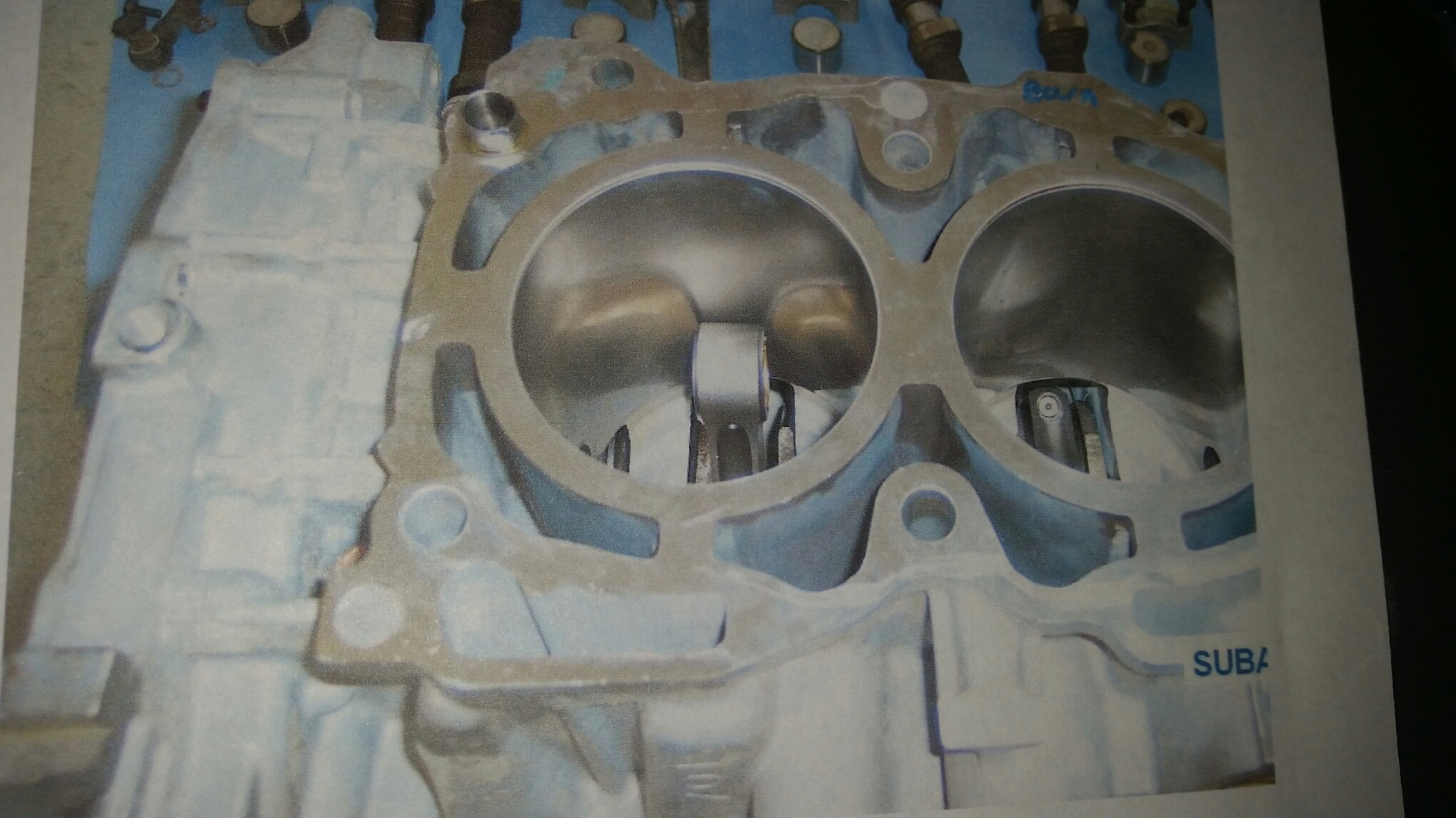

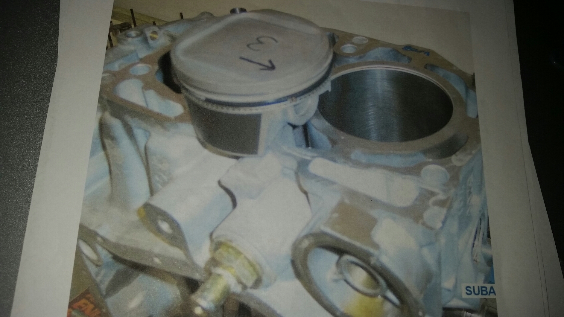

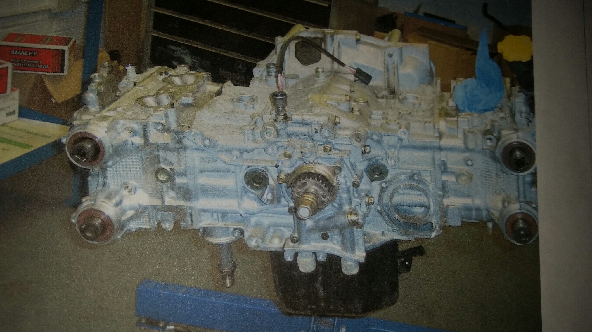

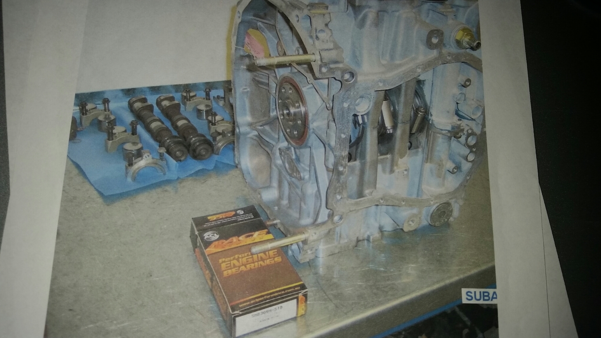

I don't think it is a cdb looks different but this is a pic of mine that was taken when the build was being done

Sounds like you've got quite a few mods in place to support a hi power engine but unfortunately it looks like the block is semi closed and it will be the weakest link at about 450 hp (rods and oil pump pending )
Here's my closed deck block face to show the comparison in the amount of metal around the cylinder liners that give it the extra strength with the right internals
