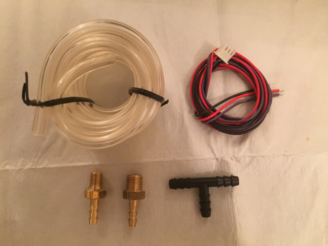

Did you order the extender mate ?
Yeah. Ordered the kit and some extra hose. Scoobyparts not back till Monday so should arrive next week. Shall I drop you a message when they arrive

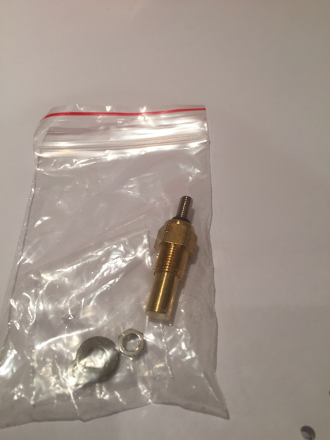

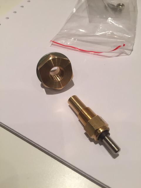

What does the oil pressure sender look like. I have one of the senders in pic 2 but just like a bolt with the oil pressure like the one in this pic
post-4160-145219584697_thumb.jpg. Is that right?
Sorry the pressure sender is in pic 2 it's the temp sender in the other pic,

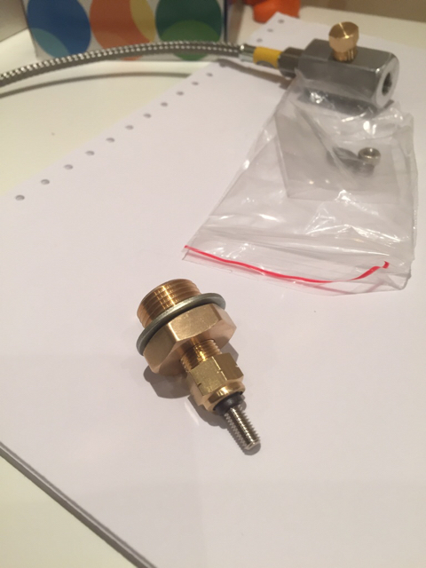

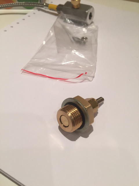

Mine looks like this as all electric
Have you had a look at the kit you got from scooby parts ? Does the sender screw into the threaded bung ok ?
Like this?
