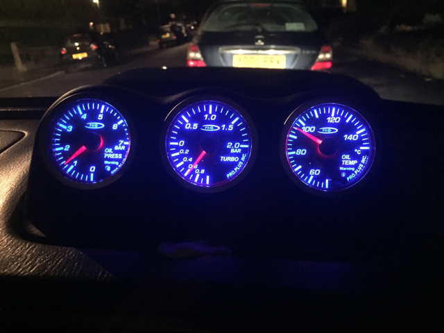

Everything working fine. Boosts at 1.3 bar as it should. Oil temp runs at 100, 110 if pushing hard? Oil pressure runs at around 4.5. Gauges fitted in securely. Just need to drill a hole in the pod for the alarm light and then all done.

Decided to take car to work today to check on gauges. Everything appears ok. Temperature is showing between 104 and 114 degrees. At one point warning lightly came on very briefly. Car is mapped to 280bhp and running 5/40 oil. Should I look to change oil for a different mixture?
Around 4.3 psi
Normal Running. Idle is around 1.6
4.3psi or bar? 4.3psi is very very low, I idle at 20psi hot and that's with 5-30, although the next change I'll probably go up a grade or two
Sorry bar not psi
Oil temp
Just been out for a 10 mins run. Here's what they are reading at idle
What's your oil level like?
The temp is a bit higher than I'd expect considering the ambient temperature. I haven't seen over 100℃ since japshow in July. But 100-110 isnt dangerous. 120+ would start to get a bit naughty.
We're you seeing 100+ with a good run or general poodling around town?
Also, what temp does the gauge read when first started cold? Knowing stants it'll be a dodgy earth [emoji23] [emoji23] [emoji23] [emoji23]
It may have always been running like that and now you have gauges just something to worry about lol,
And the gauges may read a little off, mine do I know the water is about 5° over what the ecu says, do you have an app for the phone so you can read codes etc ? May be able to cross reference the ecu with the gauges to see if there's a little variation
Will changing the oil be an option. Previous owner always ran on 5/40 so I've just followed
Read the cised ?
Codes ,sorry !
Some people go up to a 10-50
Worth a try. Don't want to do damage by over worrying
