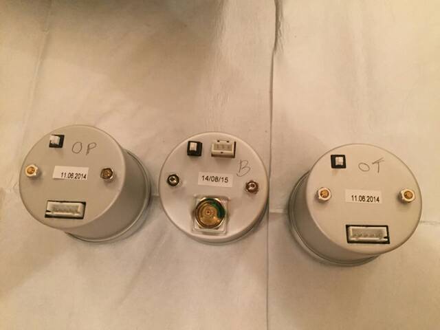

Correct way to Install gauges
So what attaches to that back to the gauge then?

Yep. Each gauge has its own connector like this
Ok so you'll have to wire those in to the sender's. That's where Mr stants will come into play. I had him on speed dial the day I did mine. Trying to explain it over type is tough. Do you have a good couple of metres of cable? Grab some connector blocks too.
