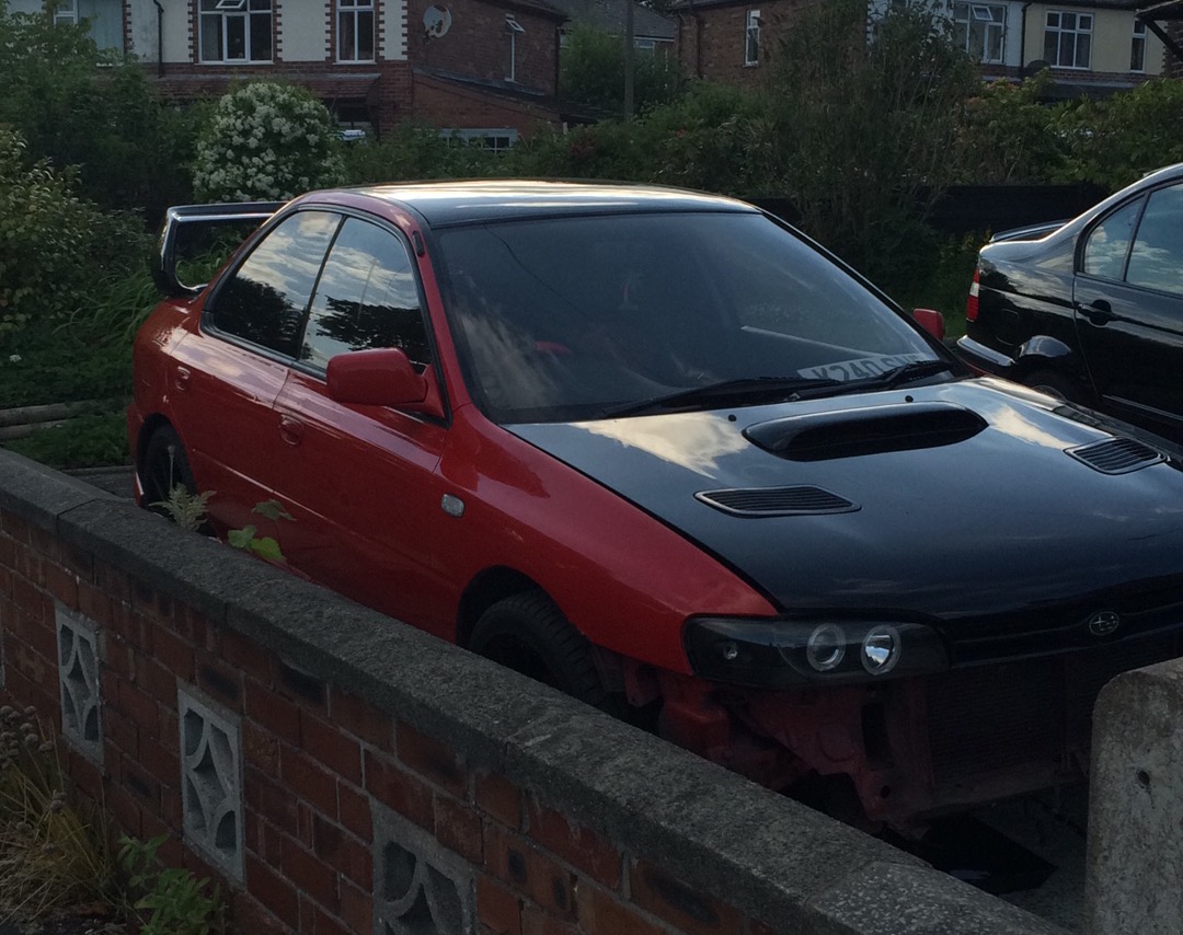

Hi Geoffleggy, I have a 92 Impreza ej20 currently rebuilding it, and slowly buying bits, I need some injectors to pair with my td05, looking for 320-350 bhp so thinking 440's which may max out so 550's will be better option but more expensive.
Yeah my mates got 440's for sale £40 or 900's for £100 but there abit extreme? I'll be buying fmic and I already have stage 4 paddle clutch, Bailey blow off valve and will be getting new intake hose, I already have a full coolant hose kit purchased.
Buy the 440's and send them to Injectortune or someone to give them a good clean.  They will be like new and you'll know they are 100%.
I assume you have a good mapper lined up for when everything is in place? What exhaust system have you got in mind, you'll want a decat in place before the final map to get the best out of it all.
I might be missing something but hopefully someone will jump in.
