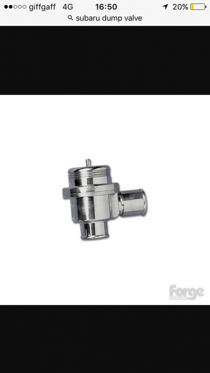

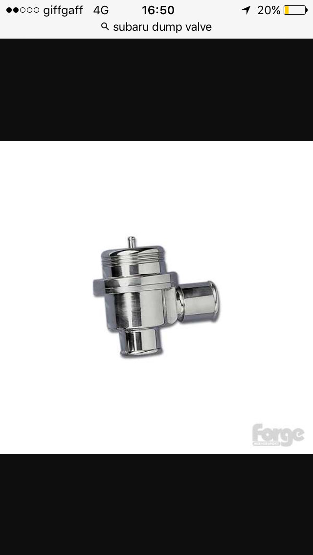

Top one is a recirculating dump valve

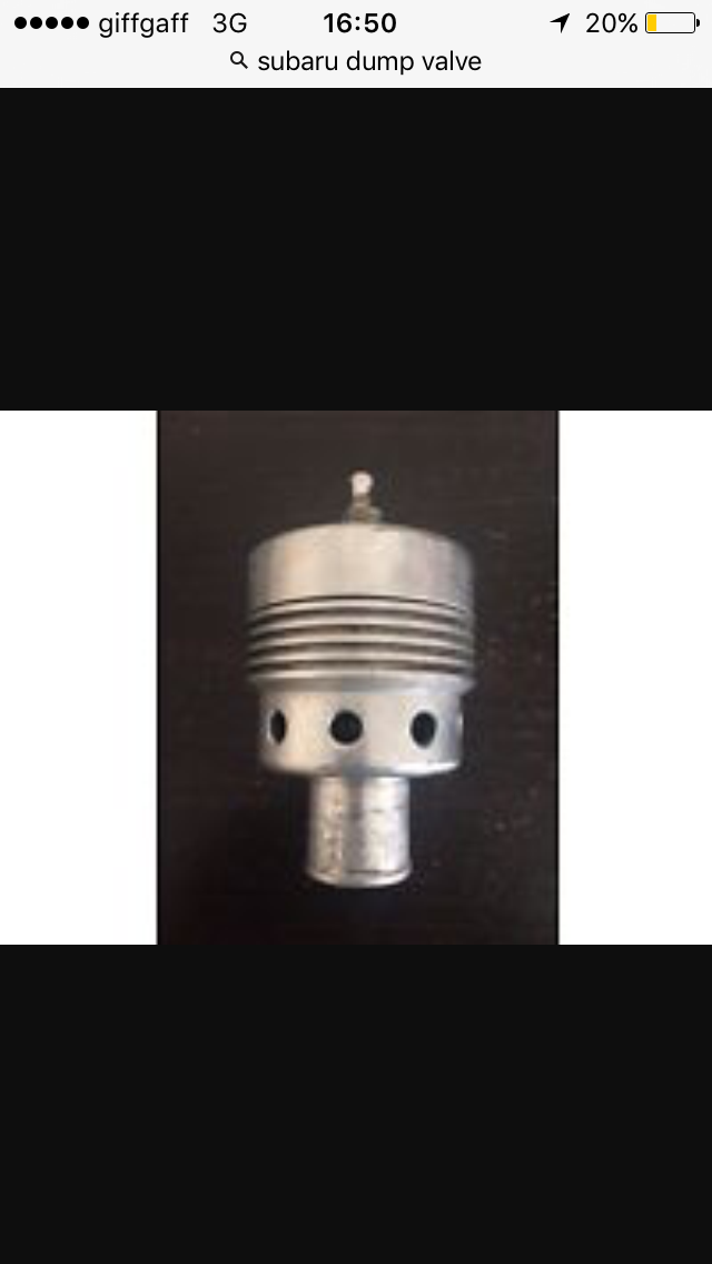

Bottom is a atmospheric dump valve.

Unless the original one is leaking then I can't really see a benefit myself, the top one of your pictures would fit(need the Subaru adapter for the intercooler fitment) the bottom one would fit with a blank on the return pipe and would give you the tsshhhh sound
Top one is for v3/4 cars with the recirculation valve in the elbow the pipework.
Bottom one looks like an earlierv1/2 type if yours is a v5/6 then neither will fit properly
