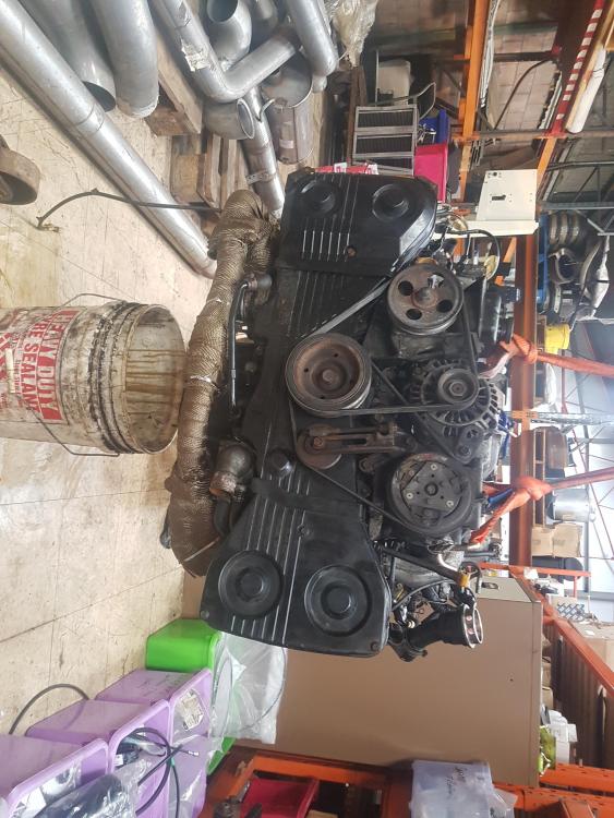

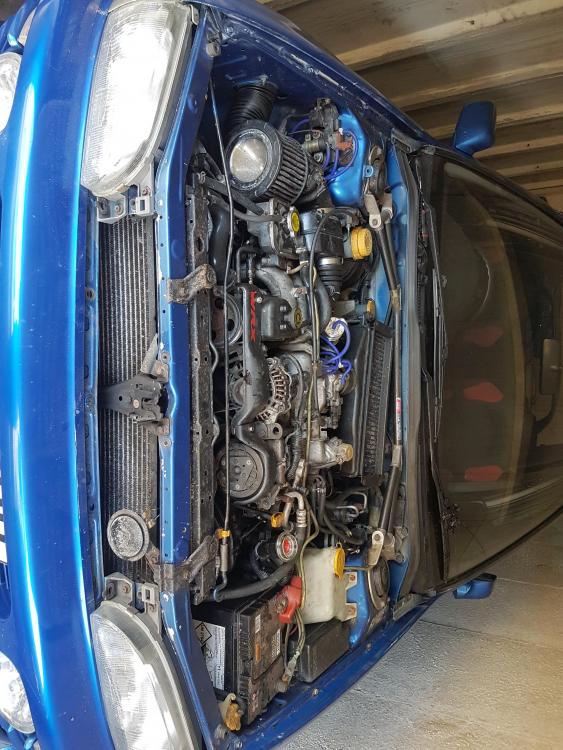

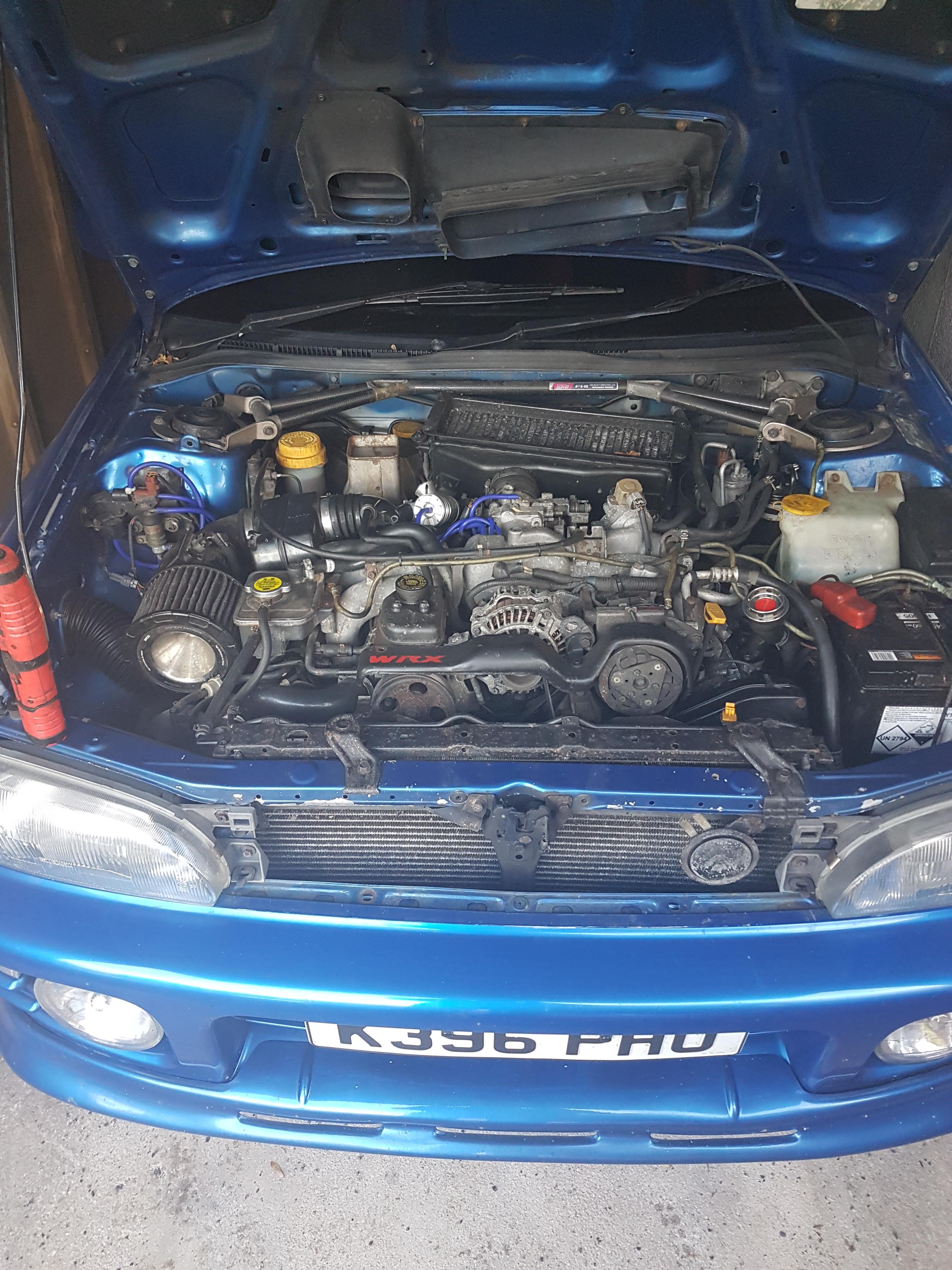

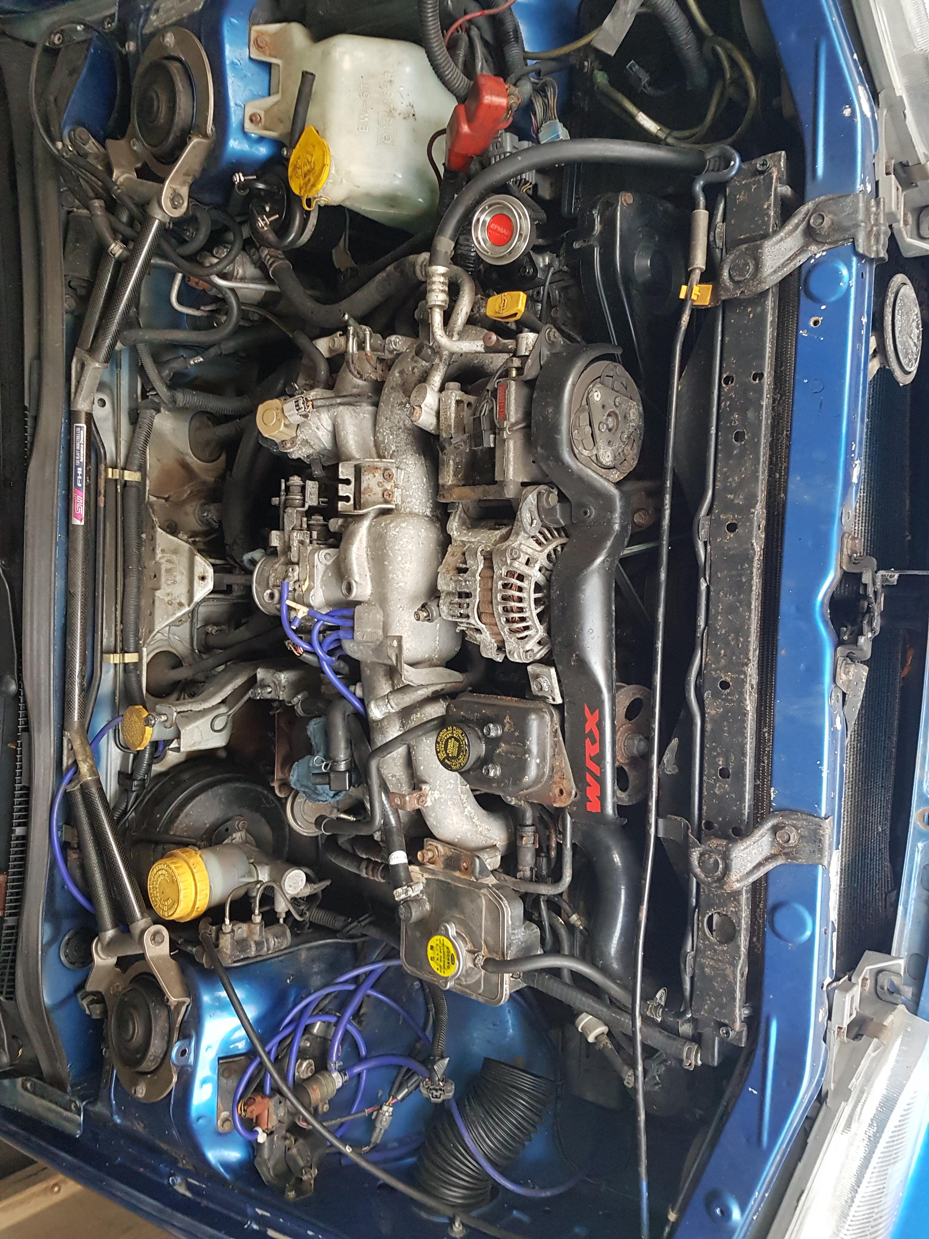

Day one of engine removal between getting called out to fix broken down trucks, its went from this....
To like this.....20180106_130637.thumb.jpg.f77d980864c4394a0c0dc7abb315ff45.jpg
Now just the coolant to drain and the rad out, disconnect power steering pipes and aircon then it'l be ready to lift out
