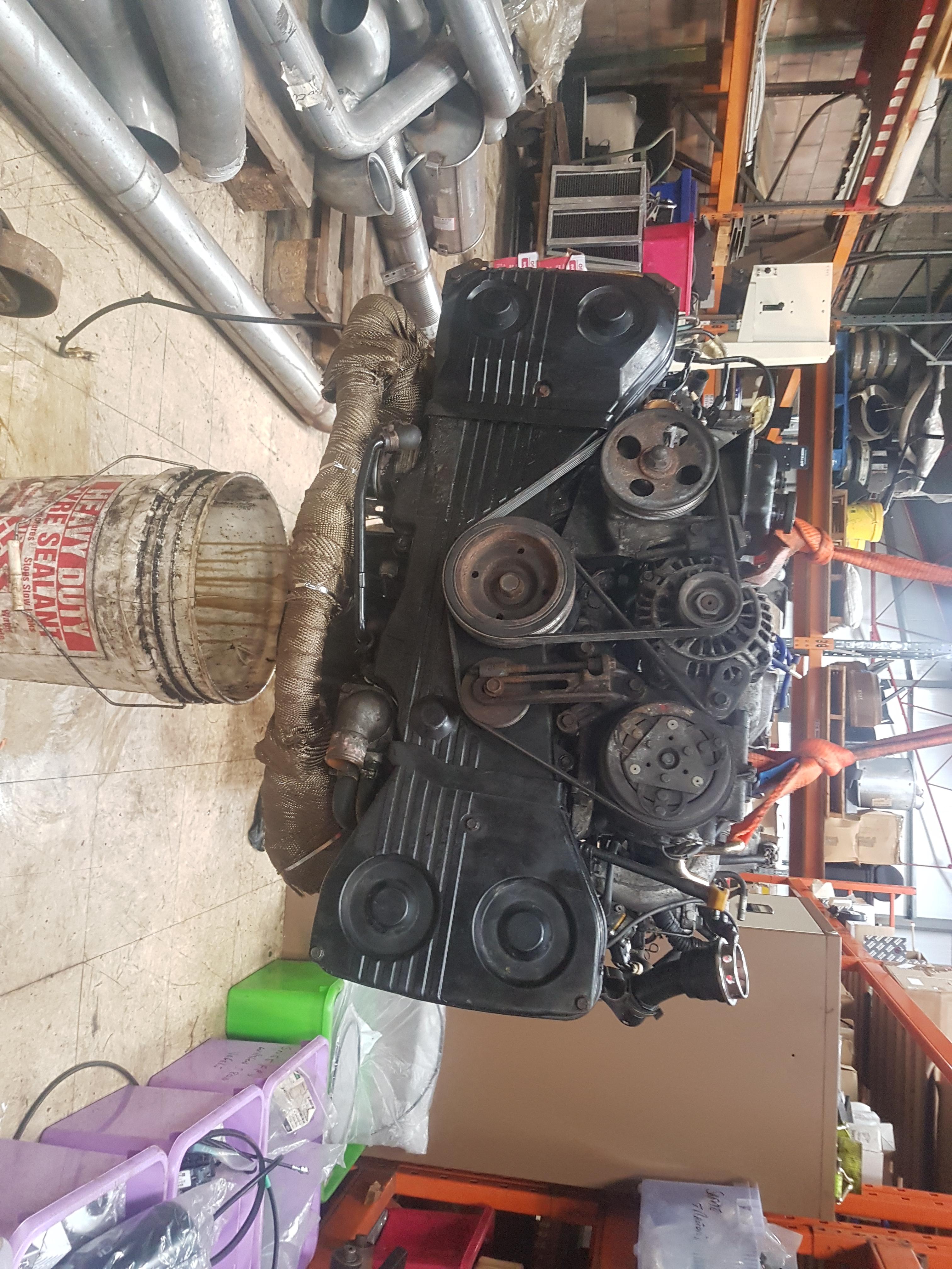

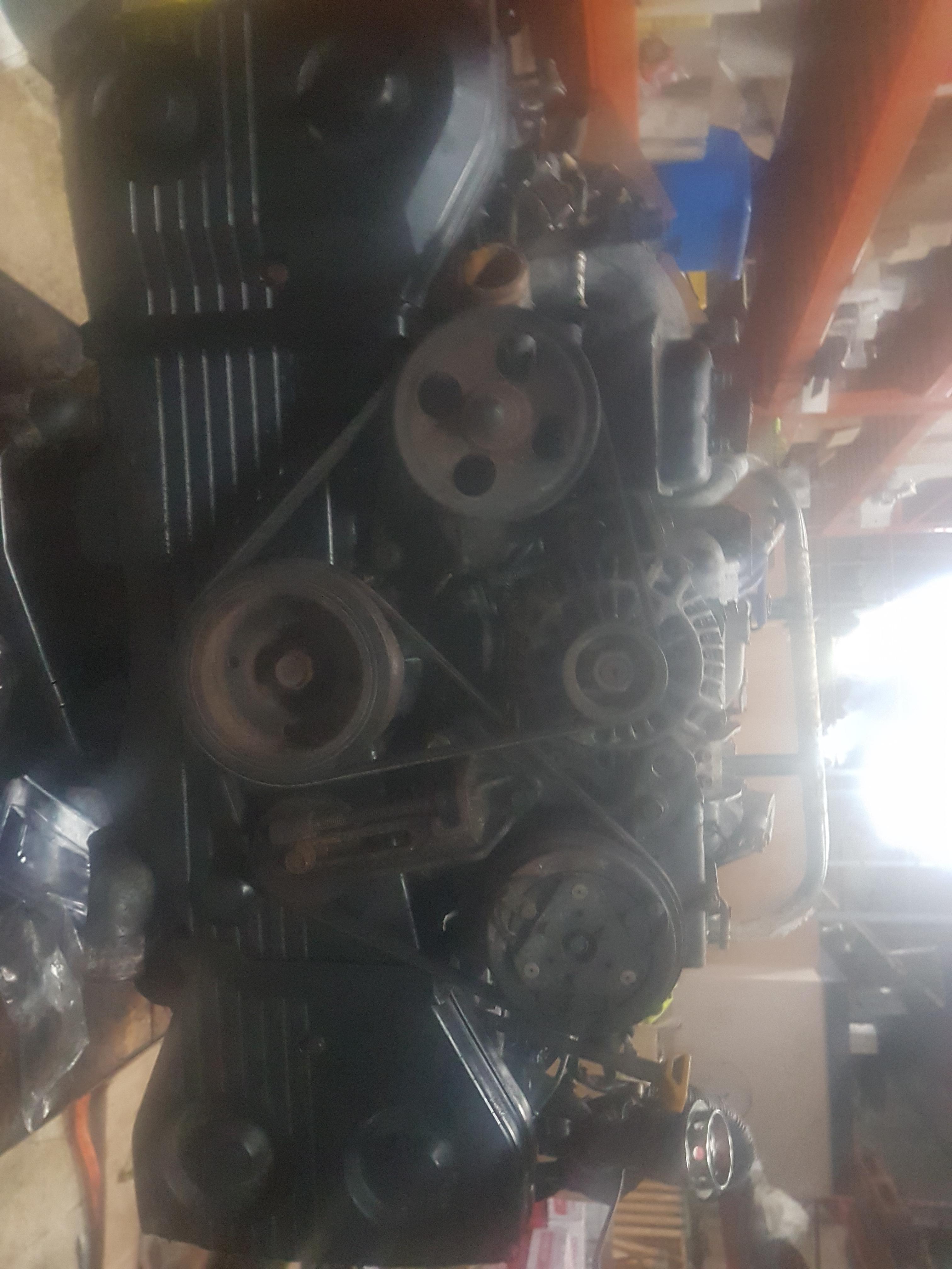

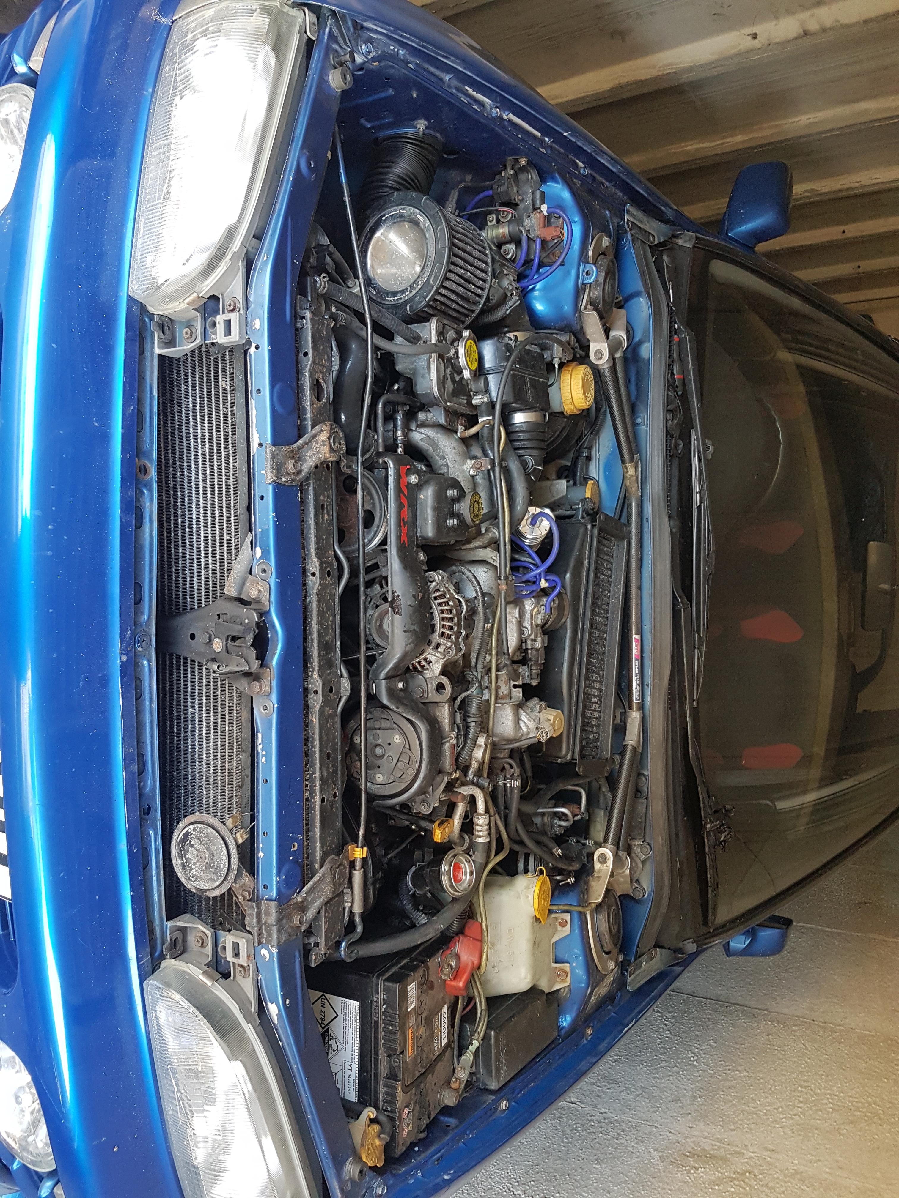

Thats the timing belt covers on now and the aux belts on and adjusted up also the turbo refitted
I'm getting there now just waiting on my coilpacks and heatwrap now then engine back in next week 👍

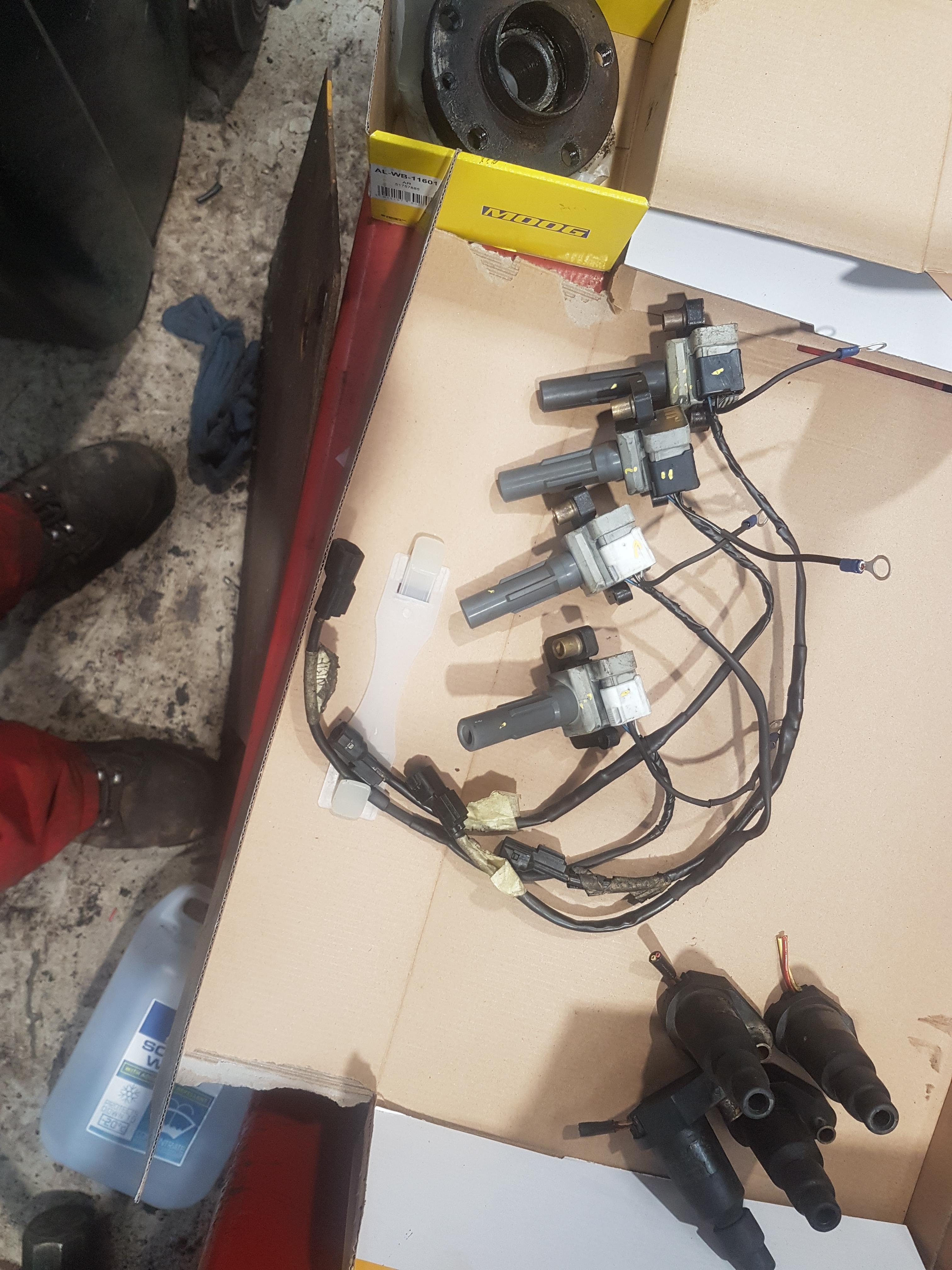

Here's a link to the newage coilpack conversion i used
.https://www.jamessimpson.co.uk/classic-impreza-new-age-coil-pack-conversion/
Only change i did was too connect the earths higher up on the inlet manifold, To lessen the chance of them getting corrosion from moisture off the ground
Thanks buddy 😉 feels like i'm actually getting somewhere with it now, yeah i've already looked on that site and bookmarked it as it was the first one that came up on ye olde googlie search, i think I'll follow you're lead and put the earth higher up as you say 👍

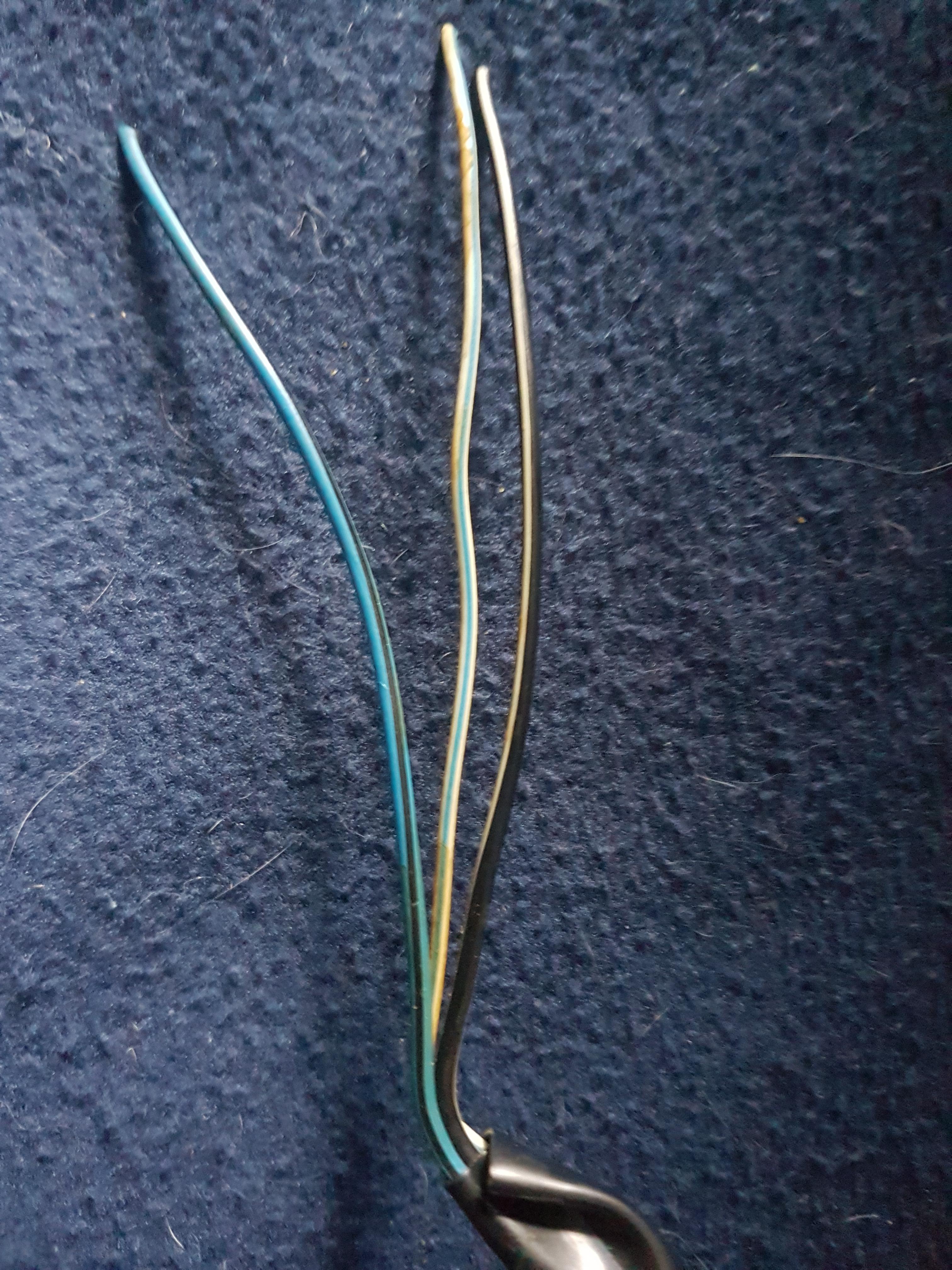

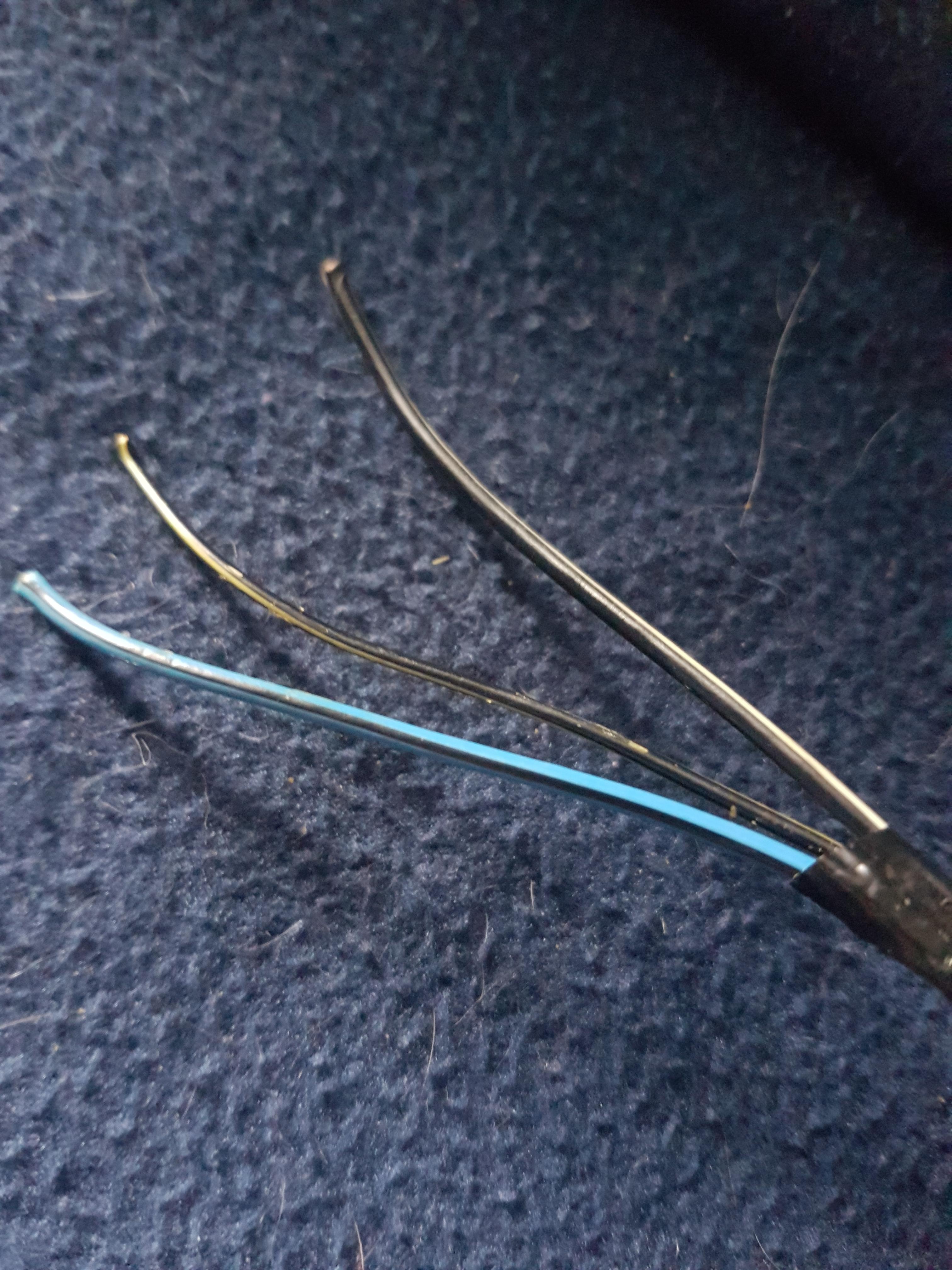

My newage coils turned up today and looking at the wiring they don't match up with the wire colours that are on the james simpson website that shows how to wire them in, just wondering if anyone can shine any light on how to wire these ones in, heres the pics of the wire set up on the ones i have
20180413_155555.thumb.jpg.a42d88926e77bfa9e26a3b342fb2db6a.jpg20180413_155701.thumb.jpg.8afb7d120710fdc554fad7712b6de57c.jpg
now i think the black with white tracer is the earth and the blue with black tracer is the 12v live and the middle wire on both pics is the signal wire, any help would be much appreciated 👍👍
From what i've read so far i've got newage sti coilpacks as they are grey whereas newage wrx coilpacks are black, now the ones in the sellers picture on the bay were black so thats what i thought i would get, so are the wire colours from an newage sti different from the wire colours on a newage wrx
Black with white stripe was definitely common earth , ive only got 1 pic on my phone and im going out for a few beers ,so you wont get any usefull info outta me later lol .

Ok so continuing with these coil pack wires i'm pretty sure the black/white (earth as savage said) and the blue/black ( 12v live ) coz they are thicker than the 3rd wire which is quite thin so in my mind the thinner wire will be the signal wire, does anyone think i'm right with that? 👍
Coil packs now wired into the classic side i just went with what i thought was the right way so hopefully it'l start when i get the engine in 🤞, if not I'll just blame all the guys in the workshop who agreed with me that it was correct 😂

Got the coil packs fitted tonight after repairing the windscreen on one of the boys at work daughters car so just the headers and new engine mounts to fit some fresh oil and filter, then finish work at lunch time on friday and get it fitted 👍

Its finished 👍😁, got the bonnet and other bits and bobs on today and gave it a little test down the street and back and everything seems ok
Booked in for mot on Tuesday, then its a wait to get mapped, one of the lads at work is going to take me with the car on a trailer as dont want to drive it until the injectors and other mods have been mapped in
