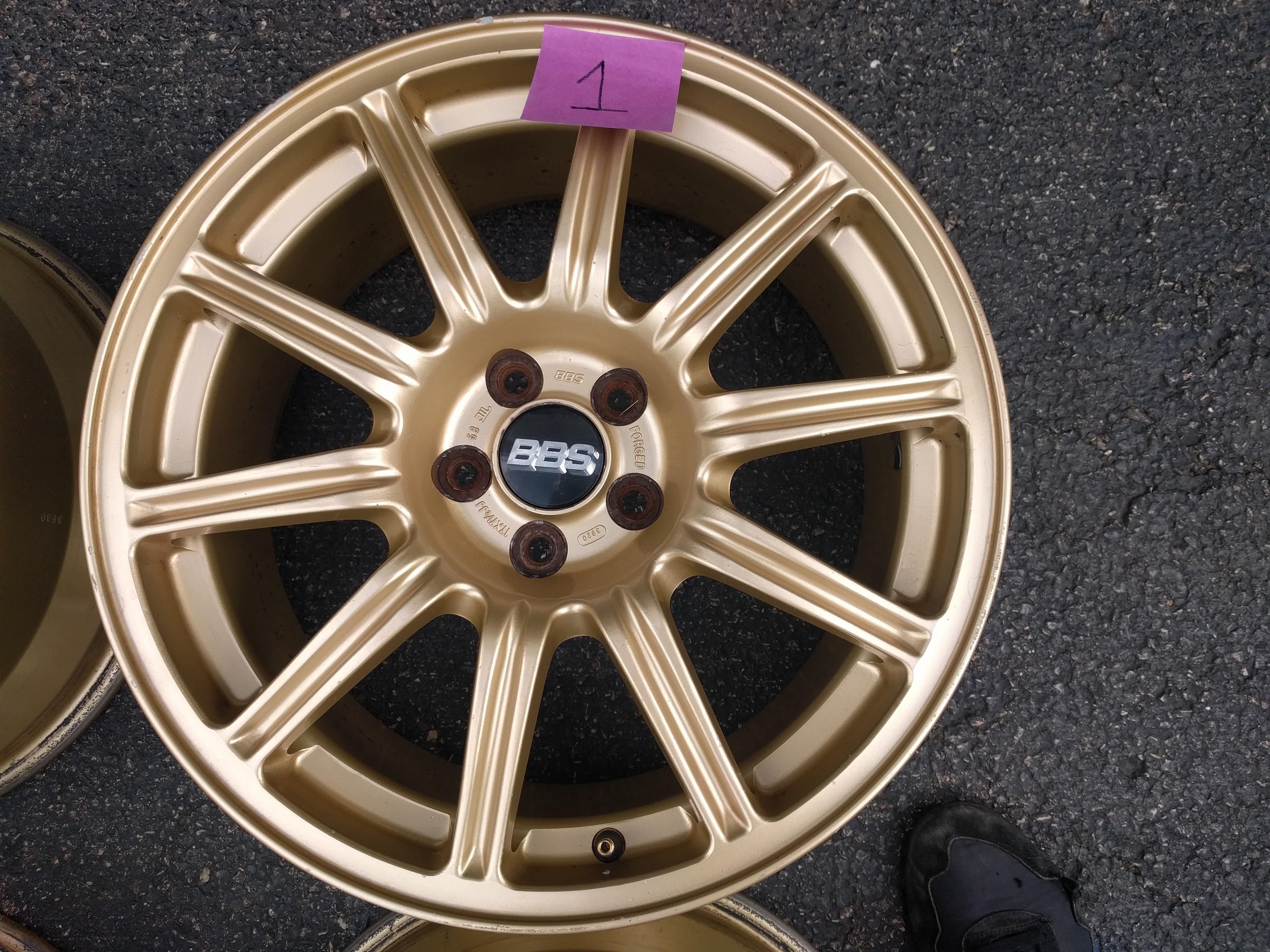

have done some more research and think I have settled on looking for a set of 5x100 BBS wheels that I think came standard on the spec c
anyone know where I can find a set of these. Picture to follow!

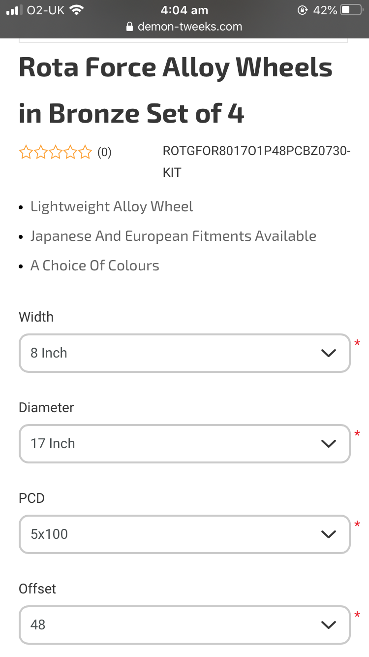

Am considering the attached. Is anyone able to advise on wheels specs I have selected as to whether they would be correct fitment for Brembos and the best width to fill the arches without arch mods.
thank you!
