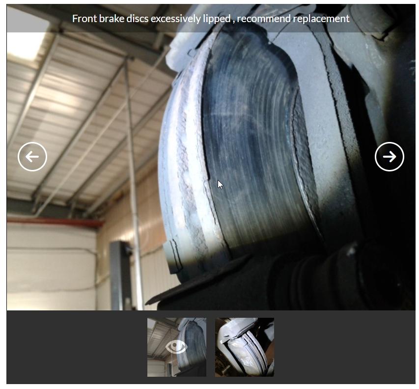

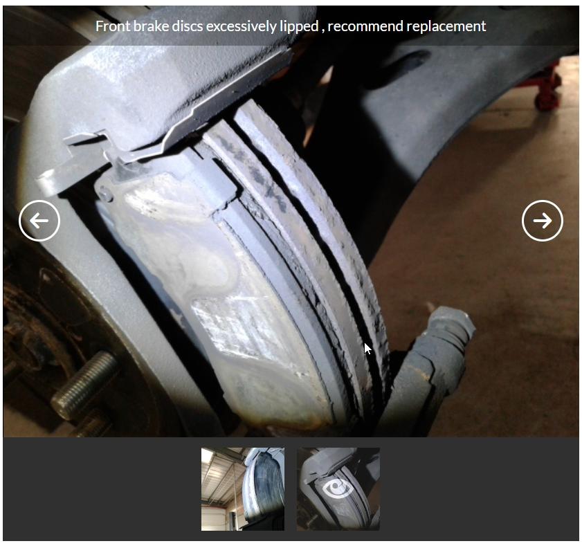

Not really, they said its from 'Front brake discs being lipped' but I had this issue 3 months after purchasing car; where issue would take 12 hours to reoccur, it now only takes 5 minutes.
I had asked, so would this not be covered by warranty since a few hundred miles had only went on the clock? No, wear and tear.
When issue got worse and only occured after the car had been standing overnight - Subaru had the car for two days and issue was not found and no issue reported for the brakes.
Now, they did say my alignment was out, so got that fixed and the grinding noise at 7mph has actually reduced by half.

In your opinion, from the crappy video, I drive down a street for wee bit, so brakes/disk do a few full rotations and when accelerate upto 7/8mph, i get that noise - do you think it can be the brakes as Subaru states it is?
(listening to it youtube now, it does sound a drum/boink noise)
Based on your thread posts and that video I would say it is not the brakes, but without seeing the car I would not put money on it.  If it was the brakes it would not just be at 7mph, surely it would be either side of that by some MPH.
How many miles do you do? For a 2018/19 XV to have lipped the disks already seems a bit soon?
I have about 12k on it but this noise first started after 3 months of having the car. The car would have to sit over 24 hours to get the noise, so I thought it was just brakes rusted.

It's not the brakes. The lip on the discs is noticeable but no worse than on our cars (both around 25k miles) and there is no noise from them unless it has rained and the first brake application has to remove the surface rust.
