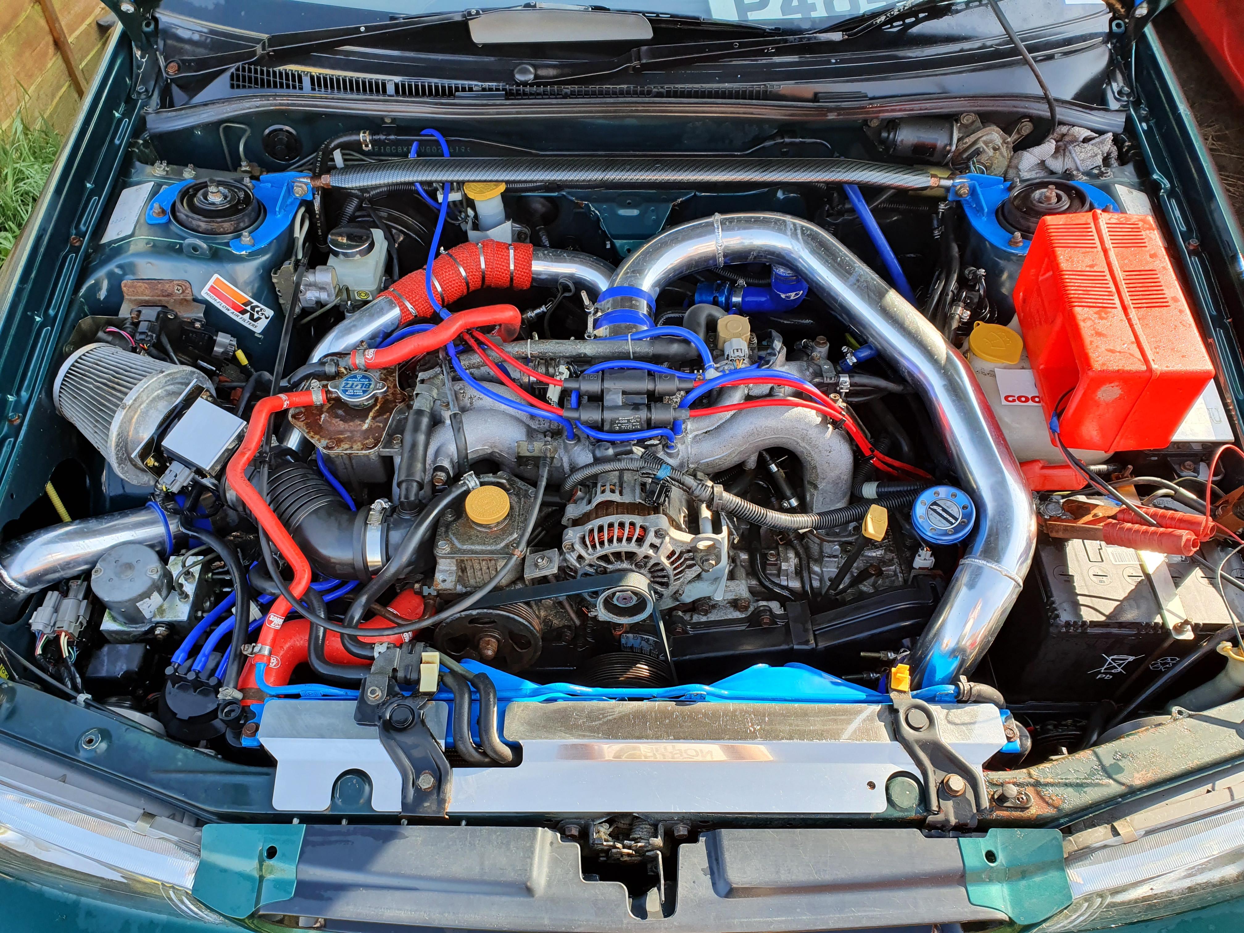

Hi there I own a 97 subaru impreza wrx. I inherited from my dad who passed. He always wanted to put a bigger turbo on it and get it mapped. So I'm going to do it. Just wondering what is a safe power to go to. I've heard people mention that gearboxes can go on them. It's decated. Got an intercooler, uprated cold air feed and walbro 255 pump. Im getting 550cc injectors and a bigger turbo. I was thinking hybrid my td04 or getting a 20g td05. If anyone else has other turbo ideas I'm happy to hear them. Just dont want to be spending a £1000 just on a turbo lol. Not that rich. Just looking for general advice on safe bph and things I should be checking out for when doing these upgrades. Thank you in advance.

I'm unsure what turbo the 97 wrx has as standard ,a google would tell you but the car has already been modified , so you'd probably be better off looking for identification Mark's on the compressor housing (silver bit of the turbo) .
The smallest turbo fitted to imprezas is the tdo4 which will make 265 to 290hp .
If it has grey injectors they'll be 380cc ,which max at 290 hp ish .
If it has yellow injectors they'll be 440cc and they max at 350hp ish .
Having a front mount intercooler,  the car should already be mapped (ideally) due to the changes in airflow and fuelling.  Do you know if it's been mapped already and if so how ?
Does it have a boost gauge and if so what does it read ?

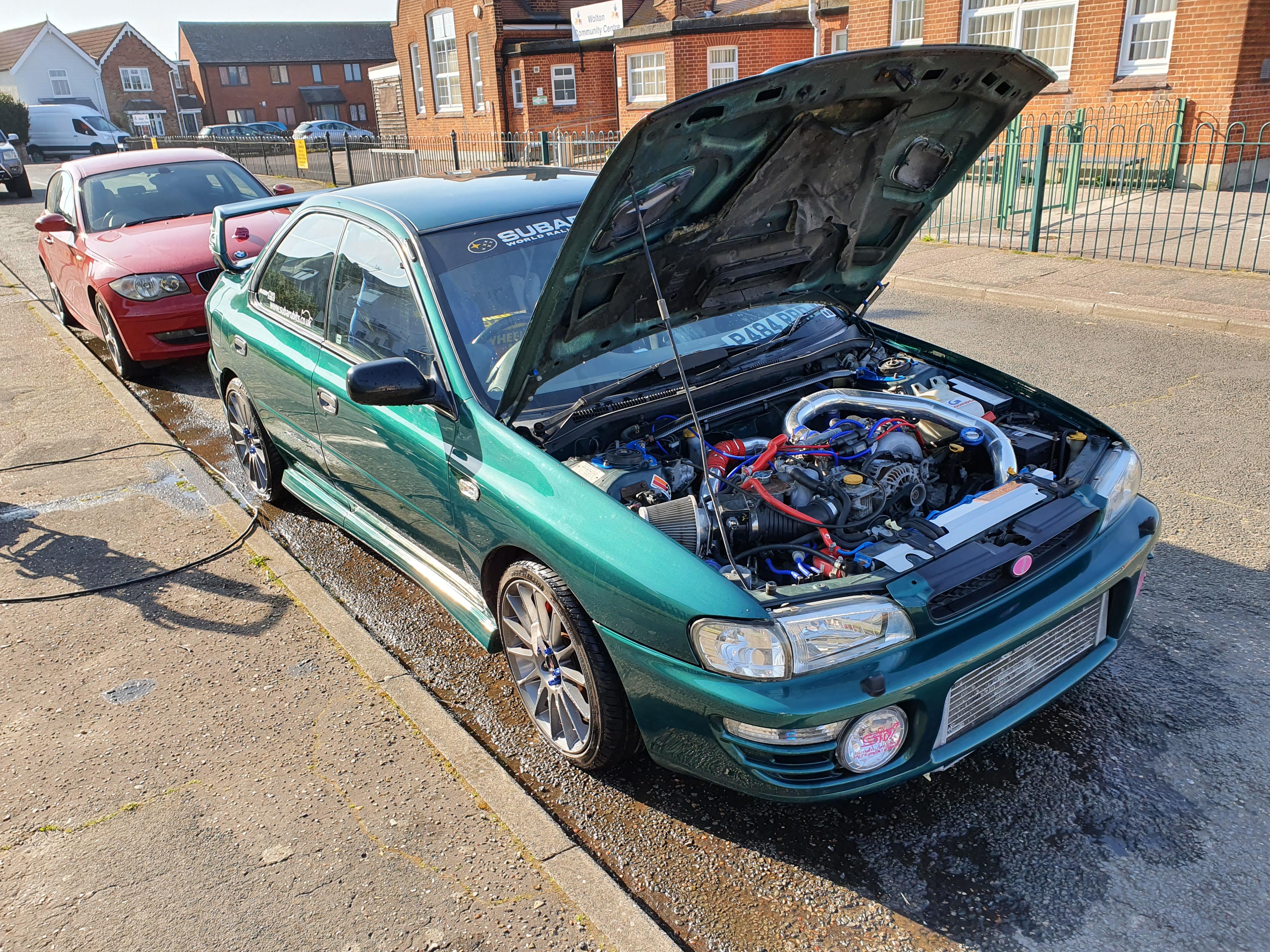

Looking at the few pics you've put up its definitely a v3/v4 uk , engine and ECU wise they're the same . If it has white dials and facelift interior it's a v4 ,if it has preface black dials and interior it's a v3 .
