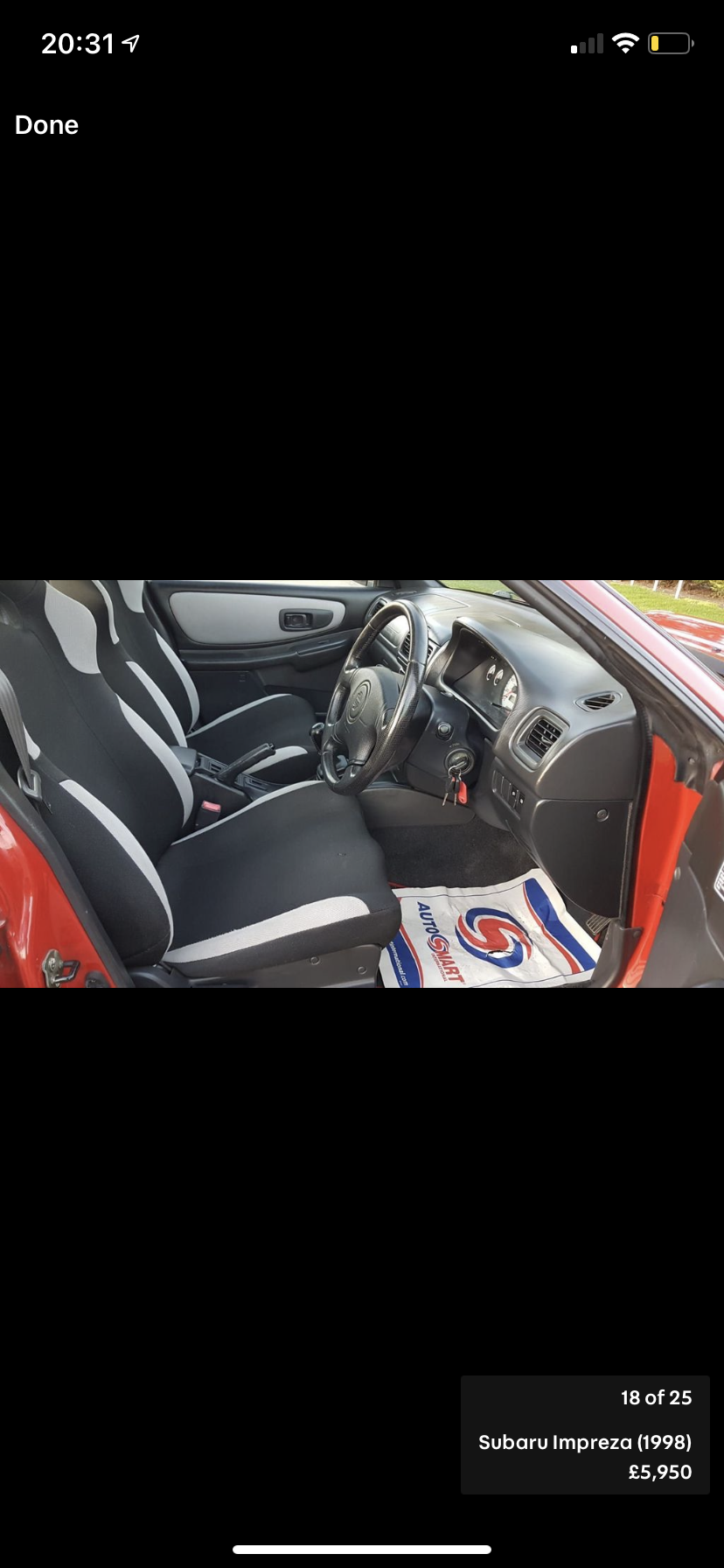

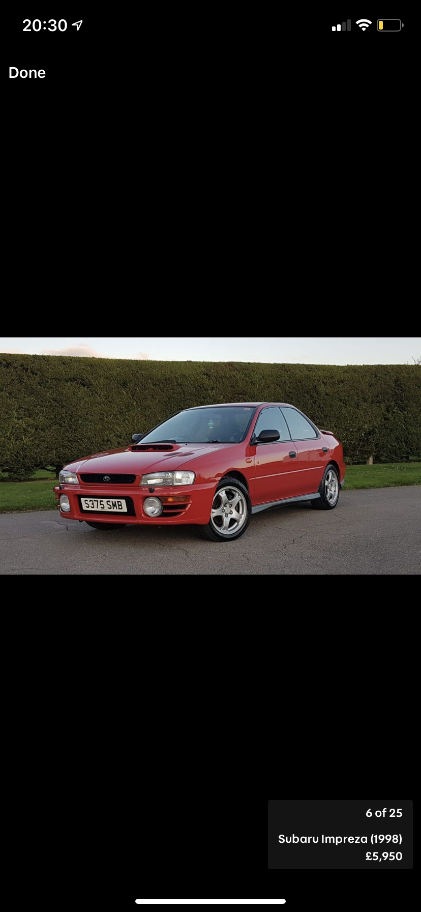

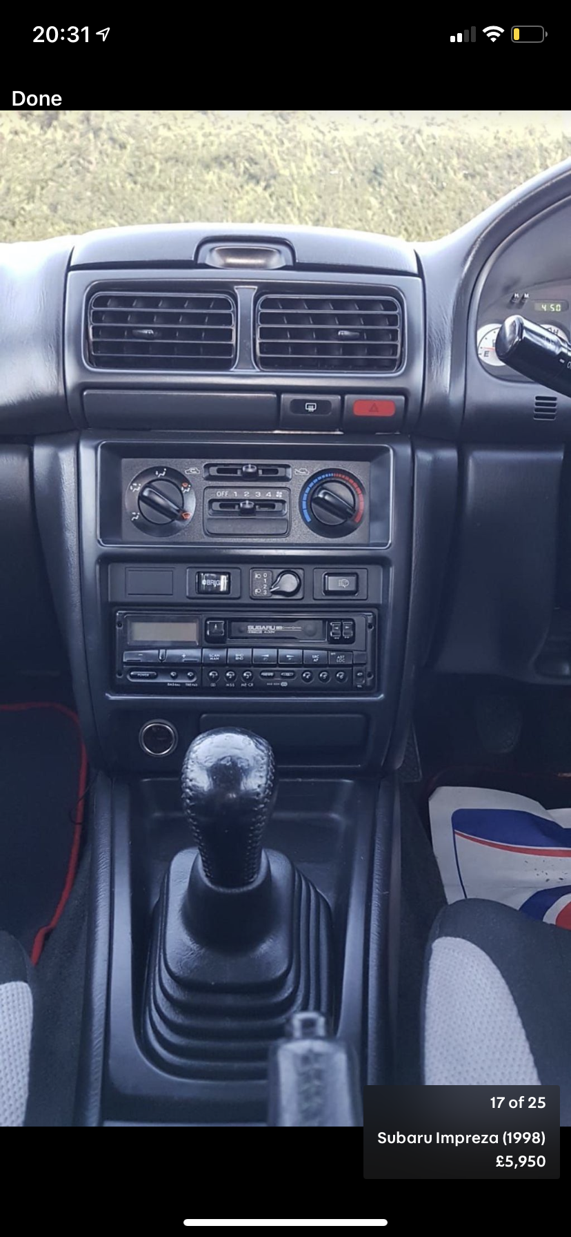

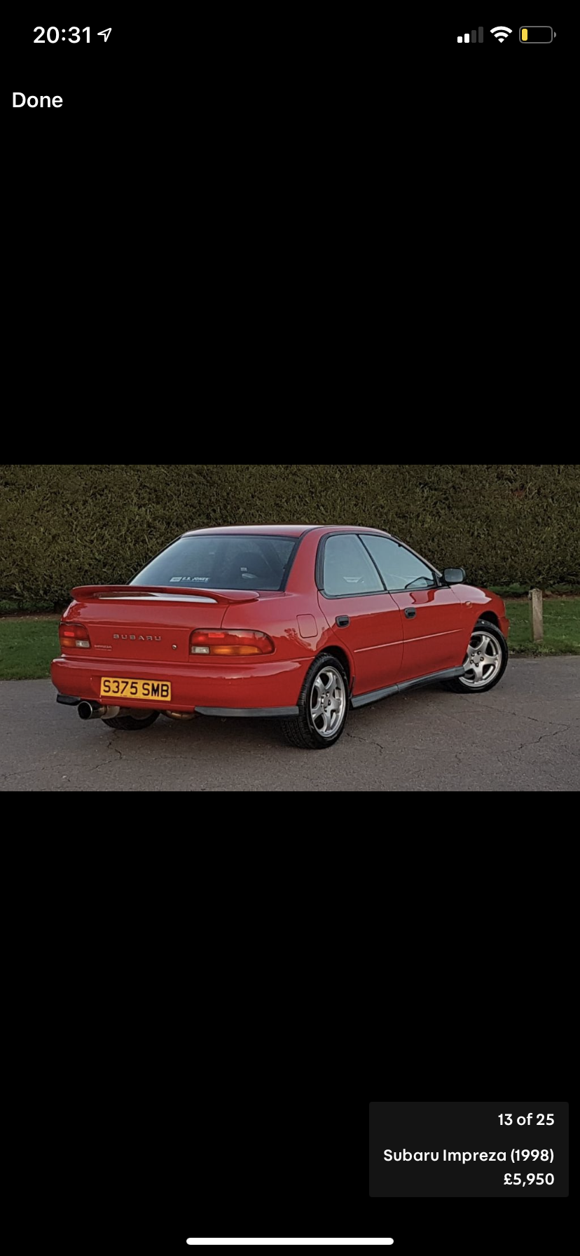

This is the car I’ve put a deposit down on and having checked over.  Still waiting for the full list of what needs doing but no one has told me it’s a terrible idea so if nothing horrible comes up I’m going to do it.
I can’t link to the ad for some reason so forgive the screen grabs.
Owned by an elderly chap who now unfortunately has gone into care.  60k miles on the clock, 100% original I believe.

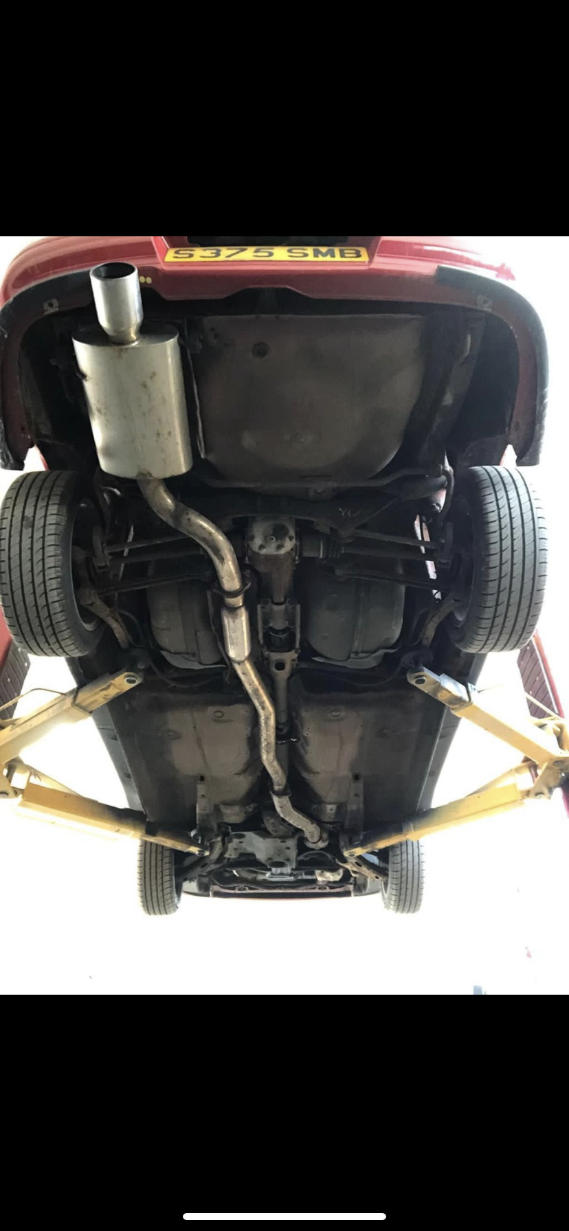

It looks like a clean example to start with , mind you you don't know what is lurking under that underseal .
For reference it's a version 4 uk turbo , as Subaru years and versions can be a little confusing at the best of times .

It is pretty clean and straight from what I’ve been told.  This is a rough idea of what will be getting done, idea being this will sort it out for the next decade (hopefully, it won’t have a hard life):
Remove parking dents
Engine out, clean engine bay
Replace rear main seal, cam seals, gearbox seals, front oil pump seal and side shaft seals
Remove rust on underside
Power coat and sand blast front and rear subframes
Clean and re-furbish differential
Waxoyl under body
Replace timing belt kit
Fix engine misfire..Plugs or leads hopefully
Replace all oils and fluids
Zinc coat under body bolts
New under body bushes

That's a good list. But I'd add a couple of things:
Oil separator plate, next to the rear main seal. They can leak copiously. There's updated ones available, it's a known issue of EJ20s of that era.
It's probably been looked at already, but strip out the boot, and thoroughly inspect the inner rear wings, particularly where they meet the rear wing outers. This is where the wheel arch rot starts, tired rear light seals can let water in and it stews in the voids. And the rear strut towers of course. Your garage of choice knows their way around these cars better than most, so you should be ok.
