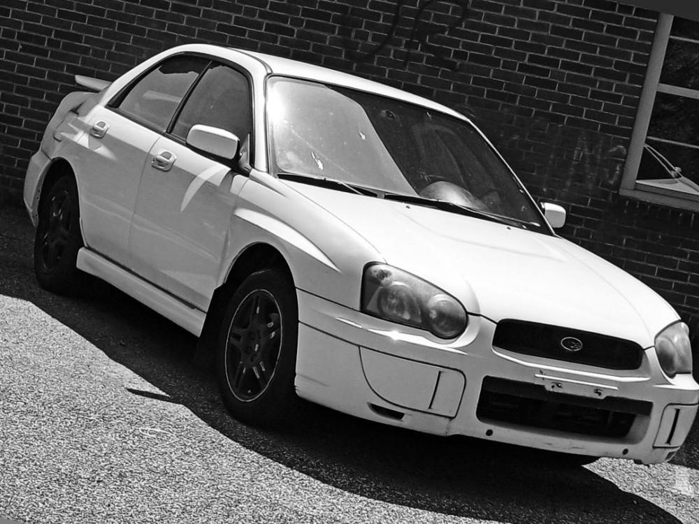

I am new here and I own a 2005 Impreza 2.5RS Sport. 128k miles. Unfortunately the car is an automatic.
I want to get an 05 sti front clip w/ motor, trans, and subframe.
