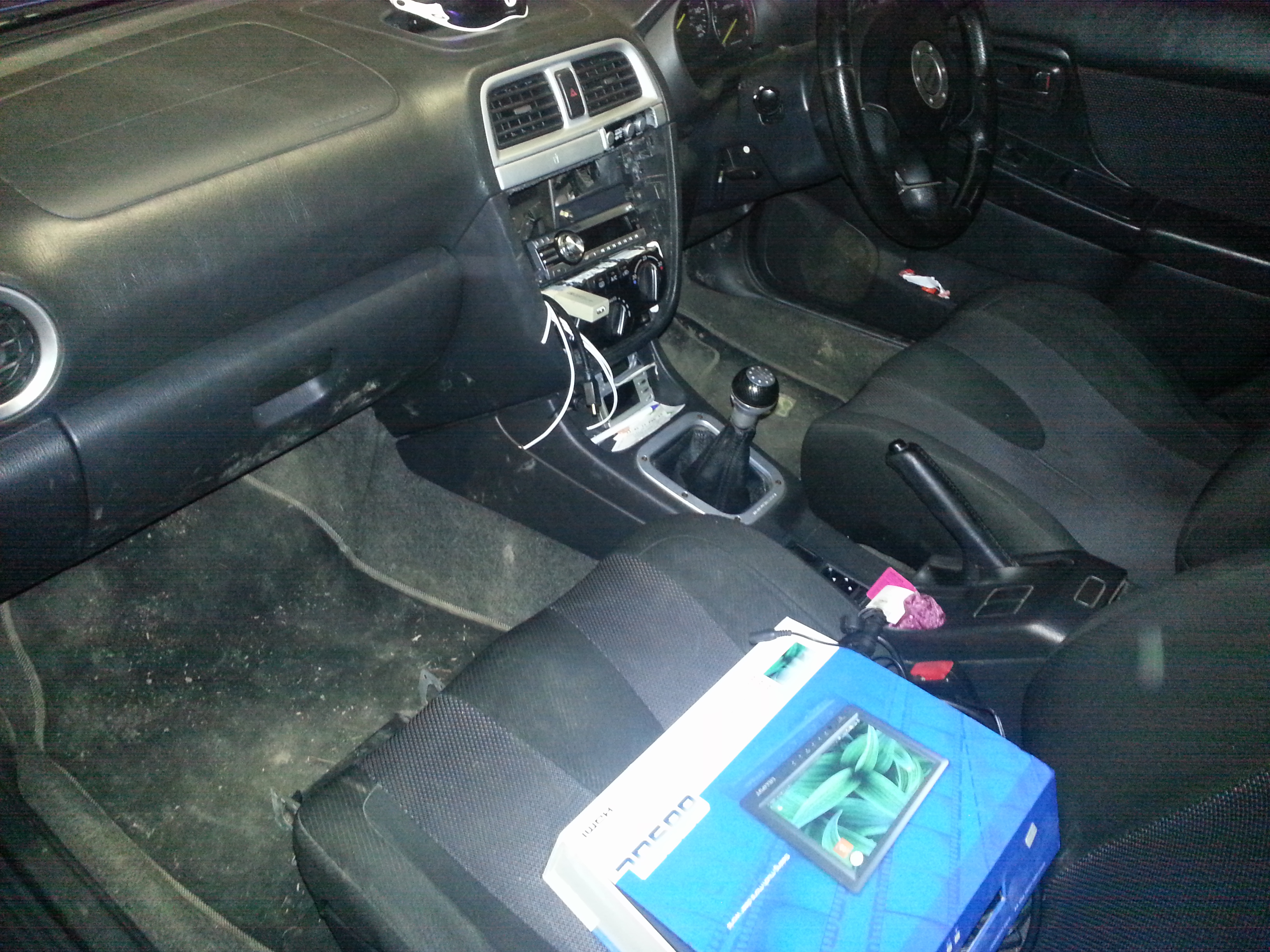

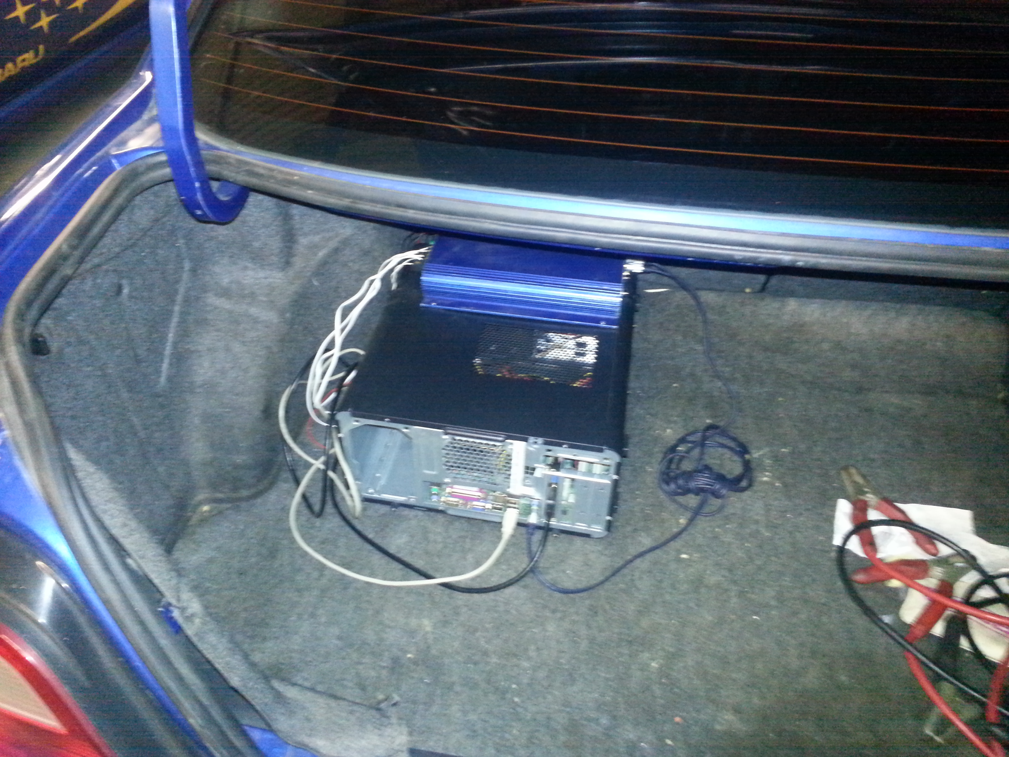

We've just changed ours so haven't got a pic of the interior yet but my very clever other half has done me a full boot build or at least the start of it, complete with flat eric LMAO !. (We have yet to add 2 6x9's)
So to date, we have upgraded all the speakers, added 2 x 12' subs, 2 x amps, and have just put an alpine ida media player in. (We did have a pioneer double din unit (PH80BT) in so have got that for sale if anyone is interested ;) )

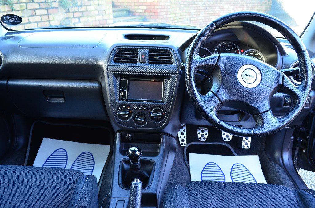

Currently have a Pioneer Double Din head unit, bit old but still good
and then a flat Pioneer bass in the back. as my 2600W 2x12" Active bass box will take up too much space :(
Still need to get round to swapping all stock speakers for my new bass face ones and i need to install my 4ch Amp  :)

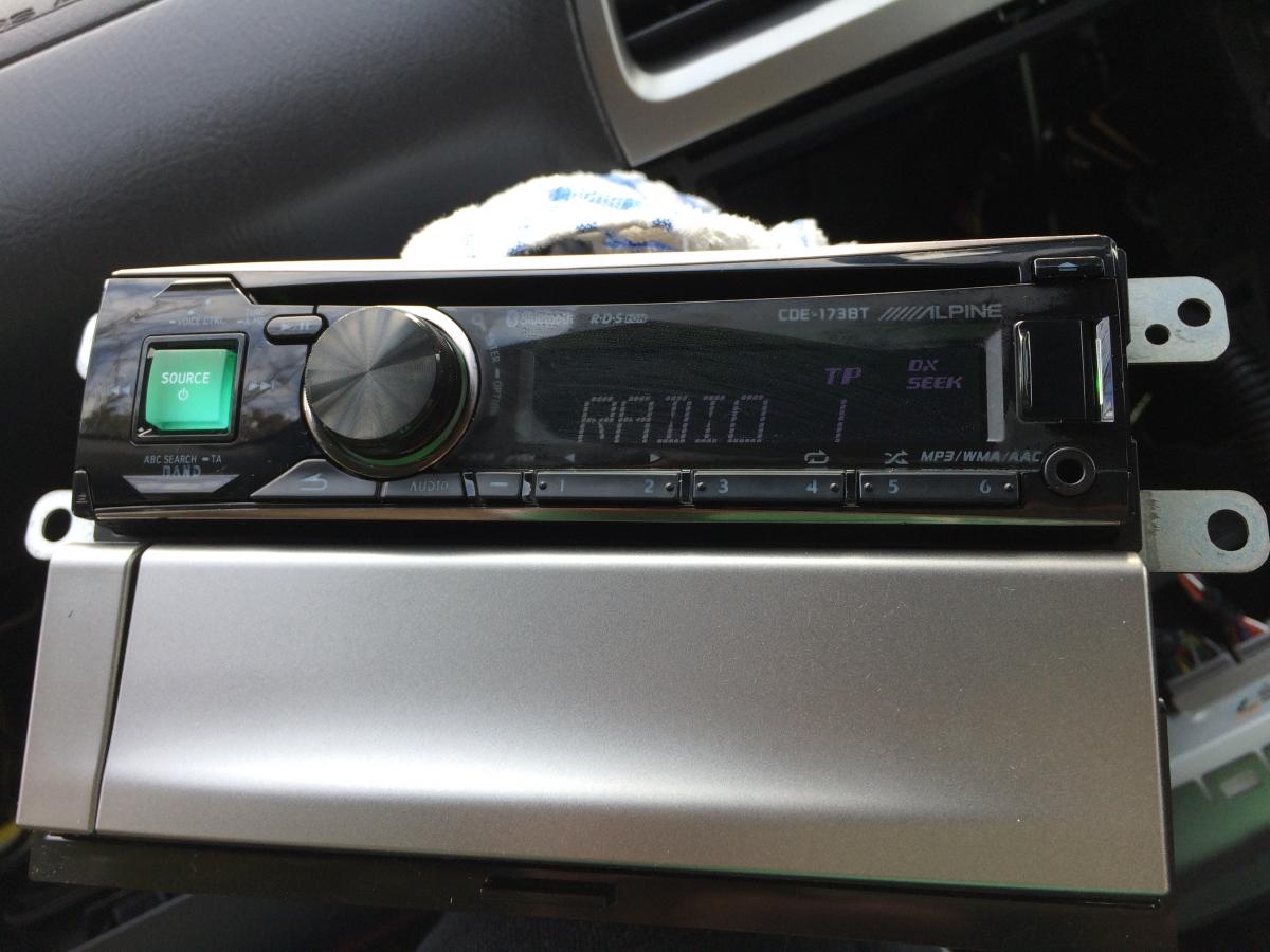

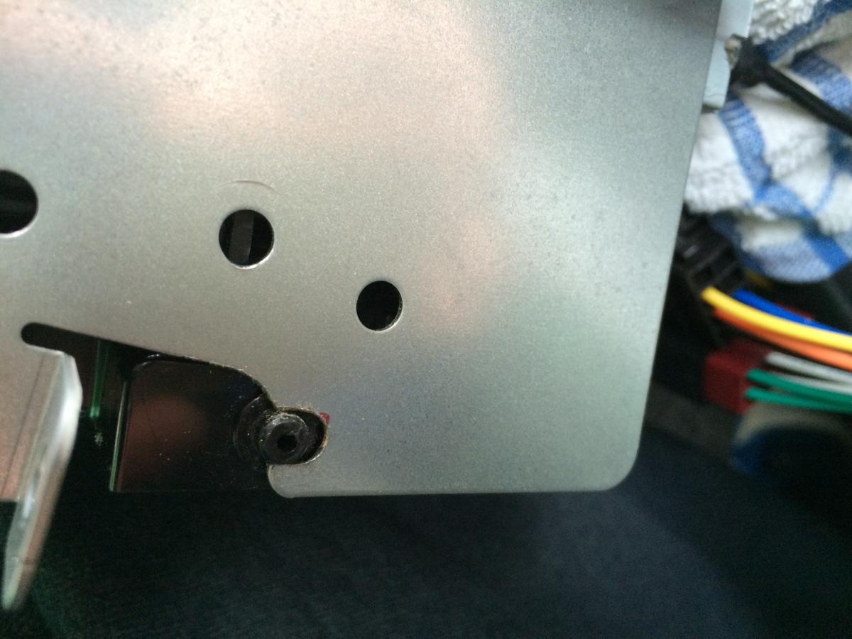

I just added a single din alpine unit to my car with a pocket underneath. I followed a youtube guide to removal of the old double din unit then fitted this one. All straight forward enough even for me, and I also cut some lugs on the frame so the pocket slotted in. Door speakers next when I have a chance. :) post-2871-0-34271200-1424455306_thumb.jppost-2871-0-92186600-1424455369_thumb.jp
